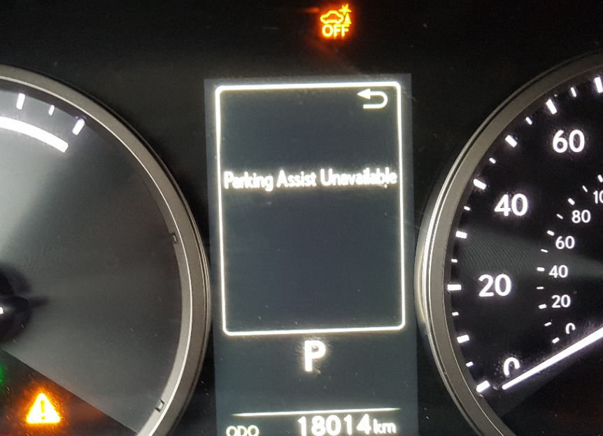

After assembly headlamps, DRL's, Radar in one piece all windows suddenly started to work! Do not ask me why
Now I have one message - "Parking assist unavailable" but it probably jut information saying that parking sensors are blind for some reason. On this forum I found that it should disappear after some drive (Car is not registered so no one trip yet done).
https://www.clublexus.com/forums/es-...available.html
Still I have glowing that yellow rectangle with exclamation sign. Need to scan for errors this weekend.
