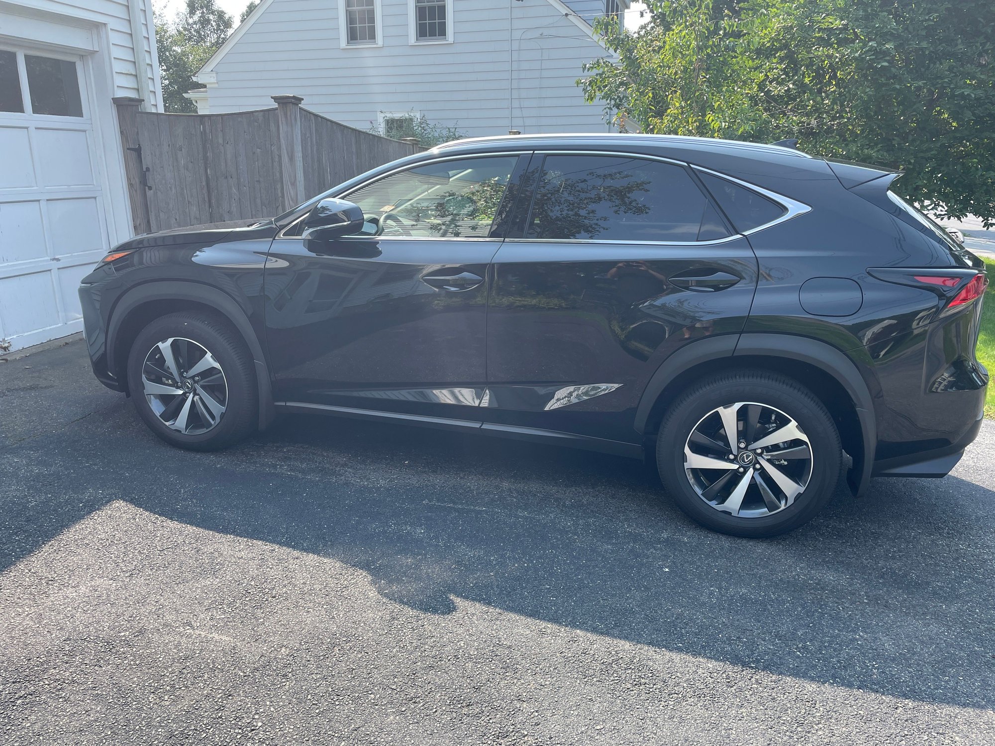

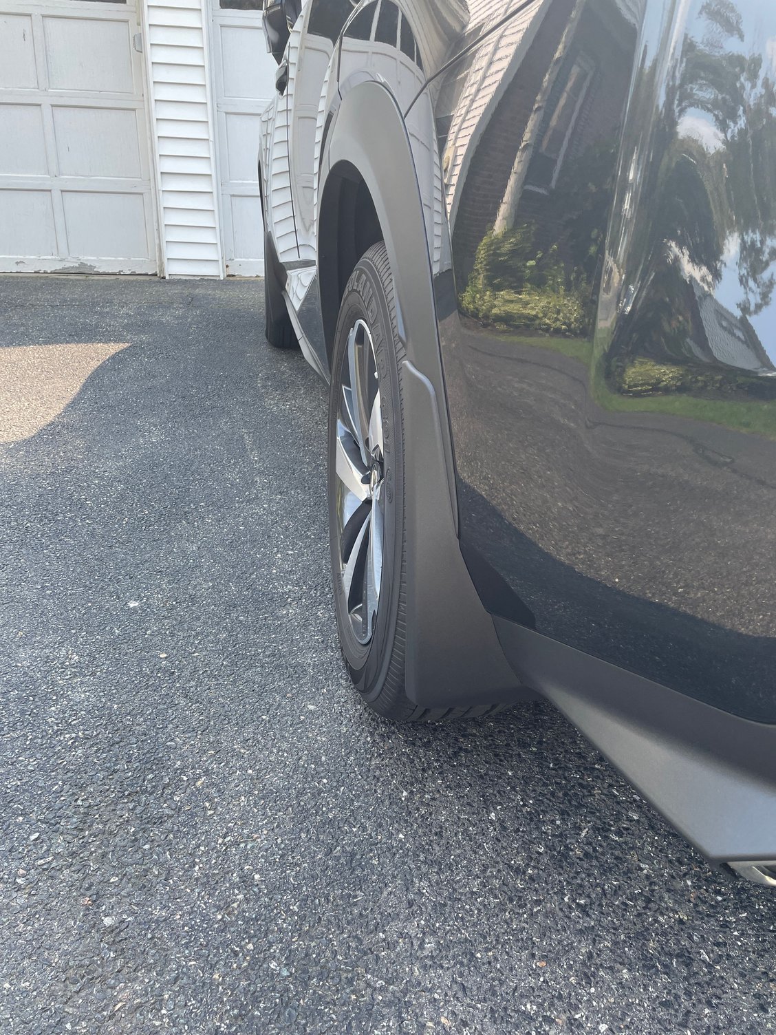

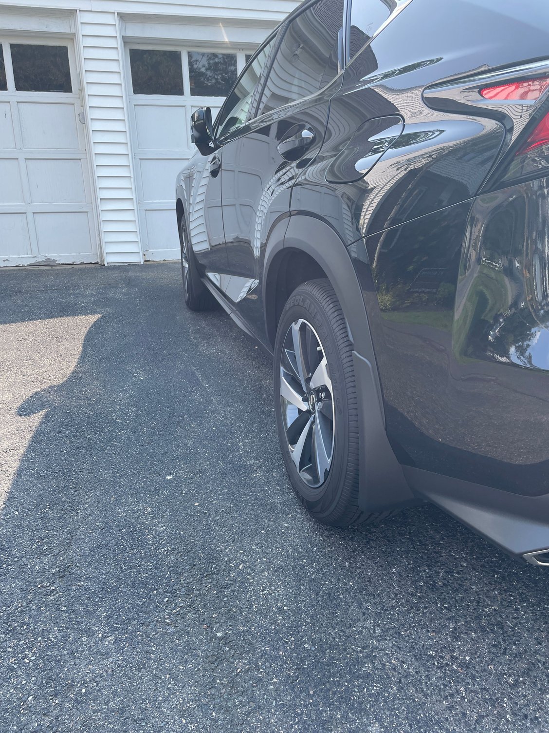

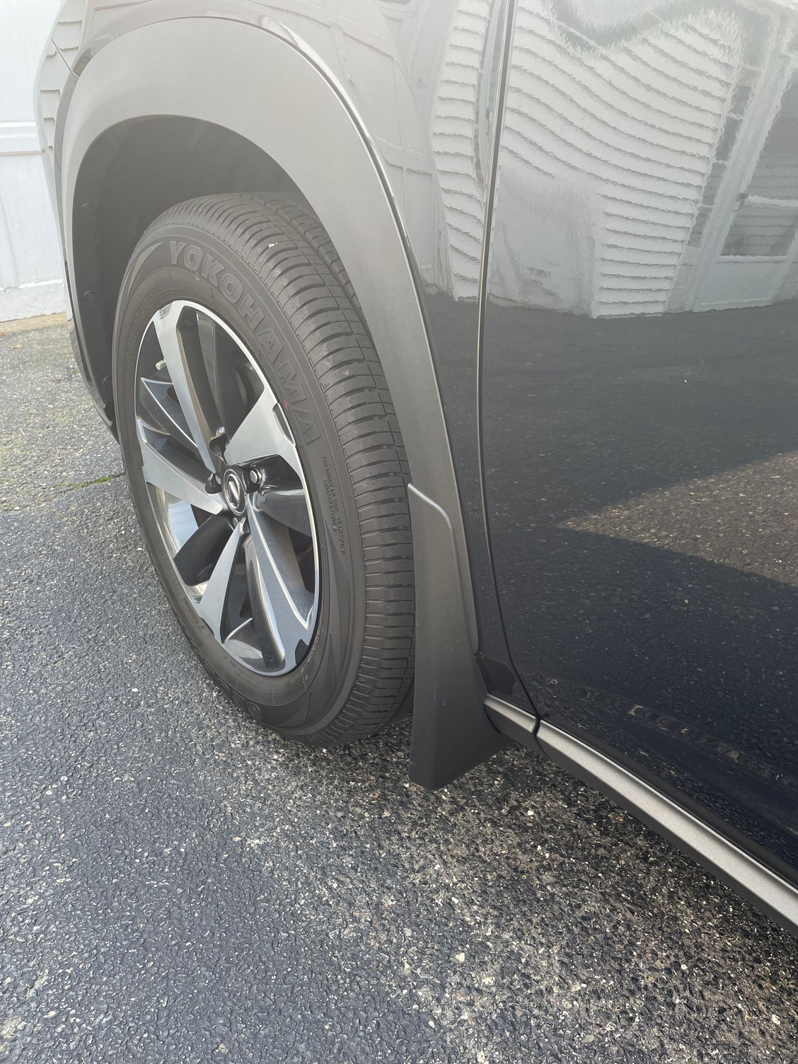

Here are a few photos of the mudguard installation on my new 2021 NX300. It was a fairly simple procedure thanks to the instructions posted here by gompka. I did not lift the car or remove the wheels. The fronts went on easily. Small hiccup on the rear when I wasn’t sure how to drill out the tiny dimple in the existing plastic moulding without removing the wheel, until I realized I could first remove the old pop clips (which are discarded anyway) and existing screw, and then bend the moulding outward just enough to drill into the dimple. You’re only drilling through a 1/8 inch thick piece of plastic, to create a hole that is immediately covered by a panel clip. Easy peasy. The guards install with new pop clips, existing screws, and new panel clips/screw pairs. I also included a close up photo of the clear plastic film installed to protect the paint. Not a great photo. Im not sure how helpful this film will be in this use (it’s the same kind of film you can have installed on the front of car hoods to protect from road debris; I think it’s used to protect military aircraft too. Just seems silly in this application
Overall an easy install. Glad I added these to protect my paint against road salt and sand spray during the harsh Boston winters.
