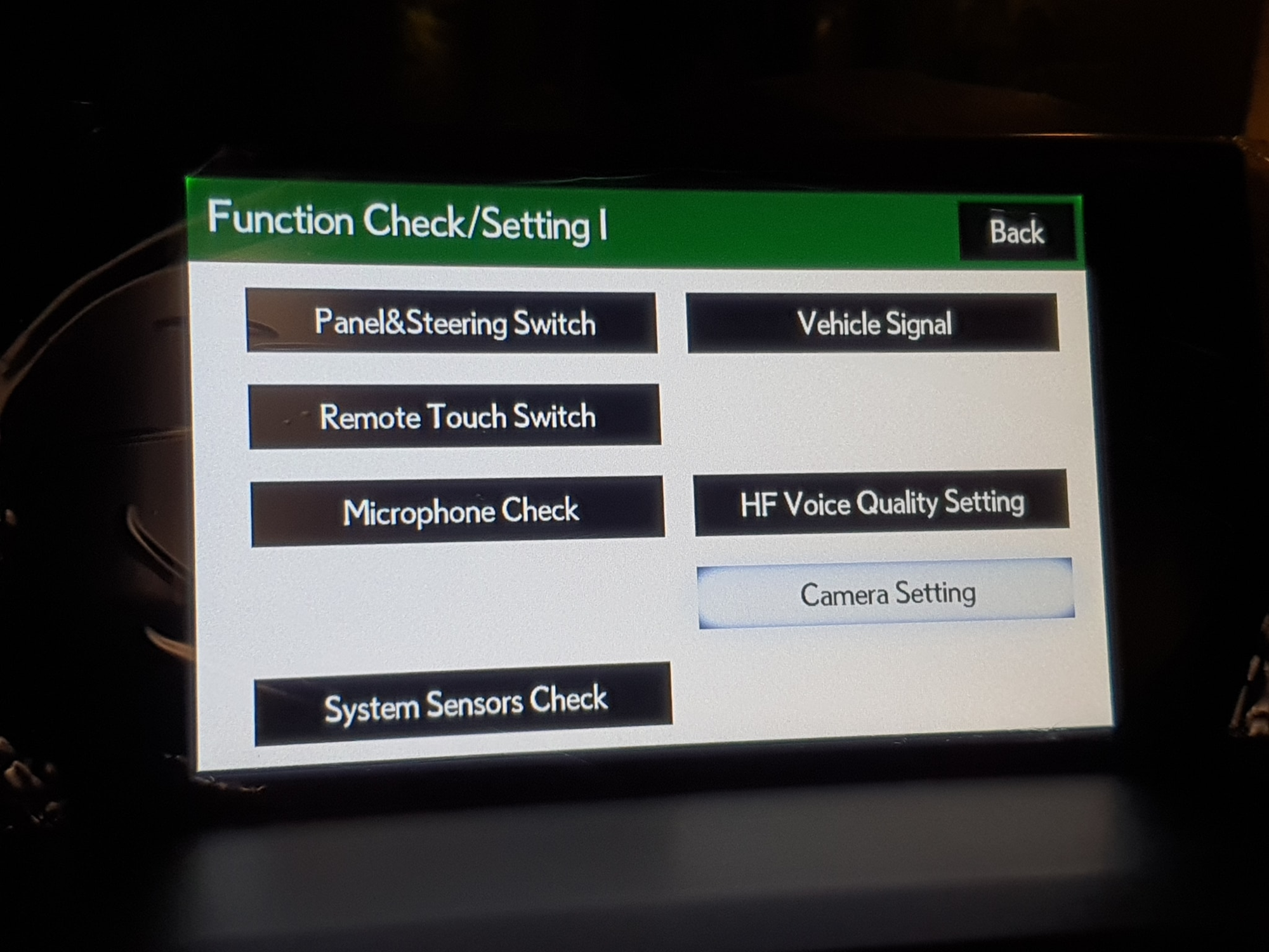

One time, I screwed the trajectory lines up by not allowing it to do a full learn procedure after the battery went flat for some time. In case something similar happens to you, you can access the "secret" menu to fix it by starting the car and turning the lights on and off 3x while holding the menu button down.
Mine is a Japan domestic model. I can't find service menu. There are a few settings in Japanese language but it looks like other menus for gas stations, things like that. I am from Yangon, Myanmar.
