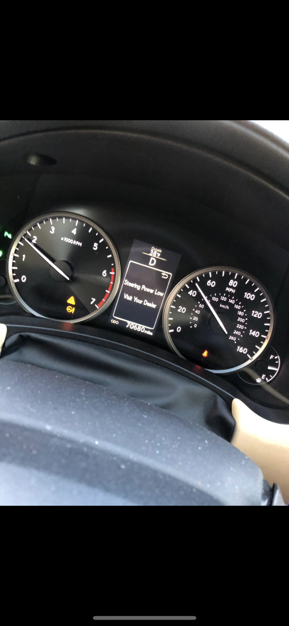

Hello,
I just received a "Steering Power Low" warning on my 2015 Lexus NX 200t. Has anyone ever experienced this?

Did this fault post on engine start or right after?
If yes, then my first suspect would be a weak battery, as it would indicate to me that the power steering computer may not be receiving sufficient battery voltage during start.

It's right after. One message says battery charging malfunction and the next says "Engine stopped steering power low". Now the engine is struggling to start and when it started the engine stopped and the same message come up

With that in mind you know the power steering issue is just a symptom of the real problem, which is likely either your battery or alternator (or both).
Have them both checked out at a local auto parts store. If your battery is over 3 or 4 years old, you might consider replacing it anyway.

Needs new battery.
