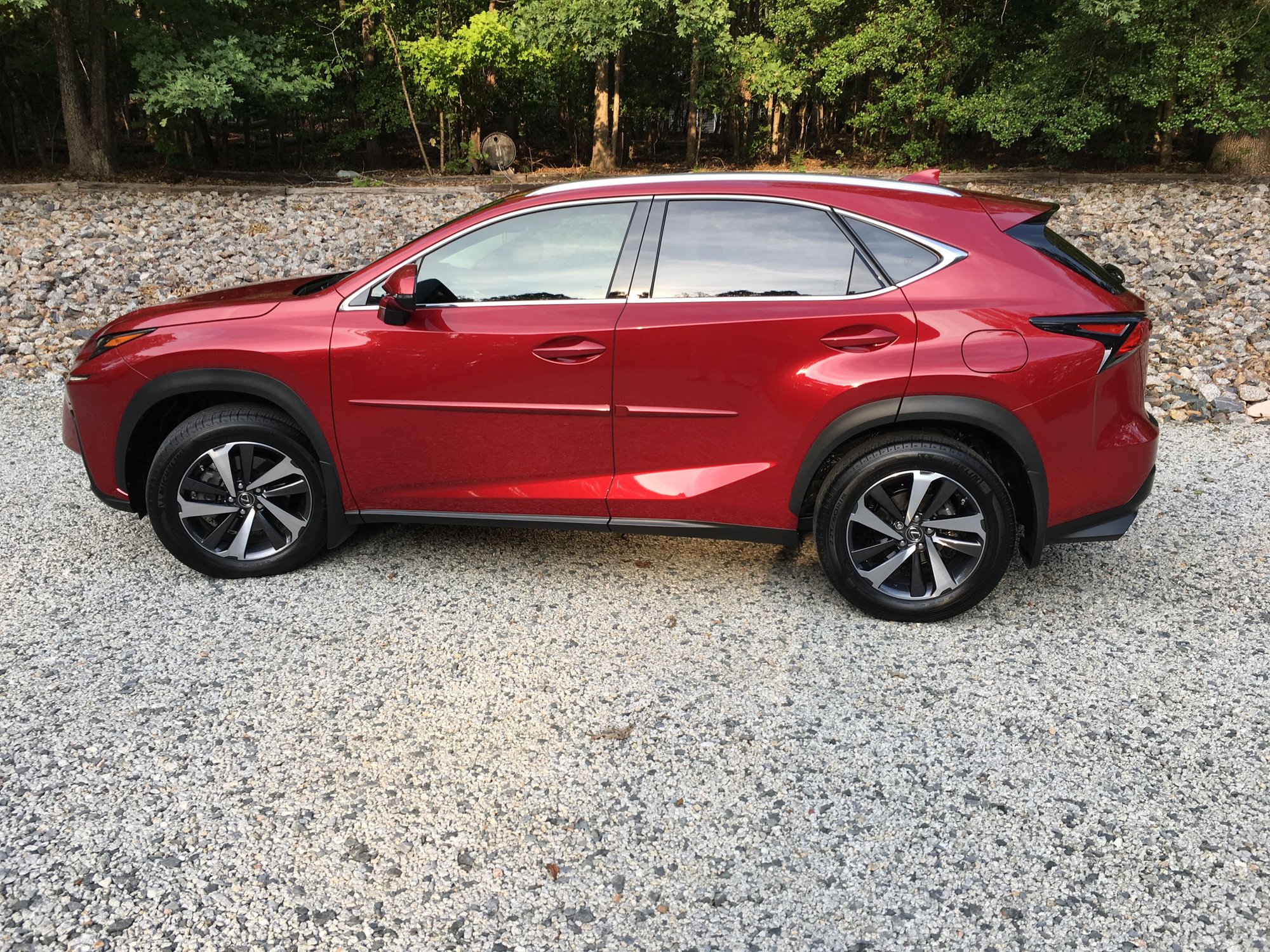

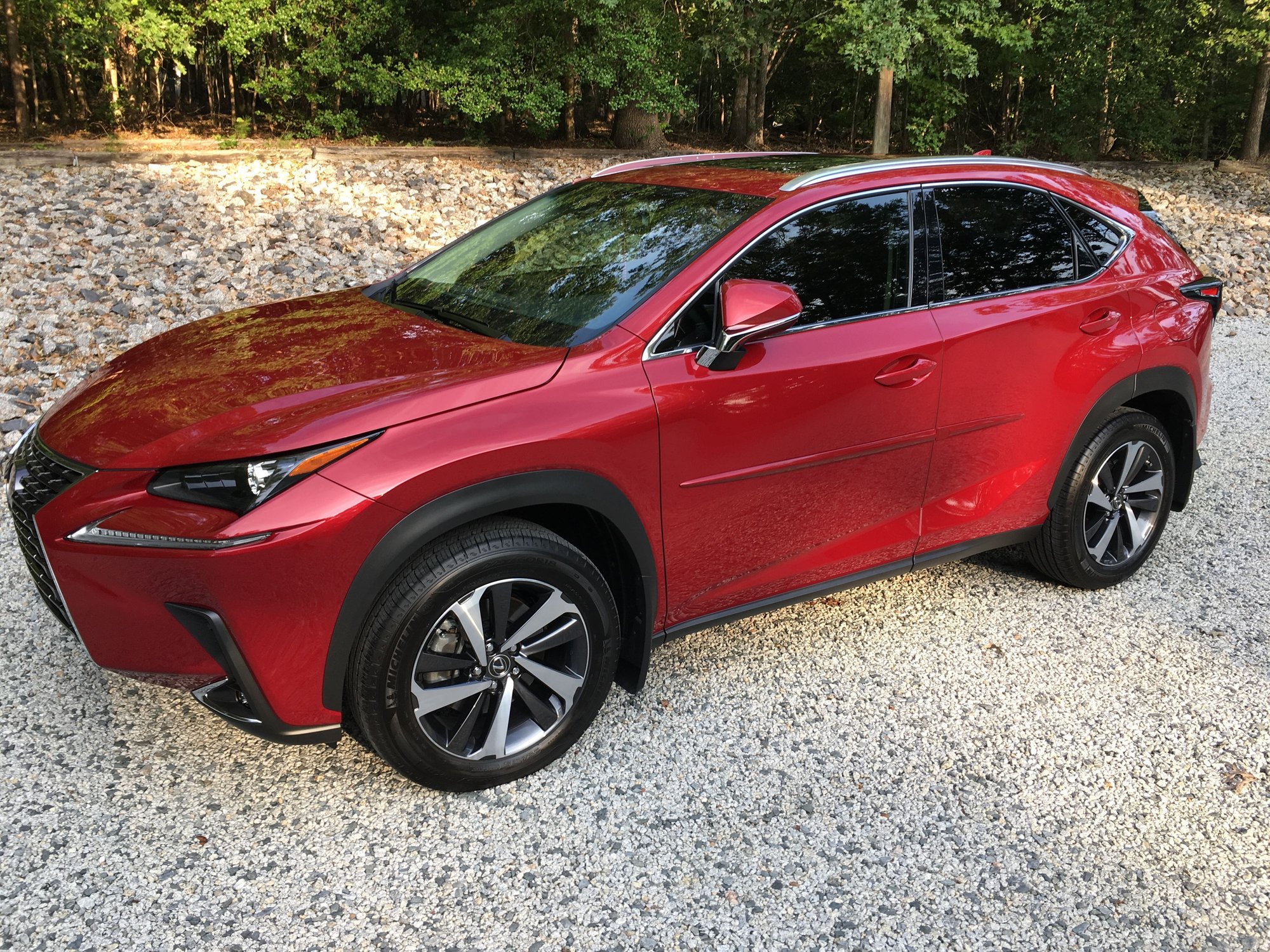

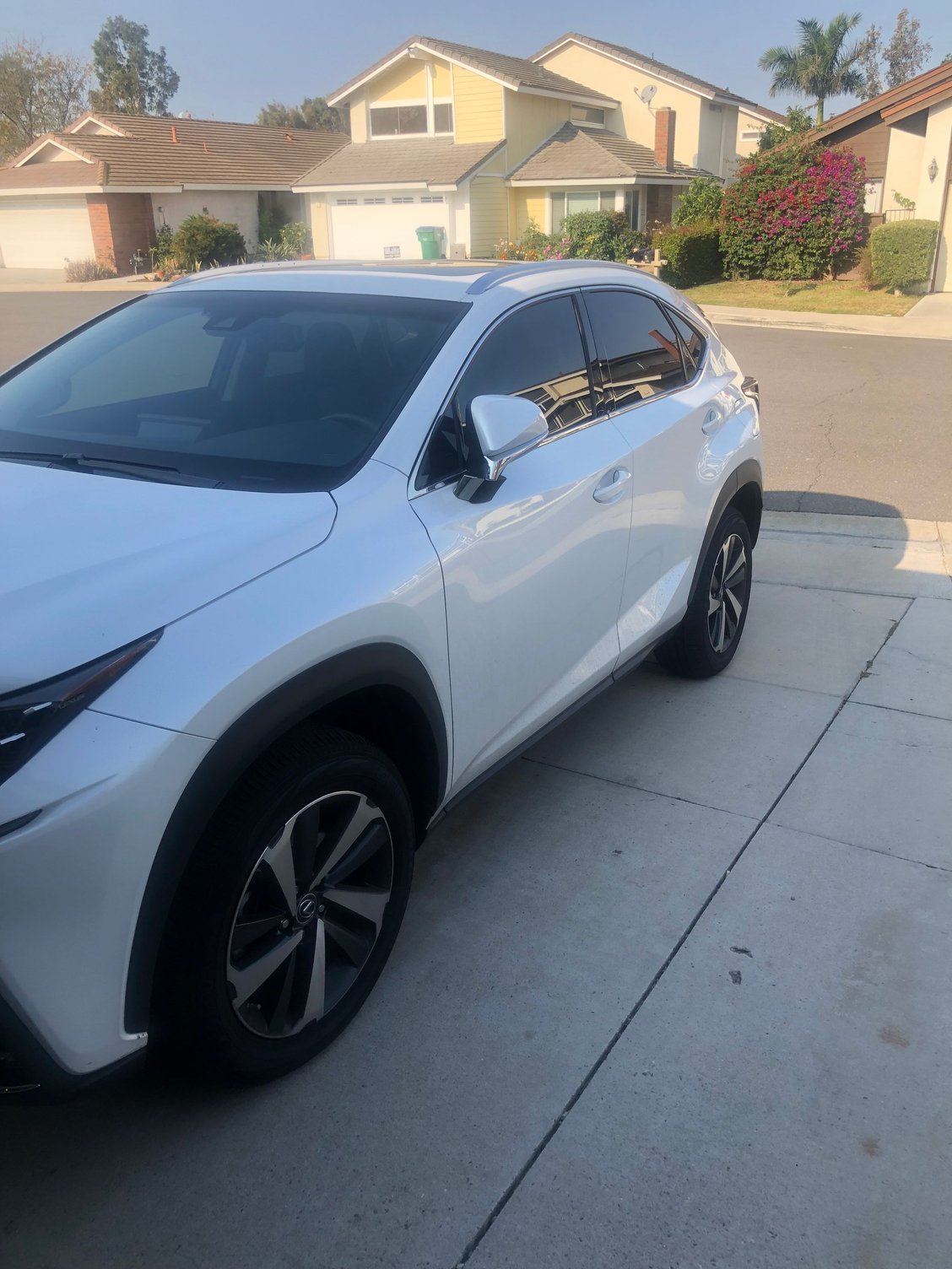

Here’s mine, not sure what brand and it’s not too dark, maybe 30-35%

Looks nice!

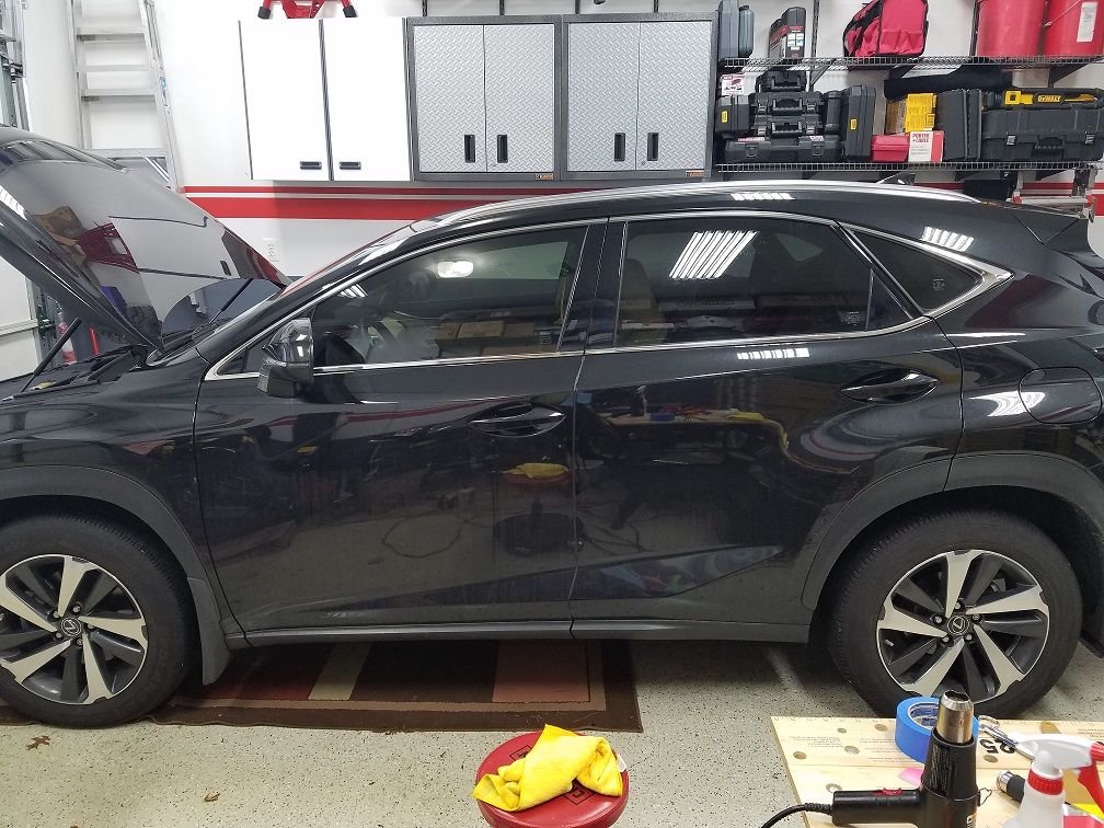

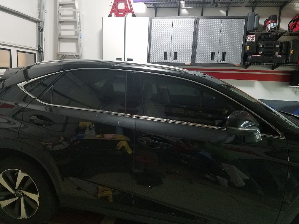

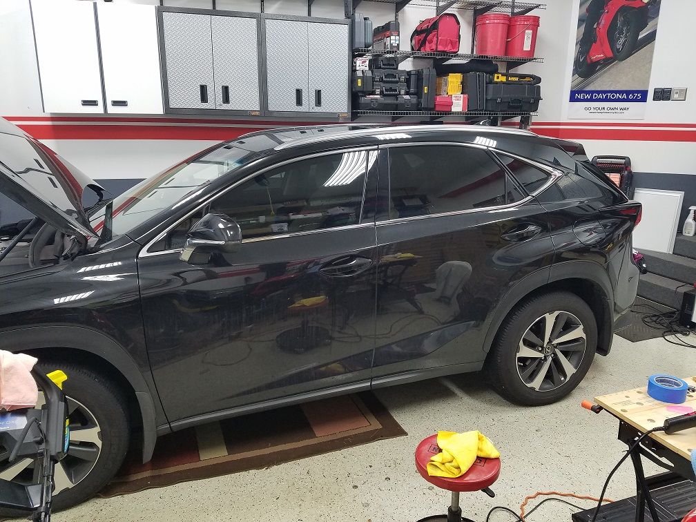

I just tinted my wife's NX about an hour or so ago.
This is what I used:
https://www.ebay.com/itm/PRECUT-FRON...72.m2749.l2649
I've used them on all of our cars and their tint is always quality 3m and cut perfectly.
See pics below. Matches very well. I went with 20%. The only difference you can tell is when you are on the inside. The factory tint lets more "white" in for lighting compared to the front. So when looking outside you can slightly see a difference with the shade but that's to be expected given the factory dyes the glass compared to using a manufactures's tint product.
Note that I did NOT use a razor blade to clean the windows. Cleaned using hard card and squeegee, and I had ZERO problems or scratches on the front windows what so ever... If you take it to a place and the F up they shouldn't be tinting. Tinting is not my profession at all but it's not hard. Shrink the tint to the window then make sure the window is CLEAN... and it goes fairly easy. The front windows are not complex at all so it's quite easy.

I tinted my wife's 18' NX with 3m color stable 20% on the front. Love it. From the OUTSIDE it matches pretty perfectly with the rear factory tinted windows. However, when you are inside you can definitely see a difference in the fronts from the backs. Does anyone have pictures of the inside looking out from only front window tint?
It definitely bothers me more than my wife. My wife doesn't seem to care, but when I drive her NX just being able to see the back windows when I turn and look compared to the front are bothersome in a way. I was thinking of getting 50% tint 3m CS for the rear but I am really hesitant because I don't want the back windows to be super dark or hard to see. The front 20% is already some what difficult at night. Making the rear darker would not be good but I'm looking to match as close as possible. I just haven't ever seen 50% over the factory rear tint or how much darker it would make it...?
Here are exterior shots of what I did.

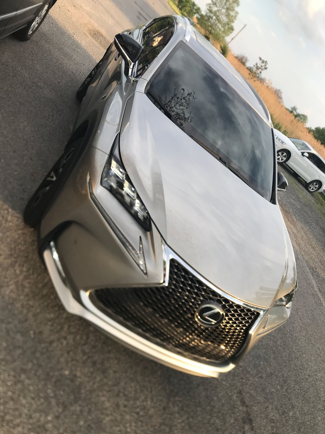

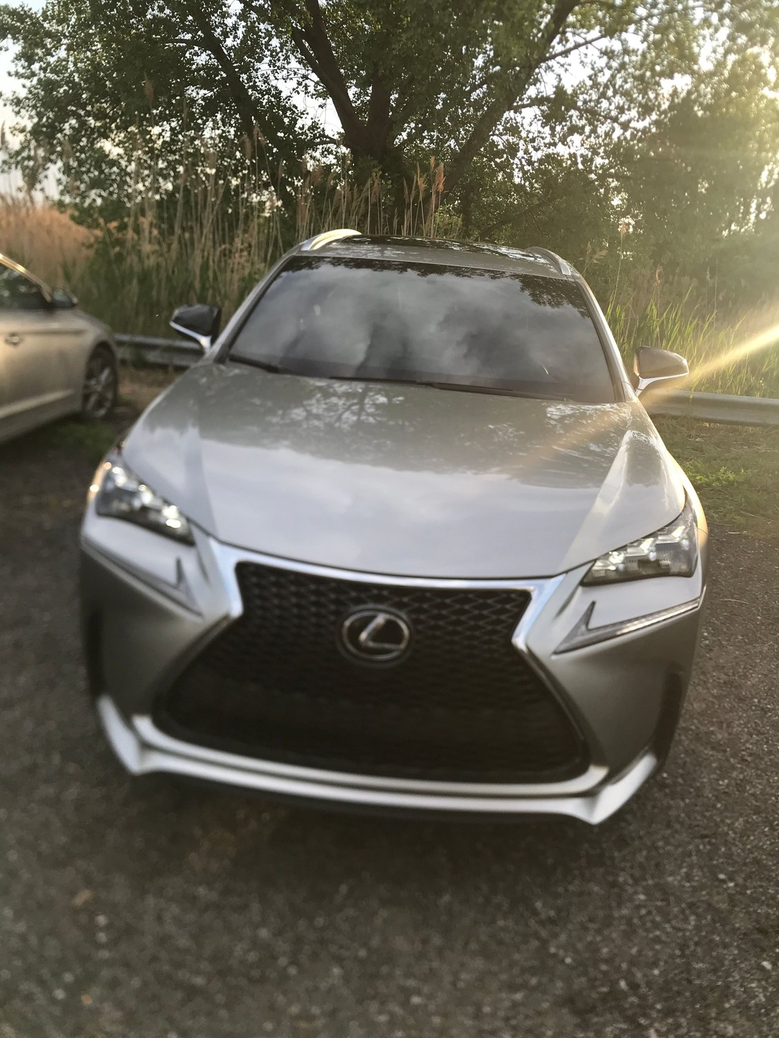

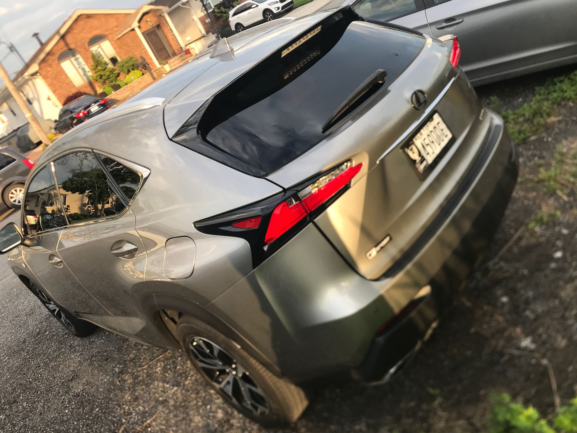

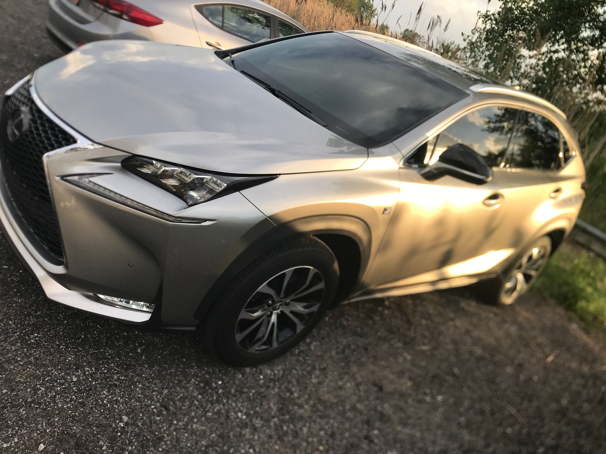

Front windshield tinted 50% orange corner markers blacked out Front side windows tinted 20%
