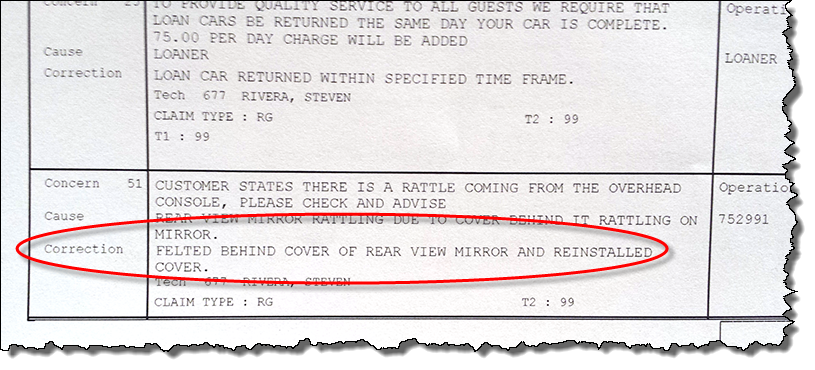

Coincidentally yesterday, I discovered an adjacent small rattle in the overhead console area. I added similar material (was black grippy drawer lining) in the ceiling liner right above the mirror, crammed in the 1-2 mm of space separating it and the roof. I suspect it's the wiring from the mirror and safety hardware that is moving ever so slightly over bumps making the noise. It's been a day, knock on wood, no more rattle as soon as I put this material in the gap.
My NX is only a week old and I've noticed this rattling at the top forward end of the overhead console, too.
At first I thought it was the mirror and after countless mirror adjustments, squeezes, taps, etc, I pinpointed the source as coming from the overhead console.
I will try to put some of that foam or grippy drawer lining up there and see.
Thanks, @corradoMR2

RXOwner, some small squeaking has resurfaced recently in the overhead console. Not sure if perhaps the material moved around allowing the wires to tap against the headliner, but keep us posted on any progress on your end. I may end up revisiting mine the next few days and will update.
I didn't want to bother with a DIY solution for this, especially when the car is only two weeks old, so I took it into the dealership this morning. A technician wanted to test drive it with me, so we went. I was so concerned that the squeak wouldn't happen with him in the car, but it did.👂 Whew! 👍
They said they would look into it and gave me a 2015 RX 350 loaner. Later in the morning, I get a call saying that the noise has been fixed. I'm not sure what the resolution is, but I'll find out when I go and pick it up in a little while.

My overhead rattling noise is no longer! 👌 My dealership fixed it with some insulation (felt). See attached work-order results...
