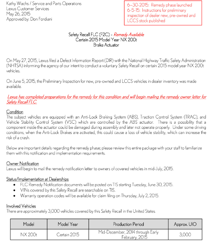

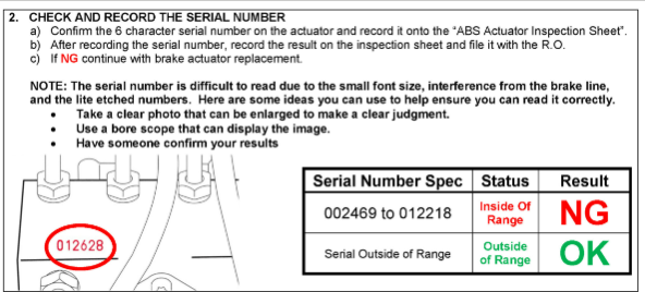

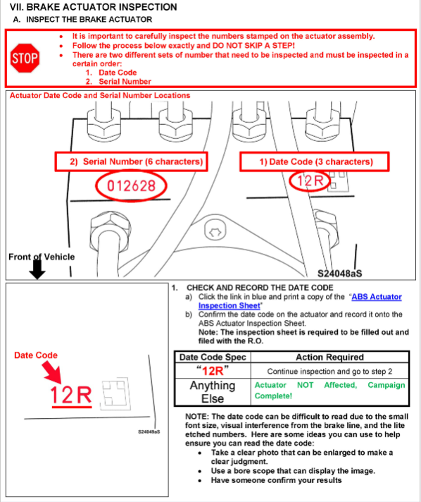

Check your brake actuator serial number. Good luck!

I checked the numbers. I got 05S as the date, and the serial number is in the range, 010924. So, I guess this doesn't apply in my case. Thanks for pointing that out.
