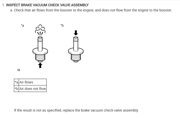

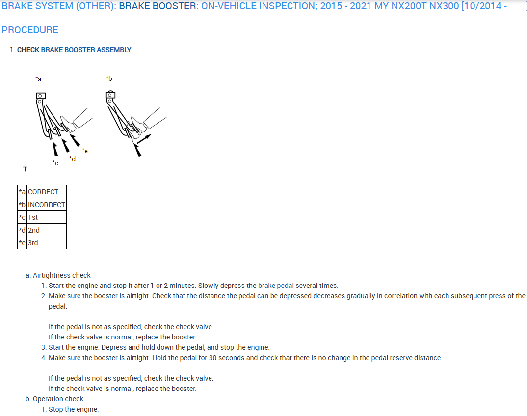

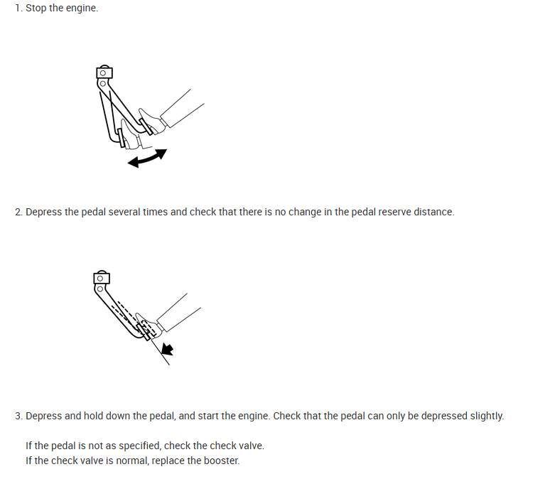

Originally Posted by tammap
Procedures to check brake booster and check valve.
Thanks for these. I will do all that tomorrow with my mechanic and report back.
