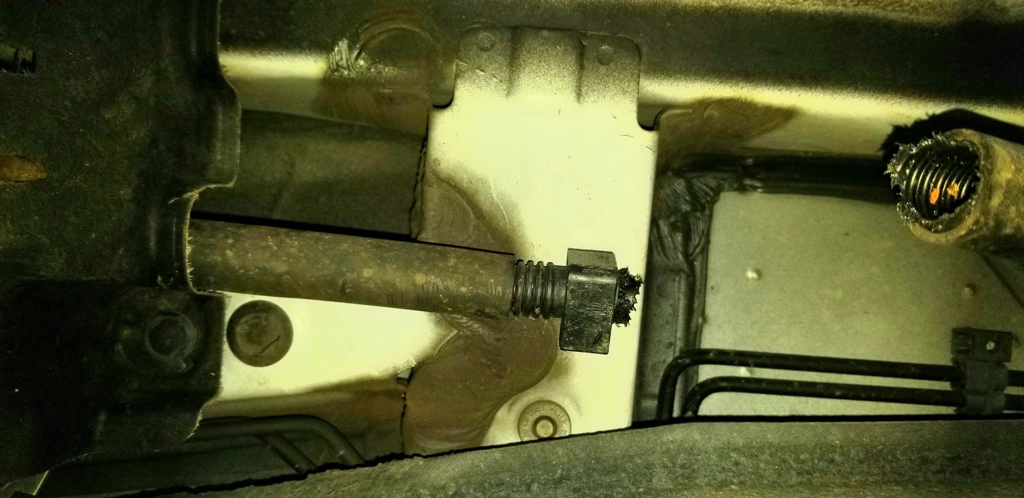

We inherited this vehicle and it has only 22,000 miles on it. In great condition. The late owner didn't drive it much but had regular services done at the local Lexus dealer. When looking it over this morning I saw a black hose, about one inch diameter hanging under the car mid-way between the driver's door and rear passenger door. About under the mid-car pillar. It will replace my 2012 Nissan LEAF which has a failing traction battery (down to about 40 miles range).

AC Evaporator drain hose?

Check the linked previous message thread to see if this is the hanging hose you asked about:

Ah, I didn't think of that. I'll run the A/C and see what happens. Of course, it is 33 degrees outside now, but will see and reply back to this suggestion. I checked the link to the broken emissions hose and will figure that one out too. It might be the problem, nothing that a PVC pipe double end adapter with clamps can't fix.

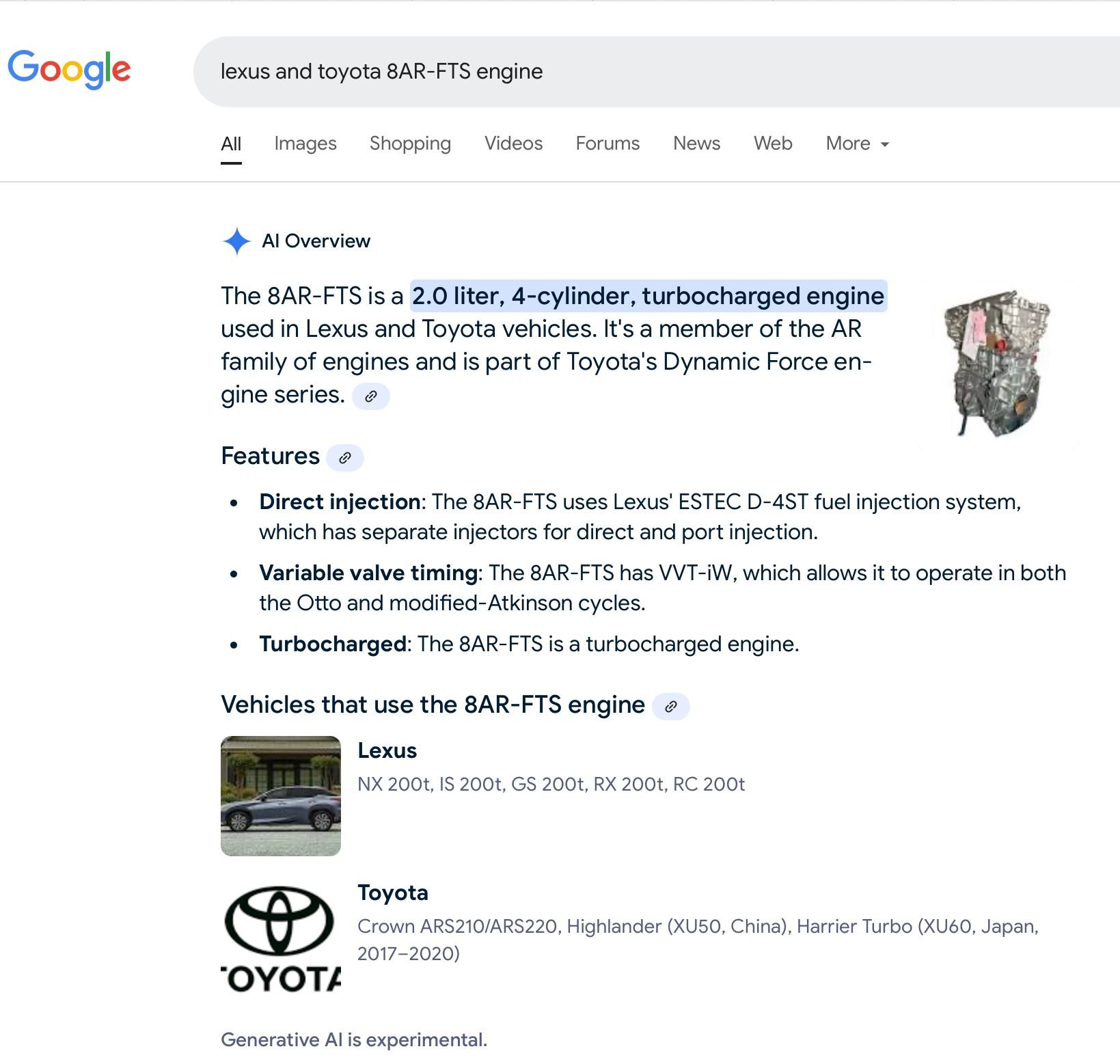

Coming from an old soldier’s wife — Just wanted to make sure that was a typo (bolded above) and you meant 8AR-FTS with the #8 as in below.

OK, I got a picture of the hose which is disconnected under the driver side. One suggestion was that it is the emissions control evaporator drain. Looks like the plastic connector between the rear hose run and the front hose run is broken. Picture attached. I'm planning to use a double-ended PVC pipe splice with stainless steel hose clamps at each side to repair. After this next project is reattach the left exhaust pipe end nozzle which was broken when driver backed into something.
