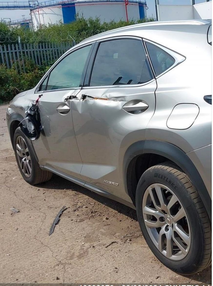

My Lexus nx300 h after an accident damaging only side door ( front and back completely untouched ) is not starting it just starts the engine and than shuts off
it searched it’s due to pyro fuse .
can some plz help me to locate this fuse ? And how to replace it as its a mechanical switch .
google does t give me any thing on this hence posting here with knowledgeable and experienced sources.
regards and many thanks for reading and reply

There is a fuse on the right hand side of the HV battery pack but not something you should mess with unless you have proper safety equipment and training. Maybe there is another high voltage fuse somewhere if so that's beyond my knowledge.

Not sure about the latest version of Toyota's hybrid system but from what I know the engine won't start if the high voltage battery is not charged correctly or disconnected. My guess is there are a bunch of fault codes so the computer shuts off the engine to prevent you from driving the vehicle.
