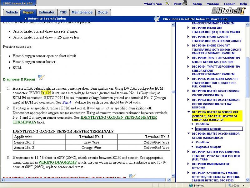

o2 sensors are not critical sensors to the vehicles operation (about the only sensors you absolutely HAVE to have are crank/cam sensors) most other sensors, like the o2's, can be lived without, the car may just not run right...
It almost sounds to me like something in the circuit is messing things up, not necessarily the o2 sensor, however, it still could be the new sensor not working properly... I don't have access to it this morning, as someone turned my computer off at work, so I can't access my troubleshooting data... I might run by later once I put the dash back in my car so I can look it up though...
Old Jun 18, 2007 | 06:08 PM
mitsuguy's Avatar
mitsuguy
Maintenance Moderator
Joined: May 2005
Posts: 6,388
Likes: 27
From: AZ
here's troubleshooting procedure:

Really appreciate the help and info. You're the first person with this clear of an idea of what to do next. Kind of surprised the Lexus mechanic in Atlanta or KC didn't come up with this.
I'll let you know how this works out. Thanks again.
