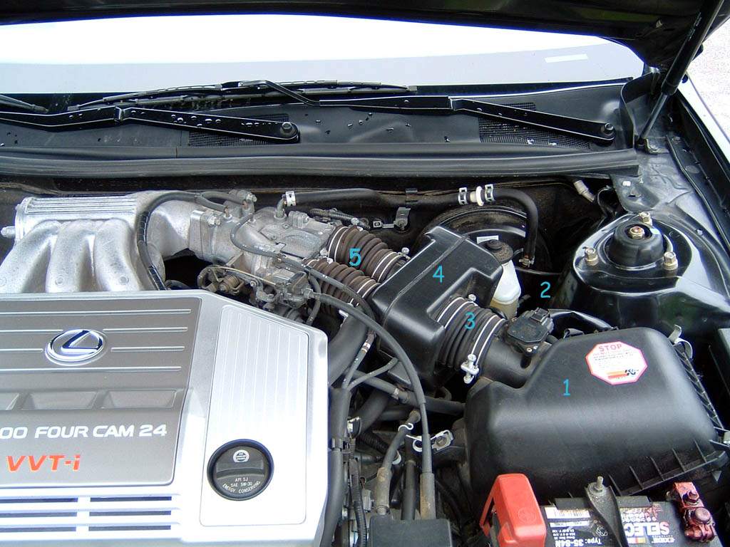

After completing my 90K service about a week ago, I was still getting the rough idle and hesitation issue upon engine start-up. I decided to take a look at the throttle and intake system since that seems to be the culprit after much research in the CL related threads and articles. Here's a pic of my engine (driver's side).
Nailing down the basic components (hope I got them right)
1) Air filter assembly
2) Mass air flow sensor assembly
3) Primary rubber hosing
4) Plastic air intake body
5) Secondary rubber hosing (both connected to the throttle body linkage)
Although mine is a 1MZ-FE engine, I followed the steps from this informative article, which covers the throttle body cleaning of a 1UZ-FE engine (LS400). I was able to disconnect every component listed above, except for #5 to allow me to peer into the throttle body linkage. #5 has a vise-like grip onto the throttle body, and I didn't want to risk creating tears onto the dried-out hosing from all the pulling force. Another note to mention is that there are two input bores to the throttle body from the plastic air intake, instead of one shown for an LS400.
In any case, I used Valvoline SynPower Carb Choke & Throttle Body Cleaner (bought from Advance Auto for $2.50) to clean inside the plastic air intake. I used a long screwdriver to stuff some shop rags inside the intake body to aid the cleaning process. When I pulled them out, they were quite dirty and filled with dirt and carbon.
After about 45 min worth of the job, I reconnected everything back together and started up the car. It idled much better, back to spec range, and no hesitation either
I am not sure if cleaning the plastic air intake or the disconnecting/reconnecting of the MAF assembly helped, but I hope this clears up the annoying problem I've been getting for the last few months
