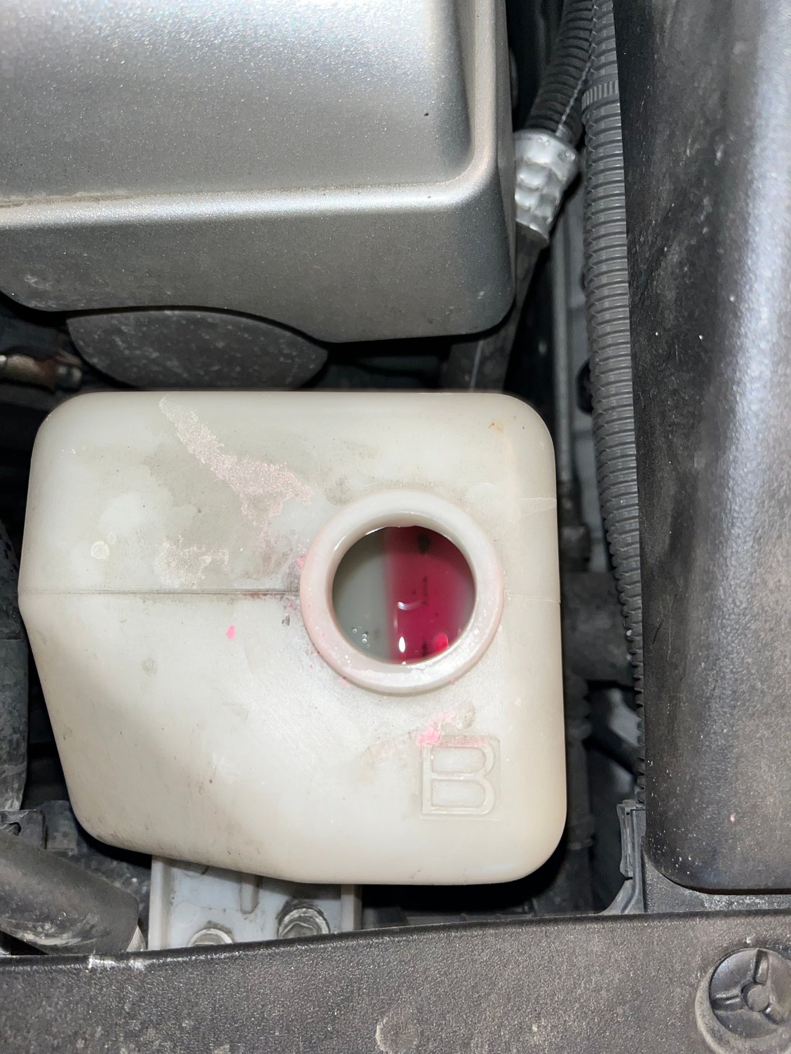

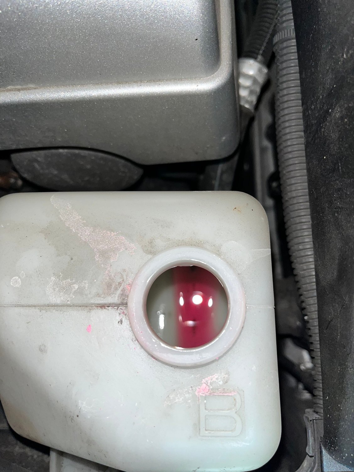

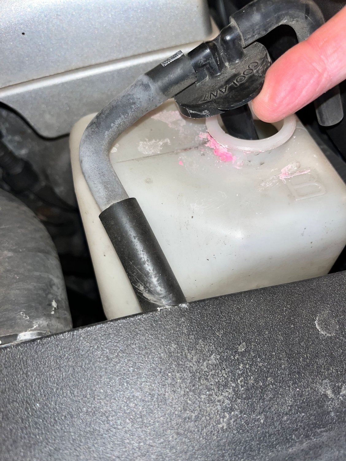

Old Oct 29, 2023 | 05:58 PM
e-man's Avatar
e-man
Joined: Apr 2004
Posts: 3,566
Likes: 49
Here are a few pictures. I believe it’s literally right at the low line or maybe a hair below. I haven’t filled it yet.
Old Oct 29, 2023 | 06:38 PM
Posts: 26,190
Likes: 4,379
Reservoir is basically empty. You have a cooling system issue it's being pushed out of the reservoir. Bad radiator cap and/or leaking radiator is common.
