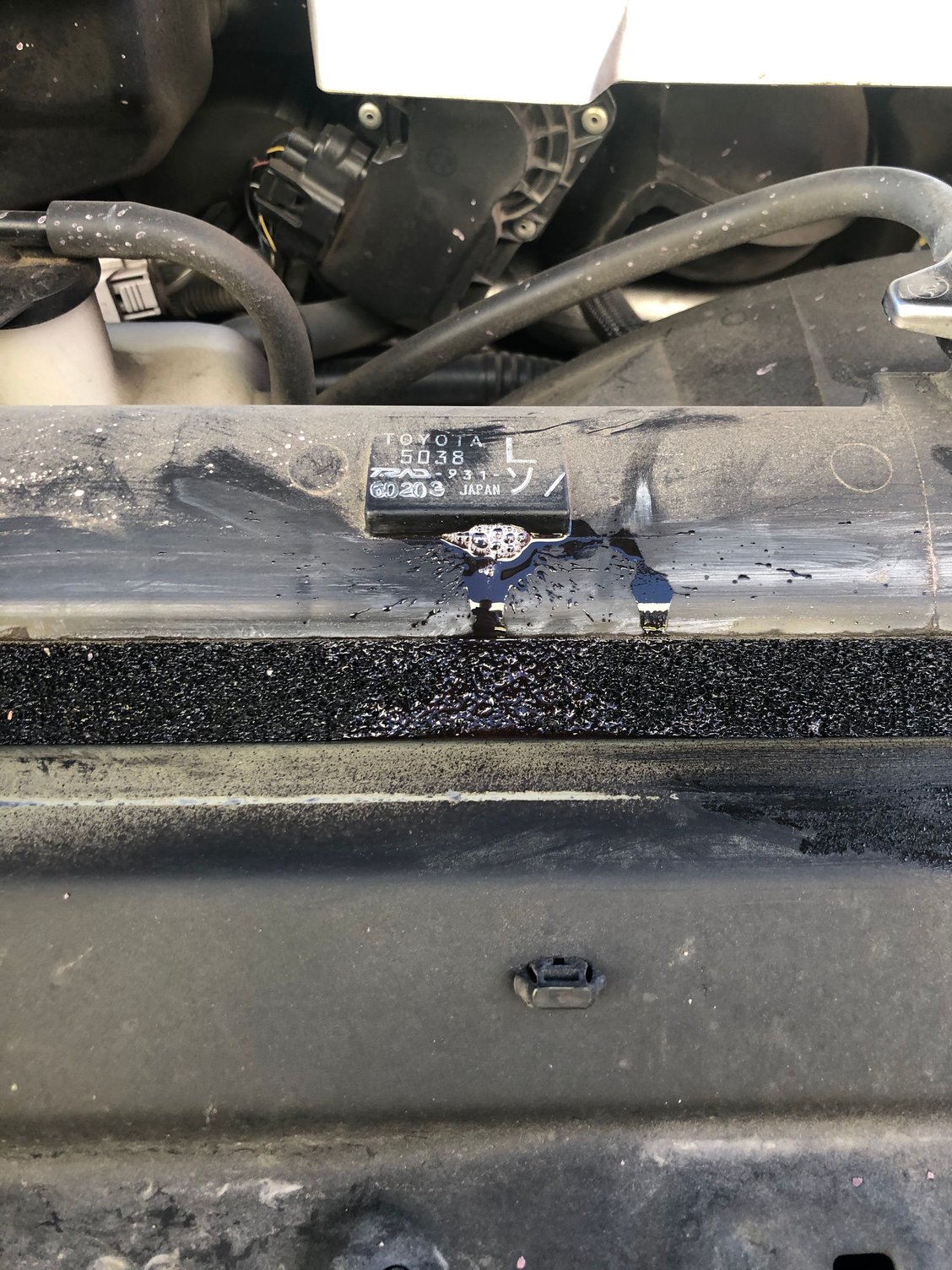

Keep an eye out on those 08-15s - I have 88k miles and spotted some ground leakage - popped the hood and found the radiator hair line crack was there, exactly where everyone else's was. Seems to happen around 90-110k miles.

I have a 2013 lx 570 as well. I had the hairline crack starting at the same spot as yours. I replaced mine before the leakage as a maintenance/precautionary item. I also replaced water pump, idler pulley, serpentine belt, tensioner, upper hose,lower hose, and thermostat.

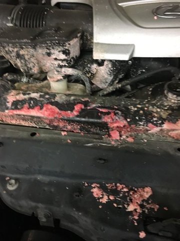

Ugh, mine just went on my 2010 with 130K miles. Opened the hood to try to find the source of an odd smell and saw dried coolant everywhere - took it in and they confirmed it's busted. Will likely have to do hoses as well. Wonder if I should have them do water pump at same time..?

With 130K, and as long as you're removing the radiator, it definitely makes much sense to do the water pump while "you're in there". I'd also replace the heater hose "T's" as well as any other hoses that feel like they're starting to harden...and there are more than just a few.
130K is also time for new spark plugs.

My Toyota Service Advisor just sent me this pic. Unfortunately they don't give a break on labor to replace the water pump while doing the radiator, so it was going to cost me $1,000 either way to do the water pump so I had him hold off. We'll see when that goes bad. I'm waiting to see what they recommend on the hoses. I'm glad this didn't happen during a road trip - did a 1,200 mile round trip over the holidays and my wife just did about 200 miles by herself really early in the morning just 2 weeks ago.
