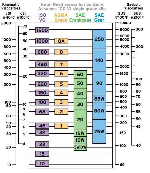

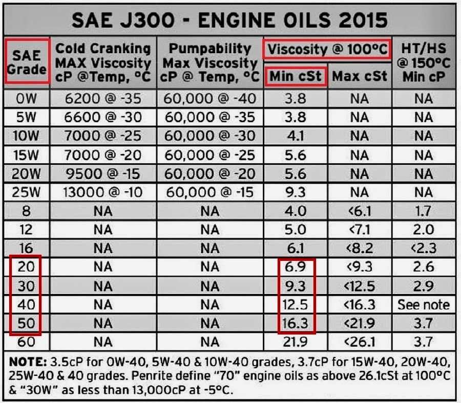

I think the OP's comment is that this is the first time we're seeing an engine RECALL where the OEM correction is to change oil from a 0W-20 to a 0W-40. Which all it does is increase the oil film thickness at operating temp (100 C or 212 F). So it provides more cushion in the GM 6.2L V8 against bearing damage. Heres the SAE J300 2015 charts the Oil Geek references in his video.
Tighter main bearing clearance or not (GM vs. Lexus) the higher weight (20 vs. 40) at operating temp (100 C) does provide more cushioning between metal surfaces. And more drag too, so less fuel economy. We're talking micro inches difference of film thickness here... There's always trade offs.
SAE Oil Grades (2015) chart
SAE Oil Grades (2015) Comparison chart

I would only use what Toyota engineers have tested and recommended as per the global manual. Select regions like Japan and US have stricter regulatory environments, and thus have different requirements, but even then you can only go so thin (have yet to see the new toyota 0w8 oils in v35s). Toyota has always made it simple, select the ambient temps limits, select the correct oil numbers within those limits, and run a duty level rated oci.
0w40 is not on the list. Im referencing this, and it seems 0w/5w for the cold rating and a 30 covers the spectrum and limits. Again any of the oils in the manual are fine, as long as there are appropriate for the temps and duty cycle.
https://lexusmanuals.com.au/document...-dec-17-sep-18
Side note:
No engine is "designed for" a particular oil grade. An engine can be designed to tolerate thinner grades of oil without excessive wear but that's it. Oil doesn't "get places" faster either. Either it is being pumped by the oil pump or it is not. The winter rating illustrates whether the oil can be pumped or it won't.
"0W flow" is only important over a 5W when the temperature is below -35 or so. Is this your operating environment? And it's not really about flow either. It is about cranking and pumpability. No 5W-30 would have the same "cold flow" as a 0W-20. One is a 30-grade while the other is a 20-grade. Even if it were about "flow" then if the one with a 5W winter rating was better it would be required to be labeled as a 0W. That's how SAE grading works. Pour point does not adequately represent the cold-weather performance of a motor oil. It has deficiencies.
Motor oil recommendations in owner's manuals are rife with undisclosed outside requirements that are anything but technical.
