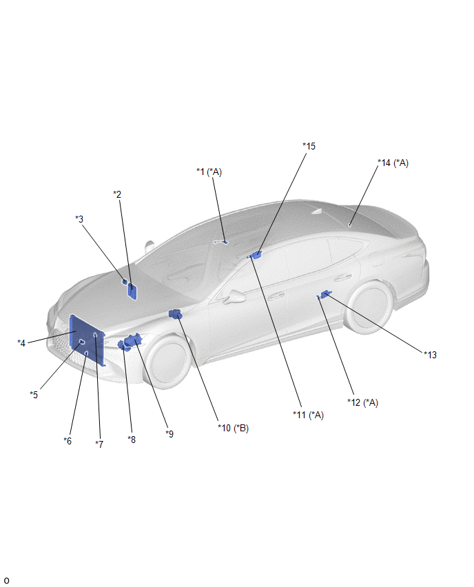

An extensive review of TIS pages does not reveal the name or function of the panel.
It is shown in drawings of other overhead console parts such as the lights and SOS button
but not highlighted or described.
Old Sep 21, 2024 | 07:59 AM
mcomer's Avatar
mcomer
Joined: Nov 2013
Posts: 4,264
Likes: 1,207
Default OK, found it! IR Matrix Sensor
*A Models with Multi-zone (4-ZONE) Climate Control
*B Models with Lexus Safety System +
*1 IR Matrix Sensor (Air Conditioner Infrared Rays Sensor)
*2 ECM
*3 No. 1 Semiconductor Power Integration ECU
*4 Cooler Condenser Assembly
*5 Smog Ventilation Sensor
*6 Ambient Temperature Sensor (Thermistor Assembly)
*7 Air Conditioner Pressure Sensor
*8 Power Steering ECU
*9 Compressor Assembly with Pulley
*10 Skid Control ECU
*11 Rear Room Temperature Sensor RH (Cooler Thermistor)
*12 Rear Room Temperature Sensor LH (Cooler Thermistor)
*13 Rear Multiplex Network Door ECU LH
*14 Cooler Thermistor (Solar Sensor)
