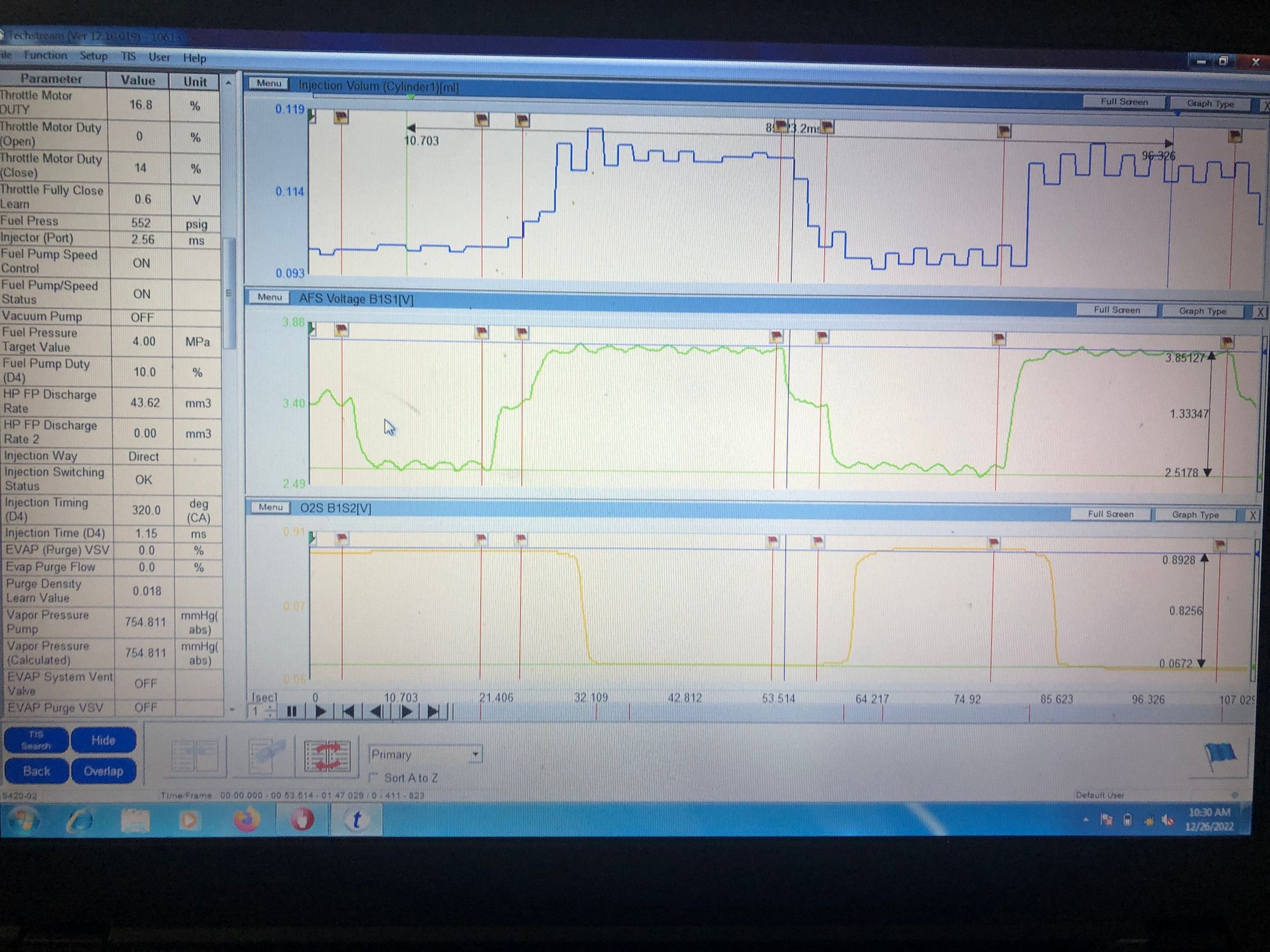

Service Manual gives a clear indication on how to determine if the Catalyst is comprised.
Just a visual for those who haven't seen Techstream. My O2 Sensor is reacting to the micro changes to active test - fuel mix (rich and lean).
Thanks Trogdor113 for the service manual files. Very helpful! Techstream diagnosis is showing that my catalytic converter is bad or there is an exhaust leak. I'm planning on doing a soapy water test later this week for checking for holes in the exhaust. Since it is just around $60, I might just change out the O2 sensor eventually to fully confirm that the catalytic converter is bad. I don't need to CA smog until Oct 2023 so I have time to work through this.
Is this the screen that comes up when you choose the active test? I've been dealing with a P0420 for since it first started getting cold and I've run the graph just to see what the AFS and O2 sensors are doing but I haven't run the active test yet. On the regular graph it does not show the micro changes in the wave length like in your screenshot.
