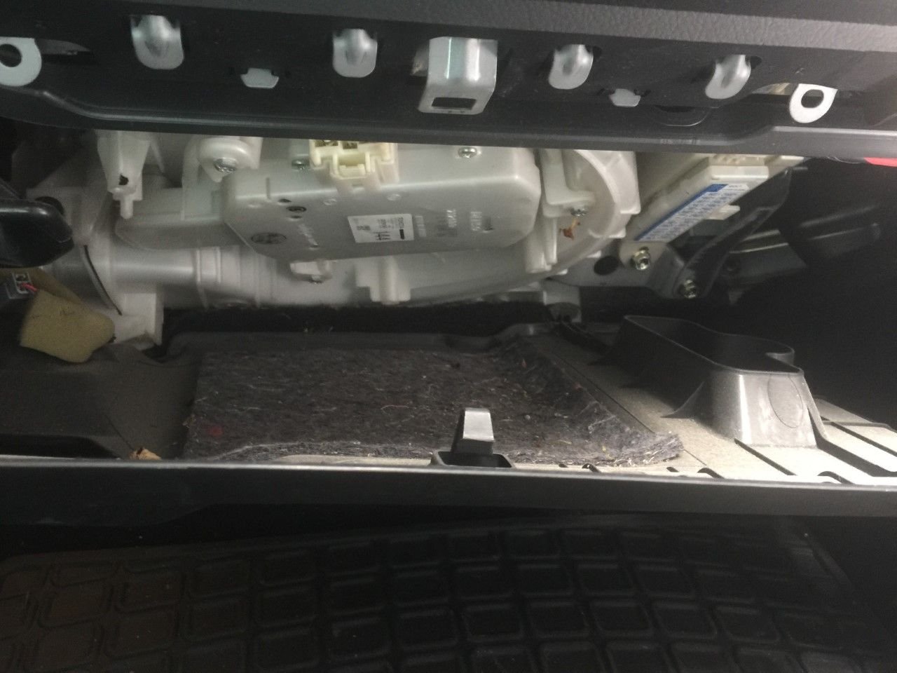

All 3 of my cigarette lights are not working, so i checked the forum and the solution is changing the fuse in fuse box 2 under the passenger side glove box. So I checked under the glove box and found the fuse box 2, but I can't pull the fuse out. The space between fuses is very tight. does LS460 comes with its fuse puller in other fuse box like some Toyota model or I have to buy a specific puller for Lexus?

I found the fuse puller under the cover of fuse box near the engine. I used it to replace the 15A fuse under glove compartment and made the cigarette light working in front of the gear shift. the 2 cigarette light plugs inside and behind front row arm rest box are still not working, maybe i need to change more fuses in the trunk fuse box?
