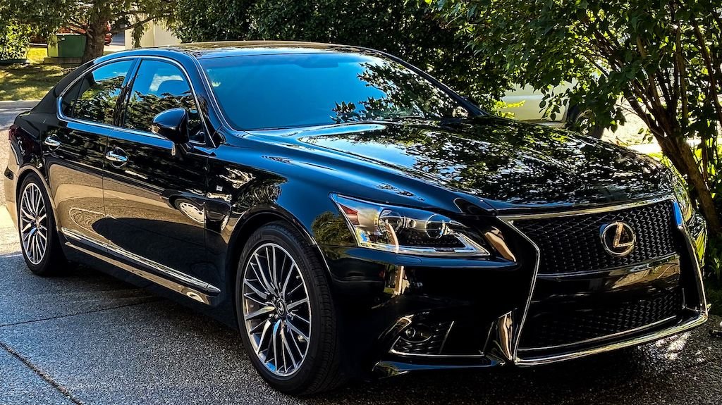

Mine is similar in height to yours but a little higher in the front. I did it with the links because of the cost in cdn dollars for the data systems unit, the height switch still brings it up to clear most things.
I really like that blacked out look on your car, do you ever slam it or is that too hard on equipment?

Thanks brother, appreciate the kind words! Would prefer the nice black paint of yours, but some neglect over the years was partly what caused the blacked out route and having the hood, roof, and trunk deck vinyl wrapped. I do air it out occasionally, maybe once or twice a month.
