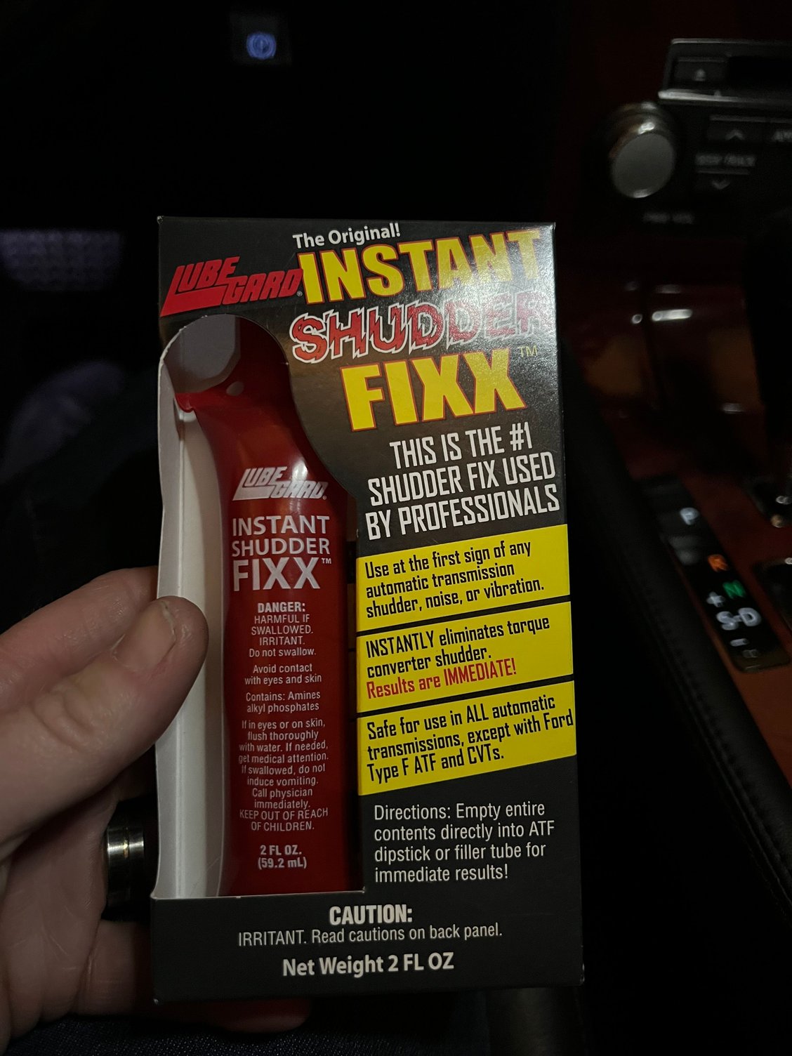

I’ve always been against additives but a tech at work recommended this.
thoughts?

The best that you could expect from that product is that it will do absolutely nothing.

Do not use that.....it won't do anything for this trans/fluid combo as well as the issue you are having.
