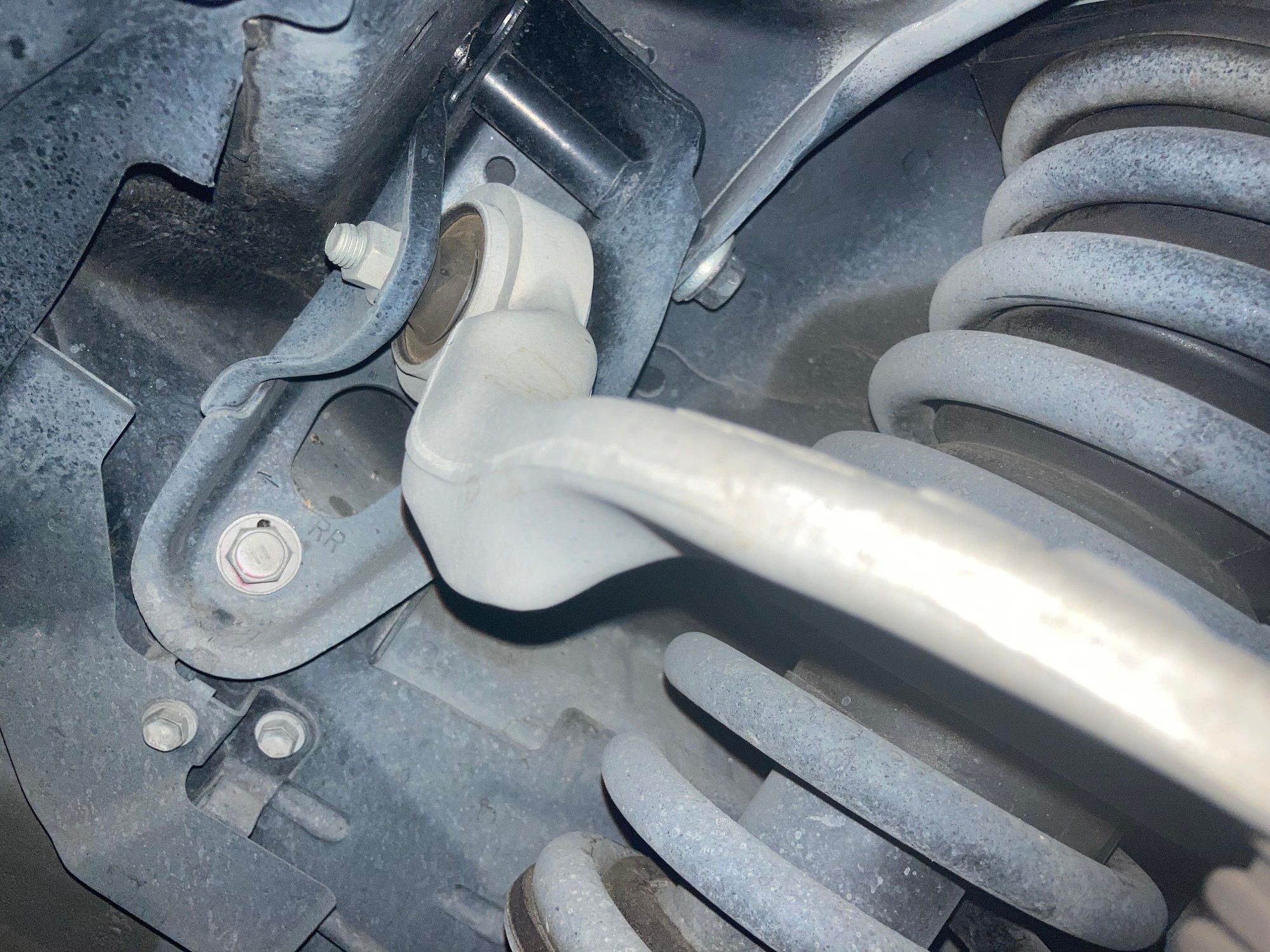

upon further inspection the upper control arm bushing on my passenger side show metal can someone kindly confirm these bushings are bad
Old Jul 4, 2022 | 11:39 AM
swfla's Avatar
swfla
Joined: Feb 2006
Posts: 4,488
Likes: 1,328
From: San Diego, CA
That is a worn bushing but I've seen worse. What do the other bushings on that arm look like? You need to see the full picture. If this is the only sign of wear on all arms, I personally, wouldn't bother replacing it yet.

here is the picture are there any other bushing that has effect on steering feel other than upper control arms? the steering feel indicates something needs replacement

There are two sides to each upper arm bushing. That's four pictures.
I would not be surprised if the rubber is completely or mostly separated from the inner metal sleeve. And when the steering is turned near or at full lock, the arm is sliding or shifting and maybe even popping off the separated metal/rubber core. Those bushings take a lot of punishment and flexing the more the steering is turned. You can see for yourself if you jack the front end up and have someone turn the steering wheel for you. I try to advise people to have a good look at the control arms when the vehicle is in the shop and on a lift or alignment rack.
There is only 1 bushing in each of the 4 upper control arms, and in my opinion, the bushing pictured is shot.

Posts: 17,910
Likes: 1,702
That's torn, with how much those arms move that 100% is allowing way too much deflection. I would replace all 4 upper arms, the front two receive most of the wear due to how the multi link works

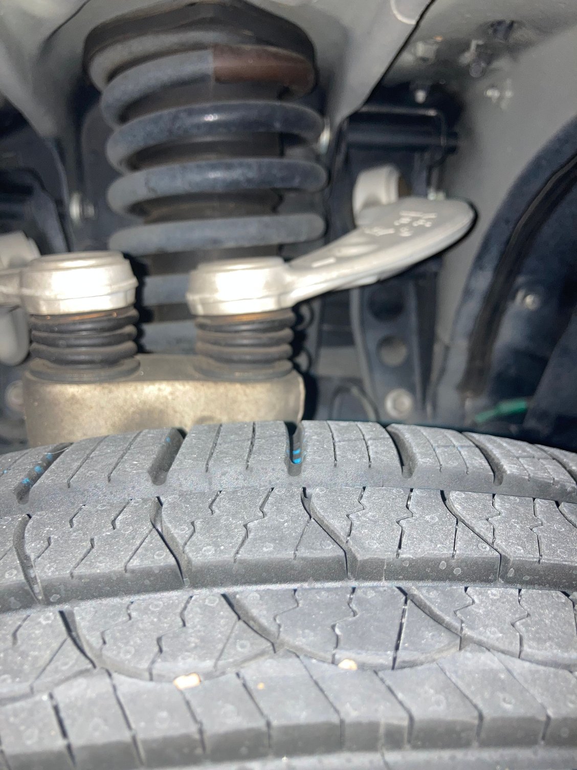

what do you think of this lower control arm bushing?

Posts: 17,910
Likes: 1,702
Not great but likely not totally torn/allowed to move past where it should.
Issue with multi link suspension type is that if one part is worn then all the load will hammer the worn part much more than the others. It's not able to hide wear as well as a double a arm setup or strut setup. There is a thread in here showing how much movement multi link setups experience
