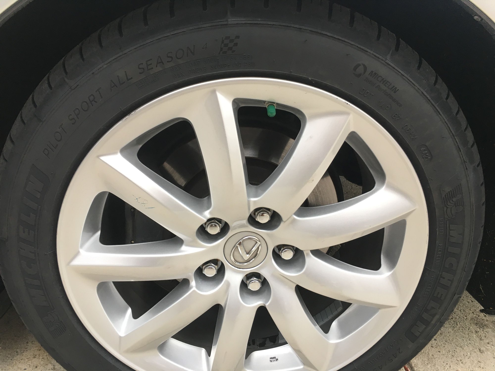

Just got back from Costco and DAMN. The car literally feels 1000lb lighter and is so damn reactive and quick on its feet, plus I can floor it with zero wheel spin. Mid corner I can go full power and it just rotates a little without having the VSC freak.
Totally transformed the car. The word "darty" actually would be a valid description, I can't believe how much this changed the car. I HIGHLY recommend these to anyone who wants their boat to feel more like a 5 series
Figured I would add some pictures of the new tires, they actually bothered to park my car backwards and next to the no park area lol! The manager of this department likes me and installed the tires for free including TMPS modules, made my day to be honest.
Little small in the wheel well but still looks fine, I may do some coil overs to drop the car a bit and tighten up the ride a little. The car has a lot of roll vs my 430 at the limit

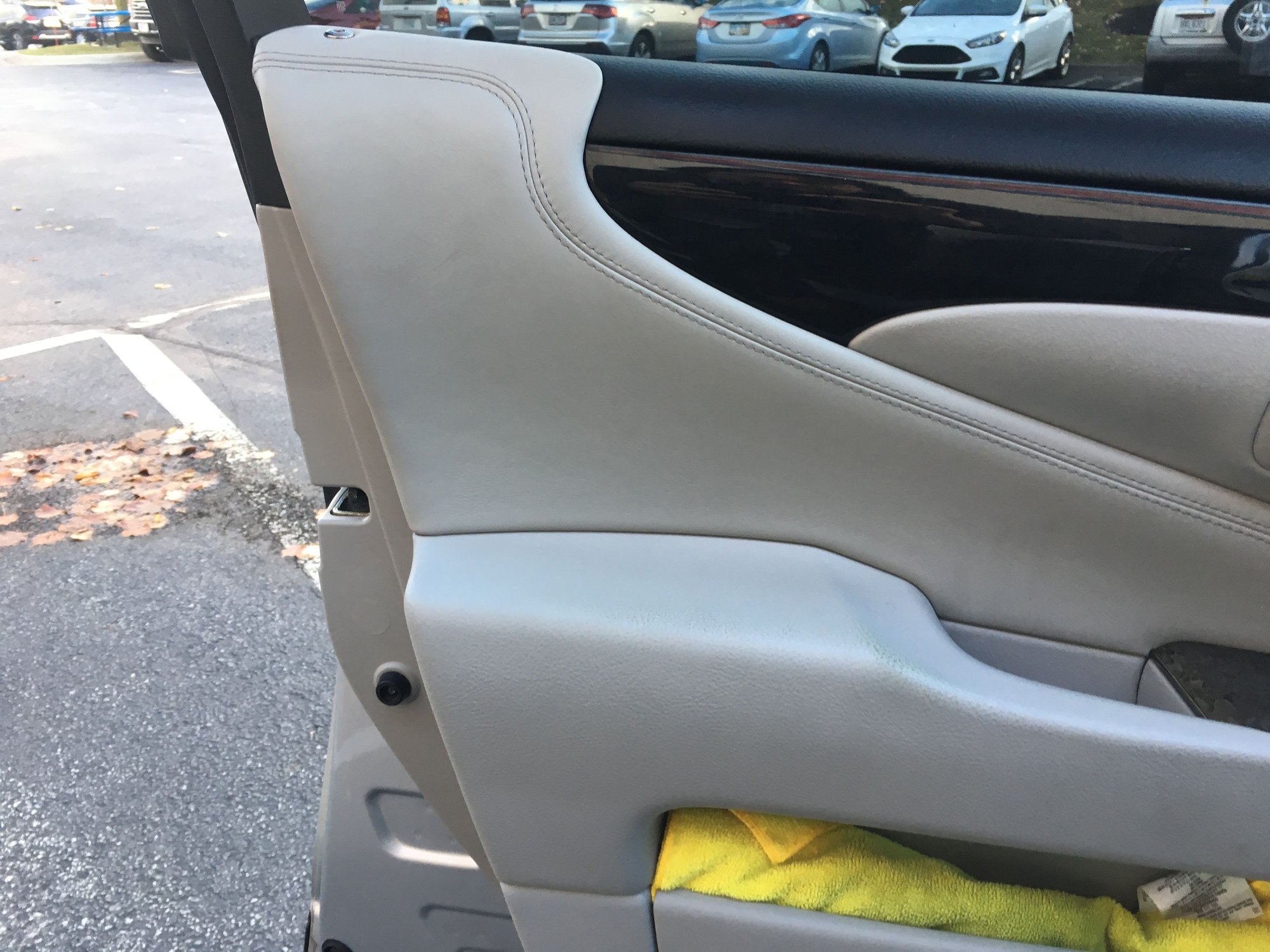

They did get some grease on my door and sill, no big deal and that’s why I carry interior plastic and leather detailer. I knew they would screw this up since they haven’t failed to do so yet on any of my cars and I’ve brought 5 of them by for tires here. The free sensors and service makes up for it. $300 savings for 2 min of my time.
