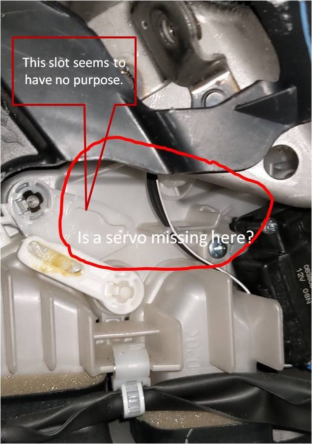

Initially, I got the same code. Then another code popped up, B1458 Air Outlet Passenger Front A/C Rear Air Flow. Then after another start, the B1441 code went away completely, but still the new B1458 code. So now I'm searching for this air outlet servo and can't locate it (see pics).

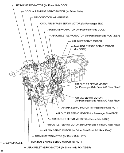

I found another post on a 2008 with heater problems with a great pic of the servos. The weird thing is I don't seem to have an air outlet passenger front a/c rear air flow servo (that I can tell anyway). At least the servo shown in the second pic is not on my car. I realize that these may be different models, but something still seems missing.
Any suggestions on how to clear the code? If I don't have the B1458 code servo, any ideas on how to fix this?

This pic is from the other post about the 2008 heater problem, but illustrates the a/c well.
This is my car. Should I have a servo here?

The thread pictures you referenced appear to be a LS600h. I think all of them have the rear ac option. Also it appears his LS600h is right hand drive. I have no idea if that makes a difference with the part pictured, just pointing it out.

@miket000 , the new (actually used) amp model number is 88650-50B70 and mine is 88650-50B51. It was the closest I could find to mine and was hoping it would work. Anyway, the results were the same (i.e. still same B1441 code), so it made no difference. You're right, the pic is for 600h. The pic does appear to be the same orientation (i.e. heater core piped from passenger side, etc.) so seems to be oriented as is mine (even if it is RHD).
I investigated more and found that there is a servo on the driver side that is actuating the mystery lever arm in my last pic. Apparently there is a rod the reaches across the unit to the passenger side levers. I'm guessing that the housing is a common design for different models, perhaps explaining why mine doesn't have a servo on the right side (i.e. doesn't have independent control for rear mix).
Also, by removing the "Air Mix" servo indicated in the video and manually actuating the lever with my hand, it confirms that this control must be the Air Outlet for rear (open/close). Confirmation was made by feeling air flow from the rear registers when moving the lever with my hand. This means that TechStream must be opposite (i.e. Air Mix is really Air Outlet and vice versa) and the above pic is really the air mix. But I'm able to control it with TechStream, so not sure why there is still a code.
The other servo (air outlet), however doesn't respond to TechStream tests but does respond to TechStream servo initialization. Anyway, I bought another replacement servo. Will see if that works in about a week.
