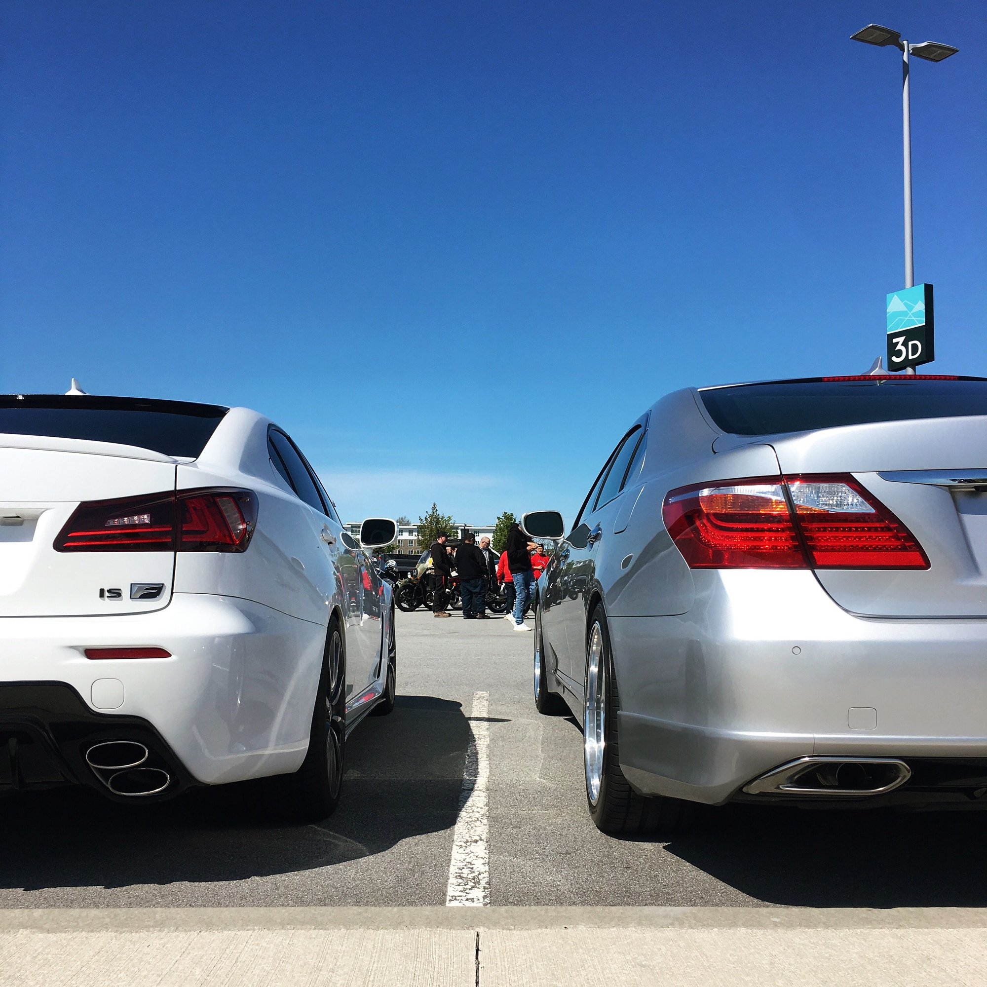

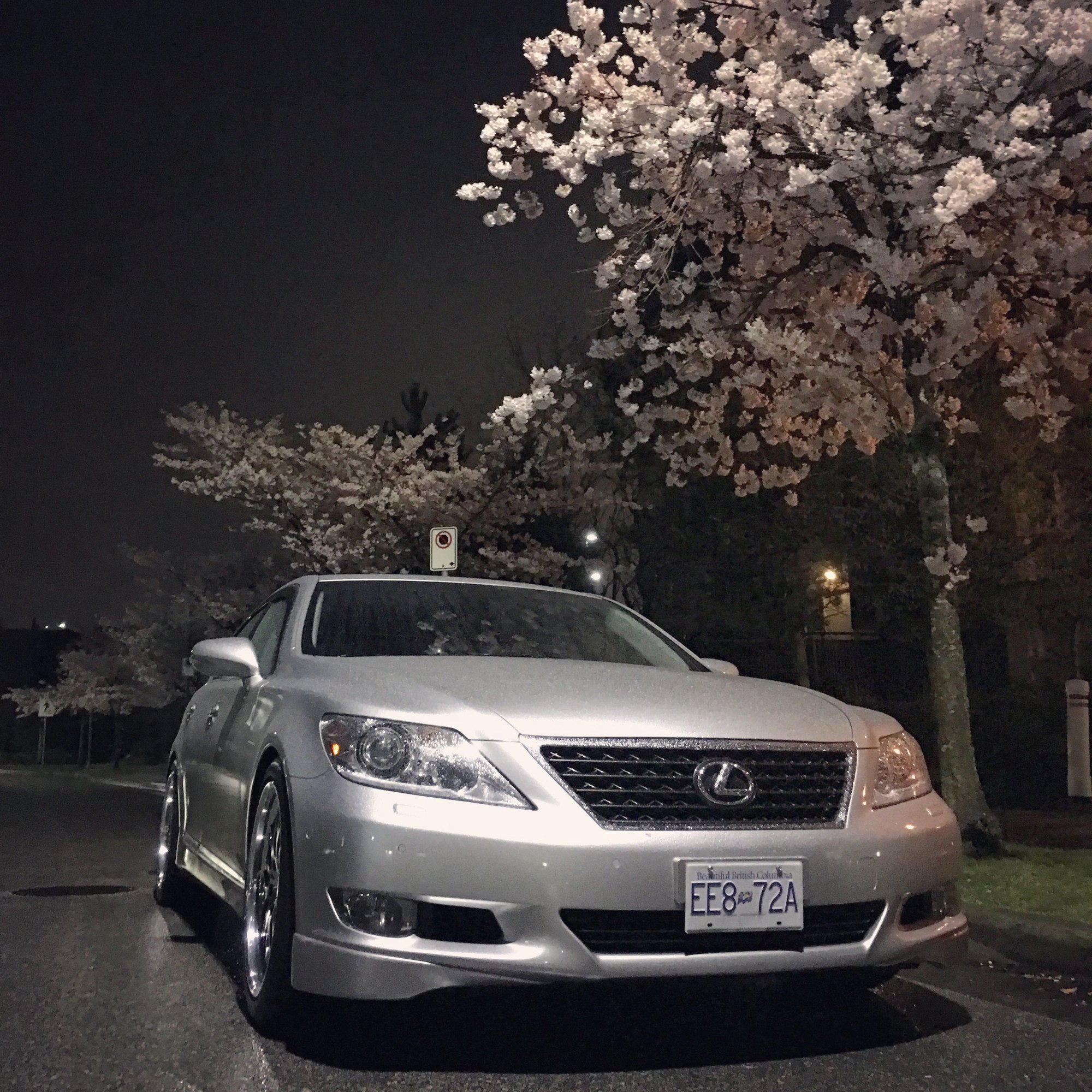

Im not too worried about offsets and sizing... Leon Hardiritt/SSR 20x9.5+26 hi disk and 10.5 +29 standard disk. They came out this size after a flip and rebuild. I wish offsets were closer to 20. I chose a tire size to avoid fender work. In the past I’ve machined down H&R spacers to get the 7mm I needed and the hub centric fit. Correct hub bore was crucial so there was no chance of negative feedback through the wheel. I always aimed to get 7 turns on the lug 😂 With the 6 pot Brembos I wasnt willing to risk any other disk face and only BBK clearance.

That fitment looks great! Are your camber adjustments still within spec? Yeah If I had a big brake kit I wouldn't be looking at anything other than an hi disk for sure. But I've got the basic non-Fsport brakes so I'm hoping they'll give me more room for a standard disk.

The standard 4 pot is still considered BBK. The Factory Brembo’s are very similar in size. Im curious to see if Standard disk sizing works for you. Ive always needed BBK disk on LS brakes but with various wheel design its possible. The time I ran standard disk I needed that 7mm spacer and new studs. What size are you considering?
Alignment is within spec. 2 degrees rear and 1.6 front.
