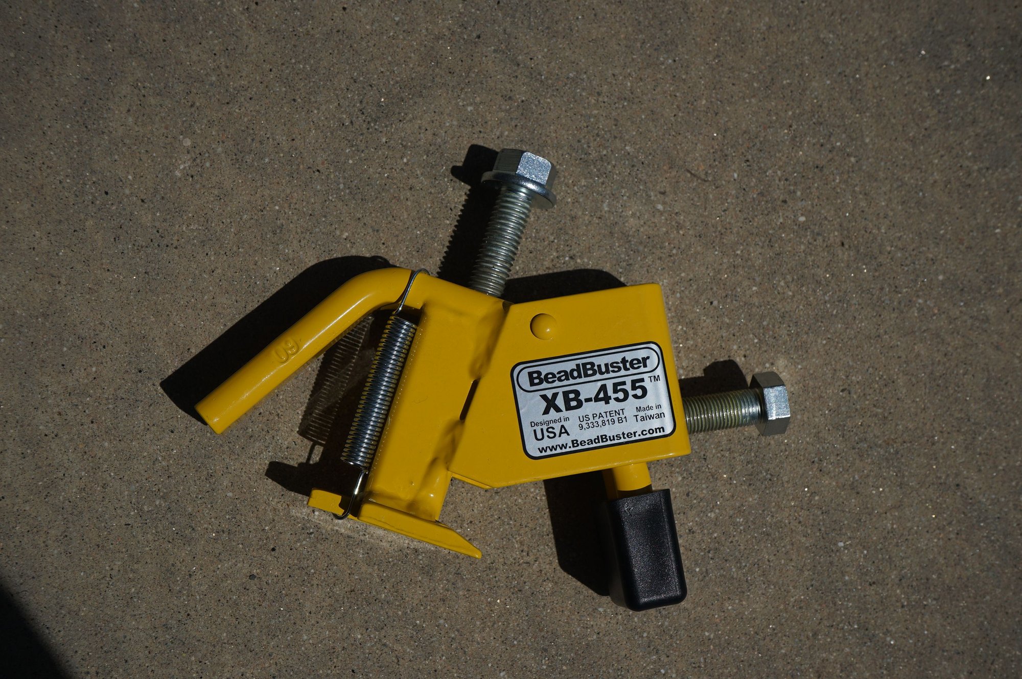

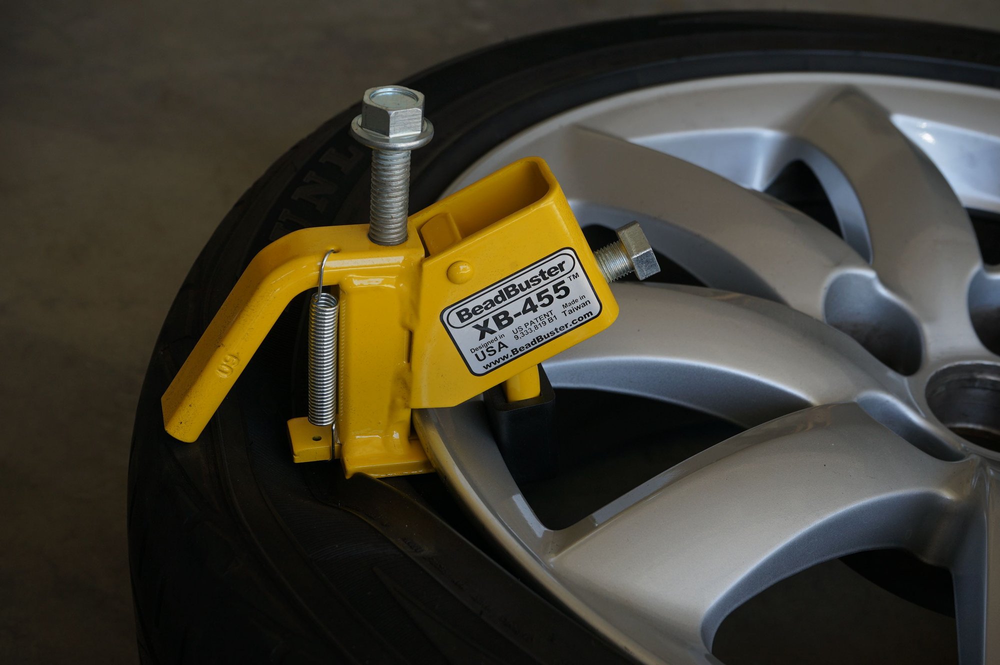

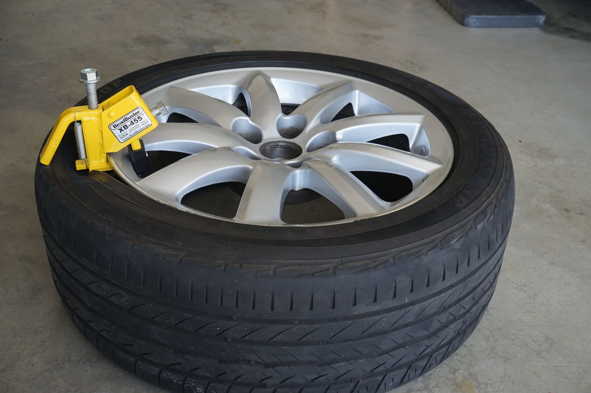

My second no-name TPMS sensor lasted only 7 months and 5 days. Its battery died today. In contrast, my first no-name TPMS sensor lasted 14 months, twice the lifespan than the second no-name TPMS sensor. I definitely don't recommend these no-name TPMS sensors on eBay. They work and can be registered in the ECU with Techstream in the exact the same way as OE TPMS sensors, but their batteries just don't last long. So, I replaced the battery-exhausted no-name TPMS sensor today. On the positive side, I found an easy-to-use tire bead break tool, "BeadBuster" (photos below). This small hand tool allowed me to break the tire bead in just a few minutes with minimum effort. The expression "piece of cake" came to mind while I was using it to break my tire bead. It was safe to use as well, as compared to pressing the tire against the rear frame of my GX460. I highly recommend it to DIYers for swiftly and safely breaking the tire bead.

Glad you were able to sort this out. On Amazon, that device is $100. It's also light duty, I'd buy the proper one at $159. A great device for the dedicated DIY owner. This is also a great cautionary tale of buying Chinese parts, having them perform poorly and having to do the job twice and spend more money than buying quality parts initially. Cutting corners isn't always a financially smart strategy. Not just TPMS but many parts. I hope that newer members get to read this thread.

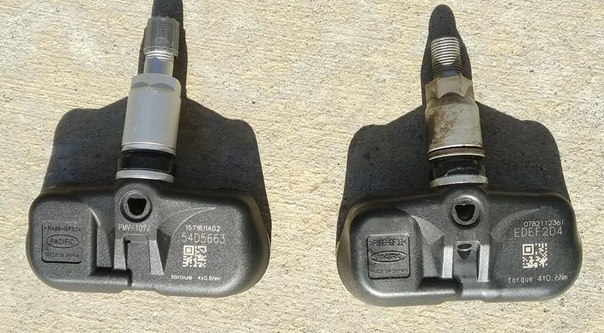

I decided to gamble a little bit and went with a seller of no-name TPMS sensors on eBay, who had very high ratings and received a lot of positive feedback. The seller guarantees the battery life of his TPMS sensors to be at least five years. This eBay seller’s TPMS sensors for LS460/600 have an almost identical look of the original Lexus/Toyota TPMS sensors. I bought a set of 4 TPMS sensors from this eBay seller for $45, including sale tax and shipping. Below is a photo of the new no-name TPMS sensor on the left and the Lexus original TPMS sensor on the right:
how have your TPMS sensors been holding up?
