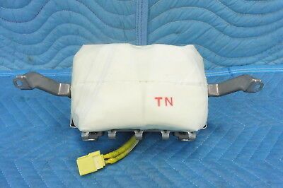

Question....Does anyone know which color wires that goes to connector in back the head unit that controls the front passenger seat airbag? I will attack a picture of it circled of the connector im taking about. Please if anyone know any info or have the wiring schematics could help....i just installed a after market android radio unit and im getting a srs airbag warning light. I need to find out which color wires are for the srs airbag so i can add a resistor so it can temporarily turn off the srs airbag warning light on my dash

thank you so much but im little confused..i just want to make sure. So 1, 2 and 3 is for the passenger airbag off/on sensor right?

Can you also check for me where is the front passenger dash harness goes to? Does it go straight to the center console airbag ecu or does somehow connects with the passenger seat airbag harnesses underneath the seat?
Looks like a lot of the SRS goes thru the center. Hope these help you....

thanks for all the help i really appreciate it but man im little confused looking this lol.
I guess ill just do one at a time..ima start off with the yellow plug under the passenger seat and im going to add a resistor and see if the srs light will go away.
