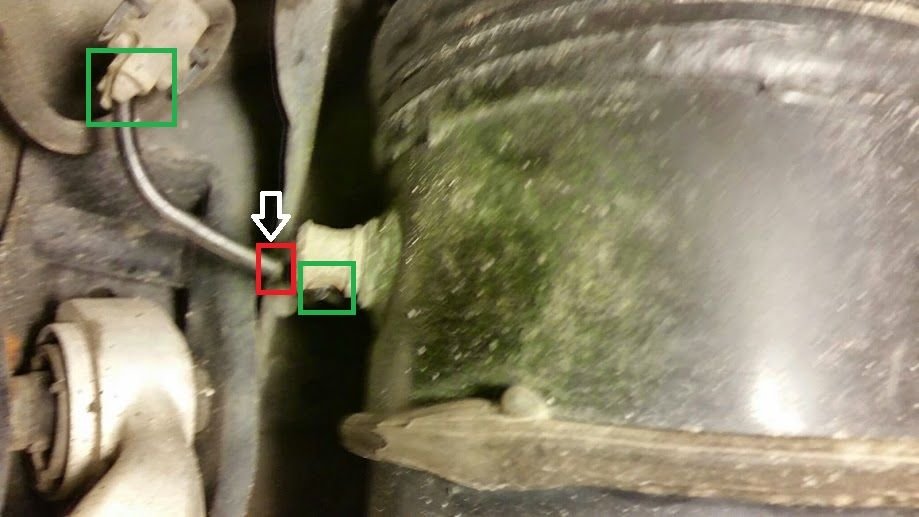

I believe, the lower part of rear struts needs to be tighten under vehicle load. The only parts I had to remove on my LS460 were rear sway bar links, brake hose mount and ABS sensor wire mount. It was just enough room to remove the rear struts. Front ones are easier in that way but there are other obstacles.
I only was able to find this blurry image. You can barely see (red square) a wider section of the tubing allowing the tube to be locked in place. The right green square highlights locking mechanism and and the left green square shows the clip that allows release of the locking mechanism when aligned correctly.

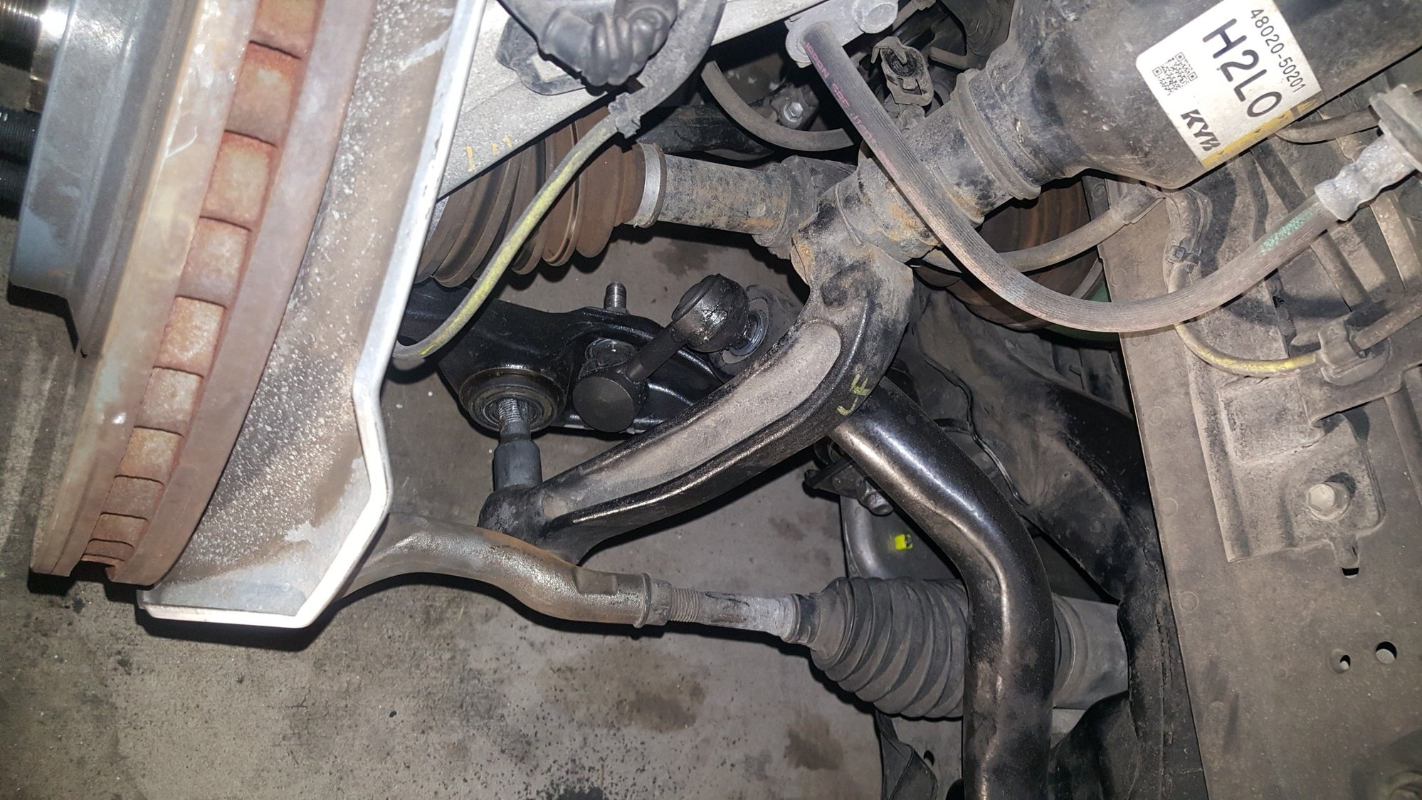

Thank you all for the help. I finished swapping out the front struts yesterday. There was some fighting and a few choice words on the first one. The second one while installing the strut I forgot the jack was still holding the knuckle up an inch. For a few minutes I couldn't figure out why the knuckle wouldn't move lower while hanging on it.
The clips on both air lines were easy to remove. The airline on the right came out with a very slight tug. I was only checking to see how snug it was. The left airline I used the fuel line tool trick. Both times the PSHTTTTTTTTTT of the air releasing startled me lol.
In order to remove them I disconnected the steering rod from the knuckle. I also removed the bolts holding the brake and abs sensor wire. On the way out the fat strut got stuck between the upper part of the knuckle and the cars frame. I used a jack to raise the steering knuckle a few inches, this opened up the area where the strut was stuck by 1/4" or so. Then it slid out.
I struggled a bit getting the strut into the lower control arm. Removing one of the upper control arms from the knuckle let the steering knuckle drop another inch. Then it slid in.

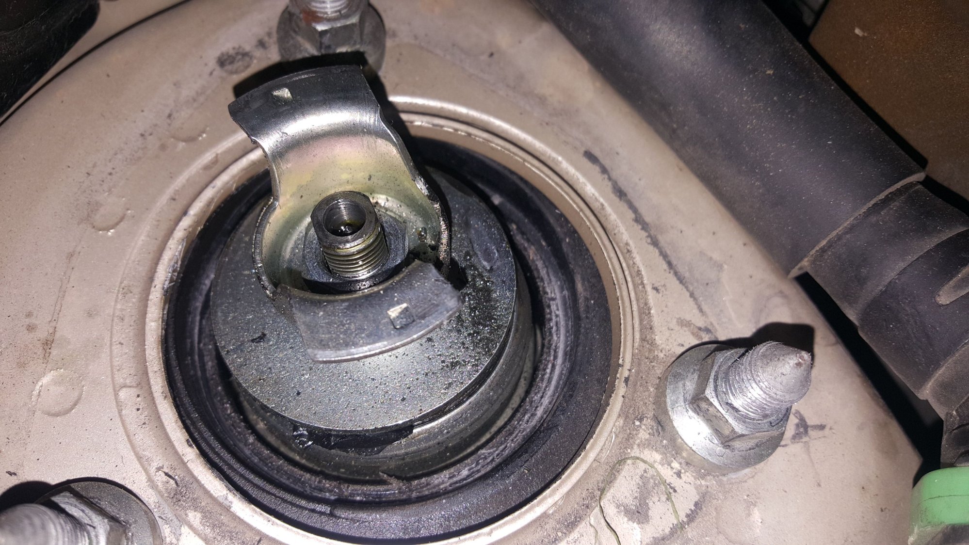

The strut actuator solenoid on the top of the right strut was missing the metal brackets that hold it to the strut. I ordered a new one. (Now both fronts will have new struts and actuator solenoids) Someone or a group of people really did a hack job on this car.
The left strut once removed was easy to diagnose as bad. The top mount bearing is shot. It is not smooth at all when rotated. Upon closer inspection I noticed the yellow writing on it. Pretty clear it was a second hand unit, maybe from a junk yard. The right strut while a little leaky (oil residue) is still functional.

Steering tie rod was in the way.
Anfanger luckily this piece has an alignment flange on it. It's not adjustable. I reapplied red loctite to both strut bolts. I wish these had safety wire bolt heads or a cotter pin to install. I can see a lot of issues arise if this bolt came out.

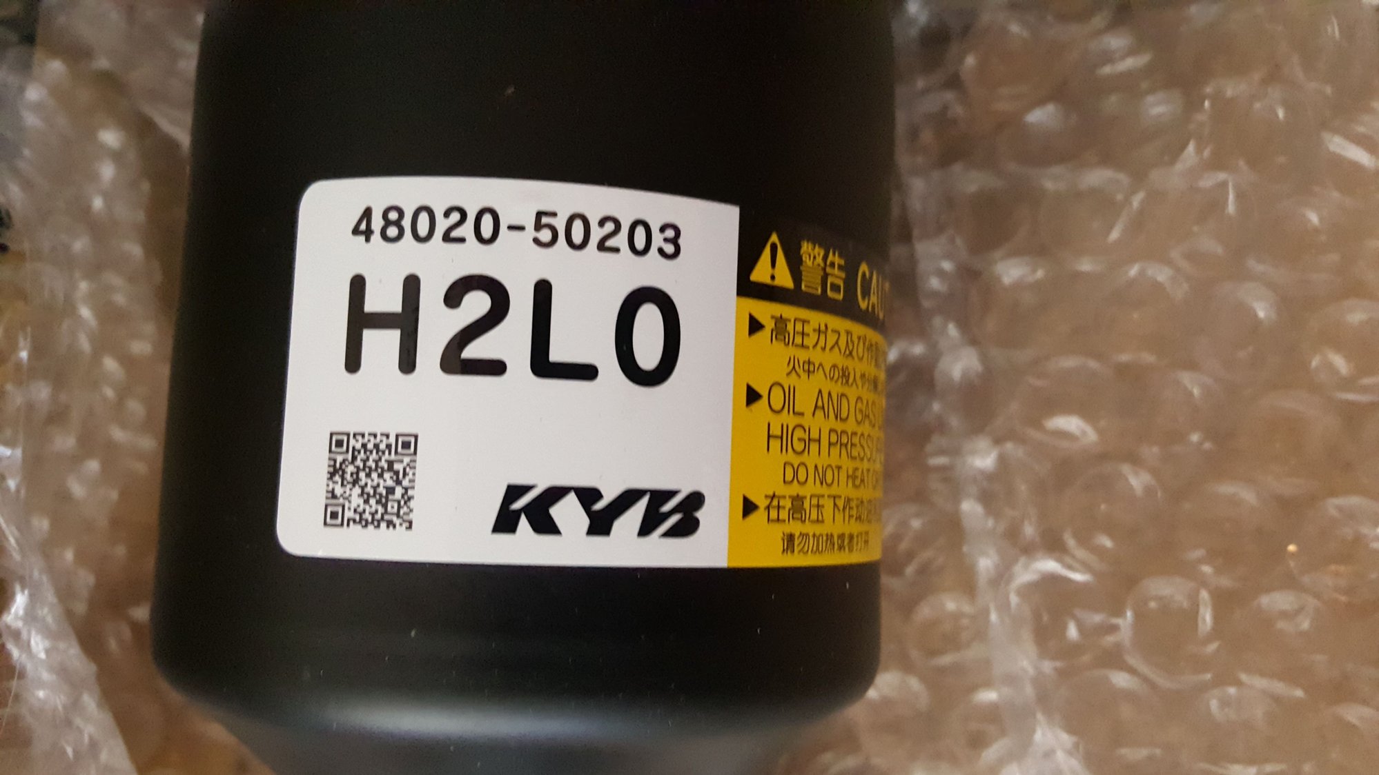

Yellow writing on bad left strut.
I cleaned my intake and maf sensors while the hood was up. TB was pretty nasty.
The new struts came with markings on them. Pink on this one. The markings point out.
Yellow on this one. The markings point out. They are not symmetrical. The strut does not hang correctly if the yellow/pink is not pointed out.

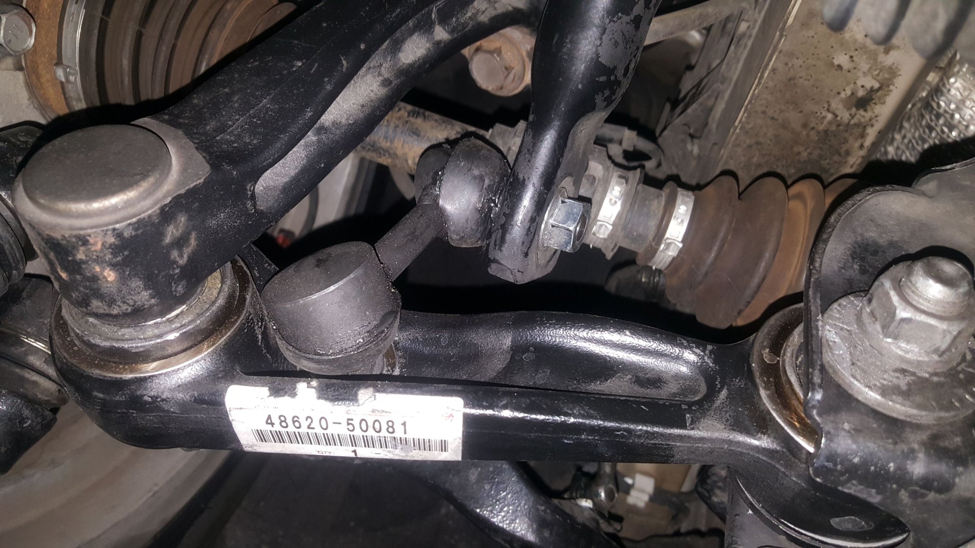

Another question.... What is the correct way to install sway bar end links? I figured they just bolt on. However after driving around 50 miles I noticed one looks funny.
The one on the right is at a funny angle. The left one looks normal to me.
Another issue is the end links I installed came loose and started to rattle. It is very possible I didn't tighten them enough to begin with. One thing I noticed about these elcheapo ones is the ball joints in them are extremely tight. Before installing them they were so stiff I couldn't pivot them.
I cranked down the end link nuts even tighter. Hopefully they stay tight this time. If they start to rattle again I will switch to oem or at least a better brand. Currently the car noise level is almost on par with our 460. I still have some wind noise issues from the drivers door to address. If I can get those sorted out I'll be happy. The constant whistle while I drive is a not so subtle reminder I have more work to do.
Right side, at a funny angle. Strut unbolted.
Left side straight.
Right side funny angle. Strut mounted.

It looks to me that you need to rotate the links to reduce the angle.
What torque did you use?

I didn't use my torque wrench on those. First time around I used a standard wrench until it hurt
The second time on the top I used 2 wrenches doubled up and hung on it. The nuts on the control arm I zipped down. Their hella tight now.
