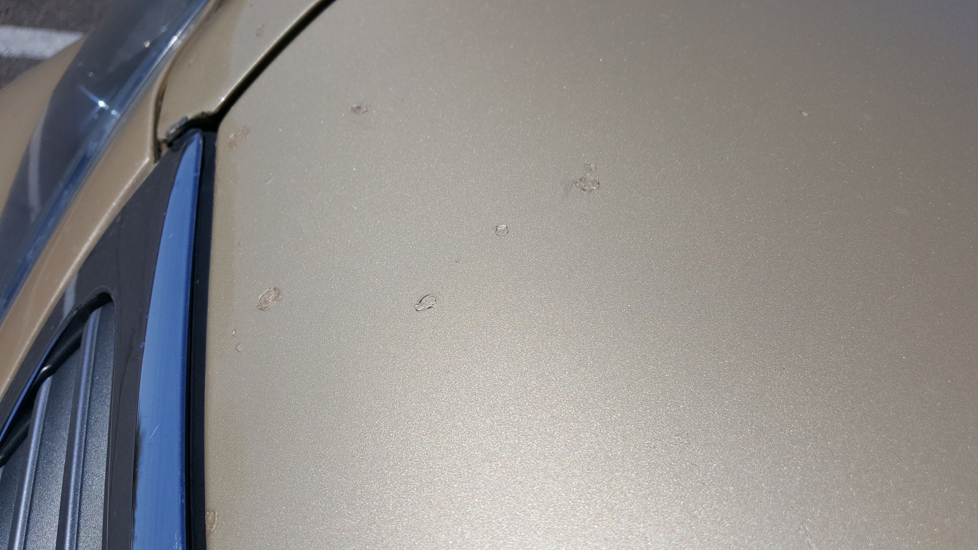

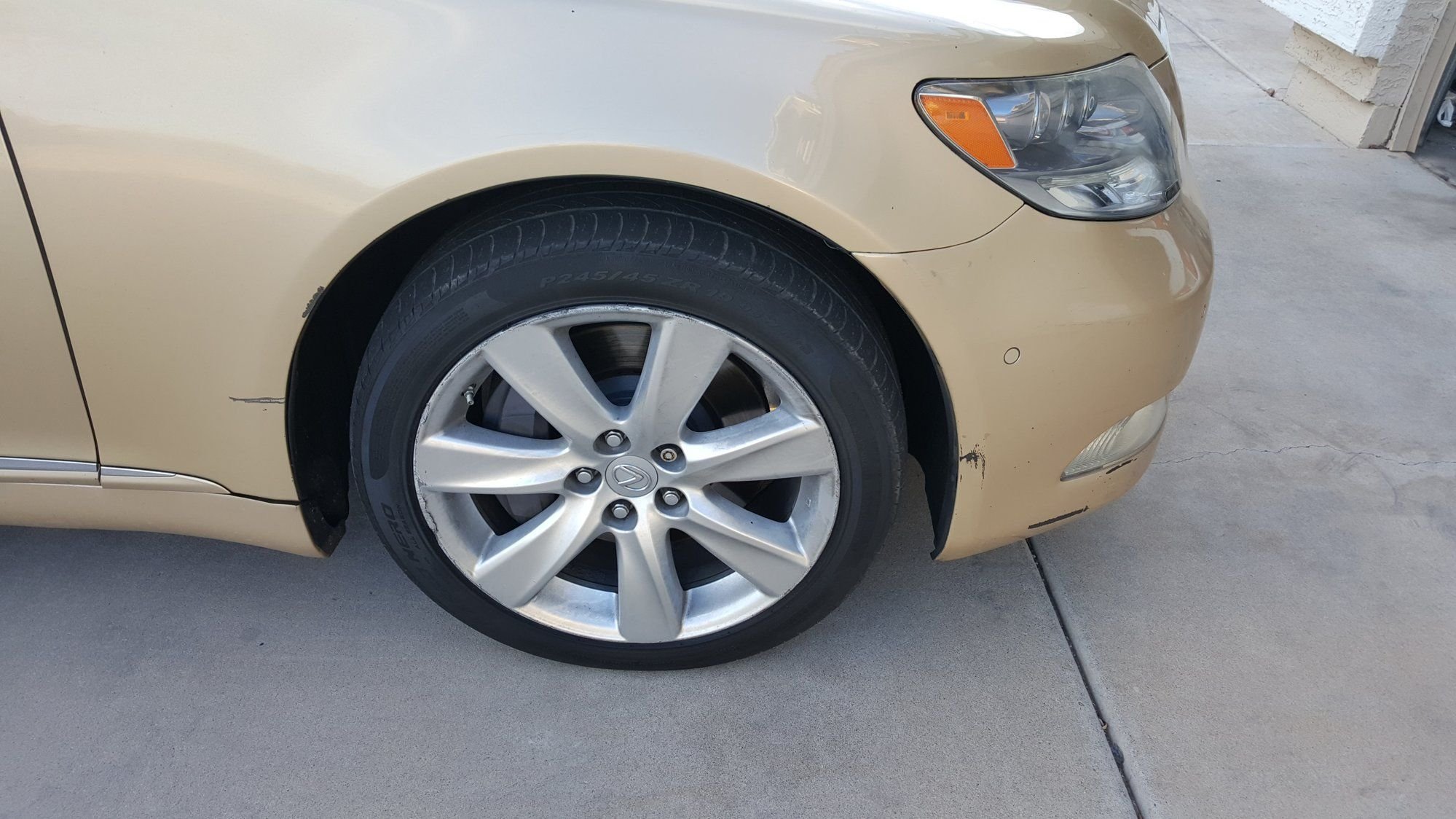

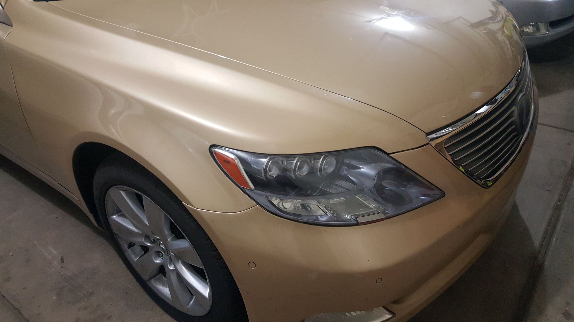

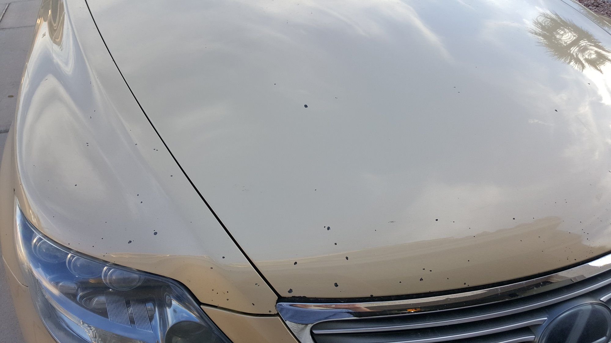

I'd still like to paint it white some day. Until then I thought I'd touch up the buck shot / rock chips
I bought a lexus touch up paint pen and a $19 aftermarket kit on ebay. The lexus pen had the base paint premixed with the clear. The ebay kit came with a base coat and separate clear coat. Both seemed to be a perfect match. With the lexus paint pen the clear kept separating when applied. I couldn't get consistent results with the paint in the pen. I ended up using the aftermarket base paint to fill in all the chips. I have not put on the clear coat yet. I wonder if I don't add the clear coat if the chips will change color over time? I'm happy with how it turned out and less embarrassed to drive it around. Wifey said it looks 100 percent better.
https://www.ebay.com/itm/Genuine-OEM...r=503480497908
https://www.ebay.com/itm/Genuine-Toy...c/401027284395
Here are some before and after pictures.

Looks great from afar. Do you have any close up pictures showing your touch up work? Were you able to get the recesses filled flush or are they still slightly lower than the OG paint?

Thanks. The only ones i filled even were the edge chips. I'll post some close ups in a bit. The majority are not pretty up close.

Damn, there must be hella stones on the road where this one came from. I'd say for a touch up pen, that's a pretty good result.

I agree that your result is very good for what you are working with. The eventual repaint to white will solve all of your problems.

Looks OK, that's really about the best you can do for touch up. Between my cars and my wife's cars I've tried all kinds of applicators, including toothpicks, which are good for tiny chips, and you can always spot them when close up.

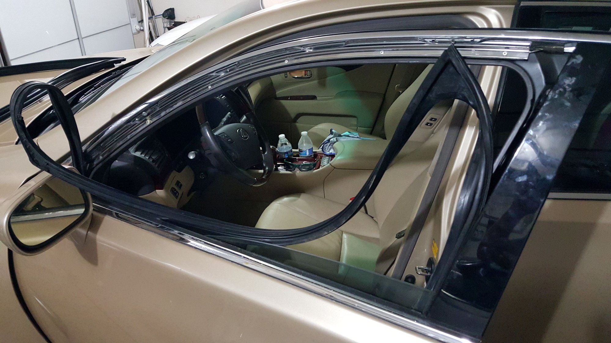

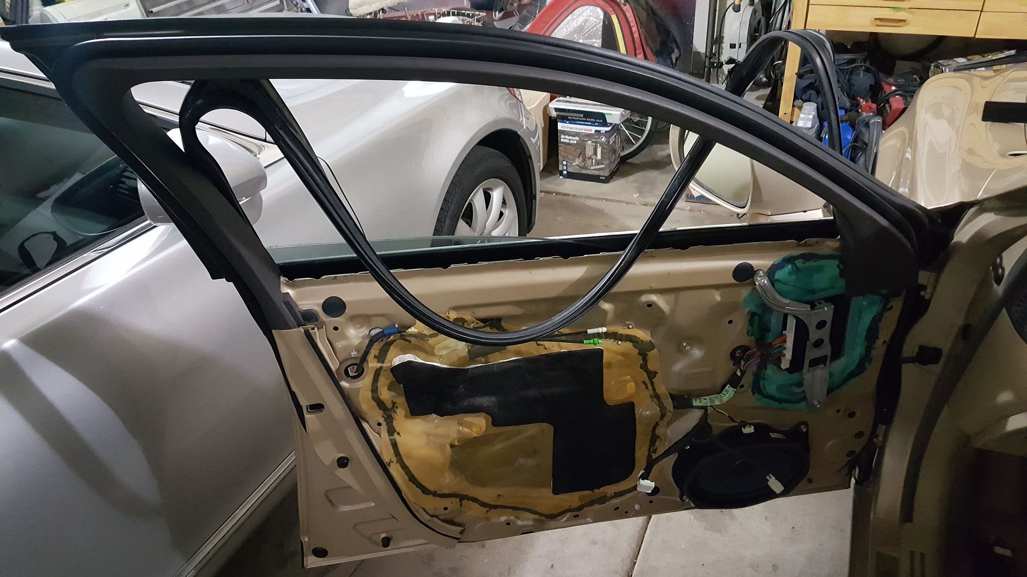

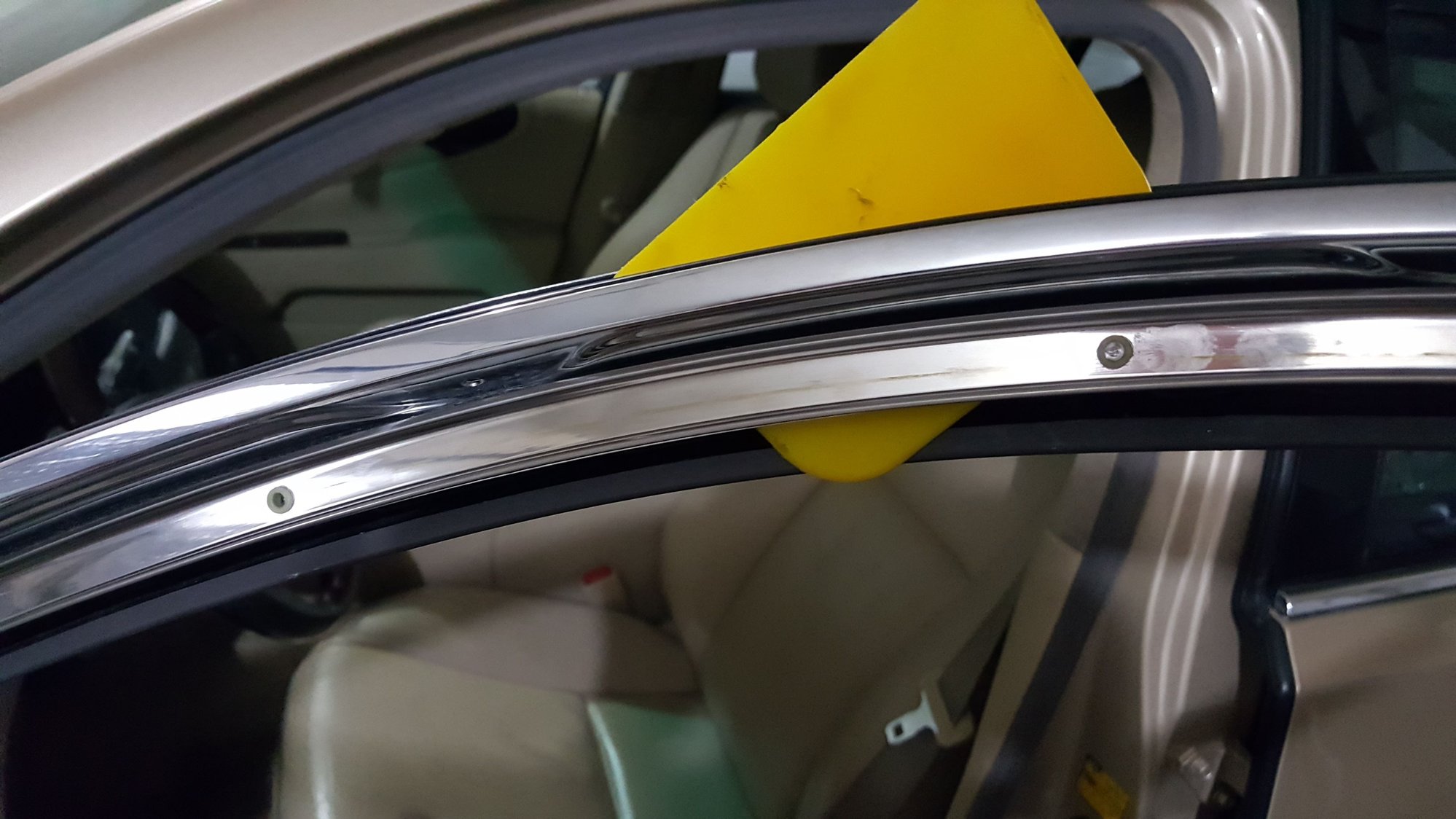

I fixed my window noise!

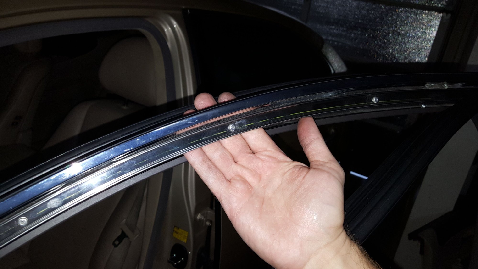

To my surprise all of the rivets on the top structure had pulled out. There is a tsb or something similar for wind noise which I believe incorporates doing this rivet replacement. The tsb has a large parts list $$$ (looks like every seal, screw, and rivet within the door) I believe the tsb also calls for removing the window glass. The original rivets are all too short.
It turns out the rivets can be replaced without completely removing the door seal. If you pull out the door seal on the upper frame of the door all the rivets can be accessed. The interior door panel doesn't even need to be removed.
My seal was damaged so I replaced my door seal along with all the rivets.
1. Lower window plus remove interior door panel.
2. Pull out window seal (it is that easy)
3. Feed new seal down into front window channel
4. Feed new seal down into rear window channel. To aid in lowering the window seal I hooked my door panel and window controls back up. If you have a helper raise the window up a few inches then lower the window while pushing the seal down it will follow the window down. I gave my wife specific instructions to push down on the window control switch to lower the window. She pulled up and the window pinched my fingers. So beware who you ask for help lol.
5. Getting the new seal into the upper frame of the door is the most time consuming part of the replacement. It probably took me 45 minutes to get it in. The seals have a lot of folds. Each has to be inserted into the right spot or the seal doesn't attach. I found it frustrating.

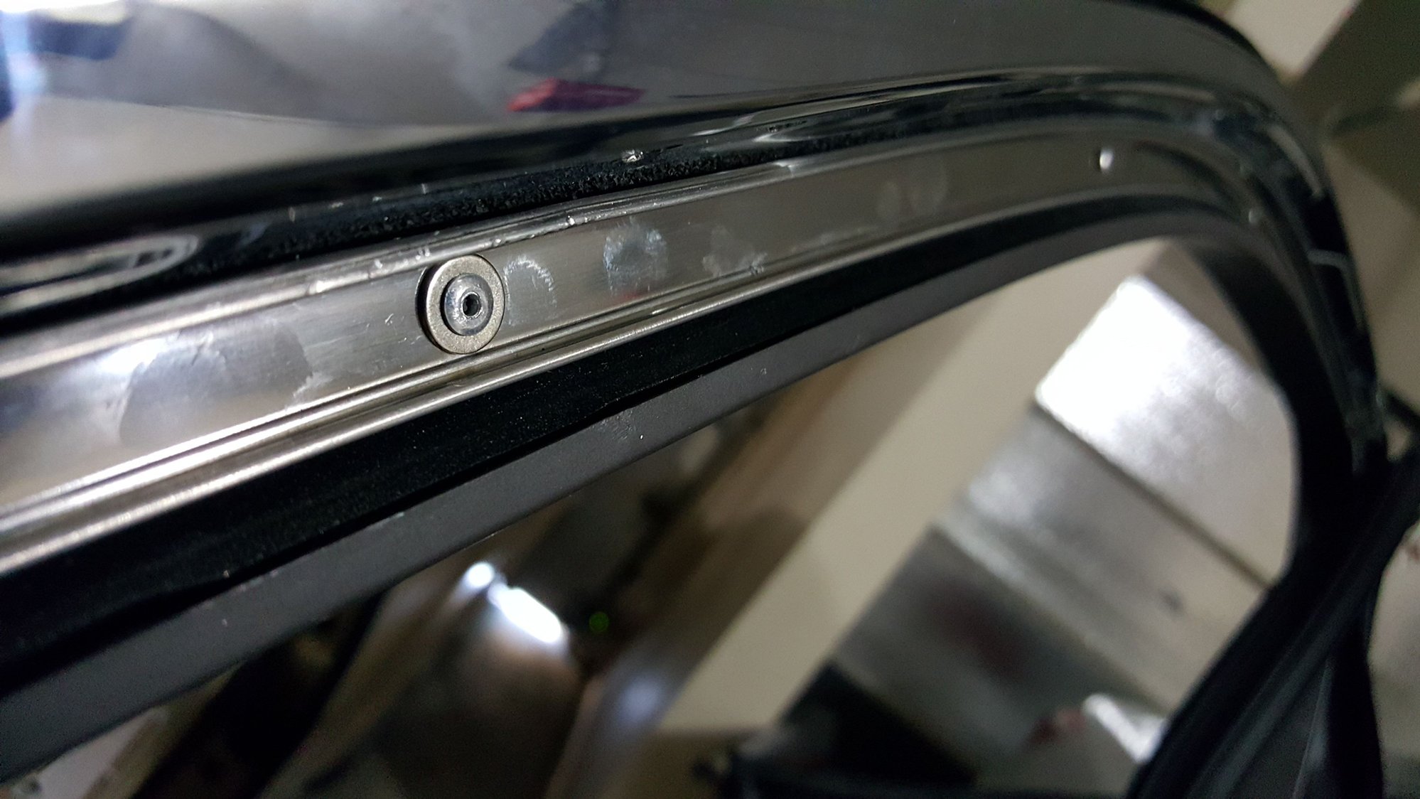

Rivet repair...
I believe I used the 1/8" x 3/8" rivets. The 5/8" were a touch too long.
A. Drill out rivets. This is easy if they have all pulled out of the channel like in my case.
B.. Insert all 5 or so rivets before squeezing them.
C Use the rivet gun to push them all the way in to their holes, takes some force.
D. Once they are all pushed in then start to pop each rivet. I used a harbor freight pop rivet tool / gun.
The drill eraser removed the sticky mess behind the plastic triangle wind deflector.
New window seal
All cleaned up.
Feed the seal into the front of the door first.
This is my real wind noise issue. There is not supposed to be a gap here.
You can see all the rivets are still in place. However they have all pulled out of the main door frame.
The rivet holes have a plastic liner. Try not to damage these.
I used a metal washer in a few places where the plastic liners were missing.
Added more goop in the door to reduce rattle.
