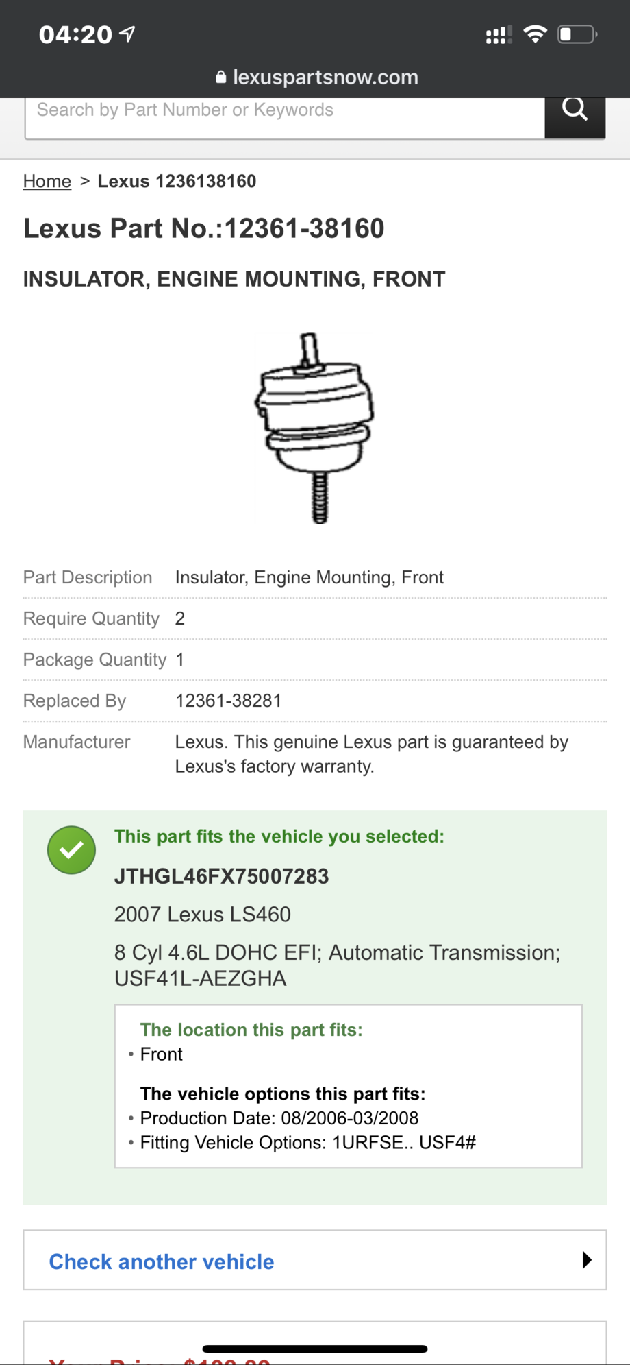

I have a 07 and it’s time to change engine mounts. 07-08 they have a one part number 12361-38281 which they say isn’t interchangeable for the part that goes from 09-16.12361-38221. They look similar what’s the difference do you think? Won’t they fit ? Toyota says it won’t but we all know that might not.be true.

the original part number was 12361-38160 the upgraded part number is what I listed, if it was a simple matter they would have updated the part number to the same as the 09s, but they clearly chose not to in their systems for whatever nefarious reasons. Which is why I posted to ask for opinions.
