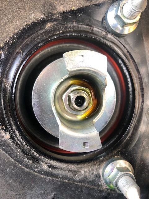

YO!!! We have a discovery
I took apart the actuators I had access to under hood and tested they were both reporting a 12. with multimeter
There was OIL in top of passenger side front shock when I took out the actuator. Think I saw on another thread this is the sign of a bad shock.
Is this True?
Thanks

Yes, leaking oil struts need to be replaced. Are you positive it is coming from the shock?

When I took off the actuator test the top of the shock is full of oil including on the actuator.

12-18 ohm means the actuators are within spec but oil underneath probably means the dampers are bad even if the shock still hold air. I would clean the oil up and drive for a bit then check them again before I commit to new shock's. I noticed that if you turn the little tube inside the shock when trying to line up the actuator that oil comes out. I'm guessing this is the reason they state in the manual not to turn it more than 40° when uninstalling the actuator.

The dampers are part of the shock but the actuators are what control the dampening. Lots of ppl just focus on if the air bag on the shock is holding air but even if it is but it's not dampening properly then the shock is no good. Oil on the top of the shock is a sign that the damper is no good.
Originally Posted by derreckla
Drive them a bit even though they are fully extended don't budge stiff AF
I haven't done anything except clean up a tiny bit of oil in a reservoir. How is this going to make the shock work?
Thanks
I just wanted to make sure that you did not accidentally release oil on top of the shock when you were putting the actuator back on. I released a tiny amount of oil when I was trying to line the actuator back up with the pin inside of the shock.
