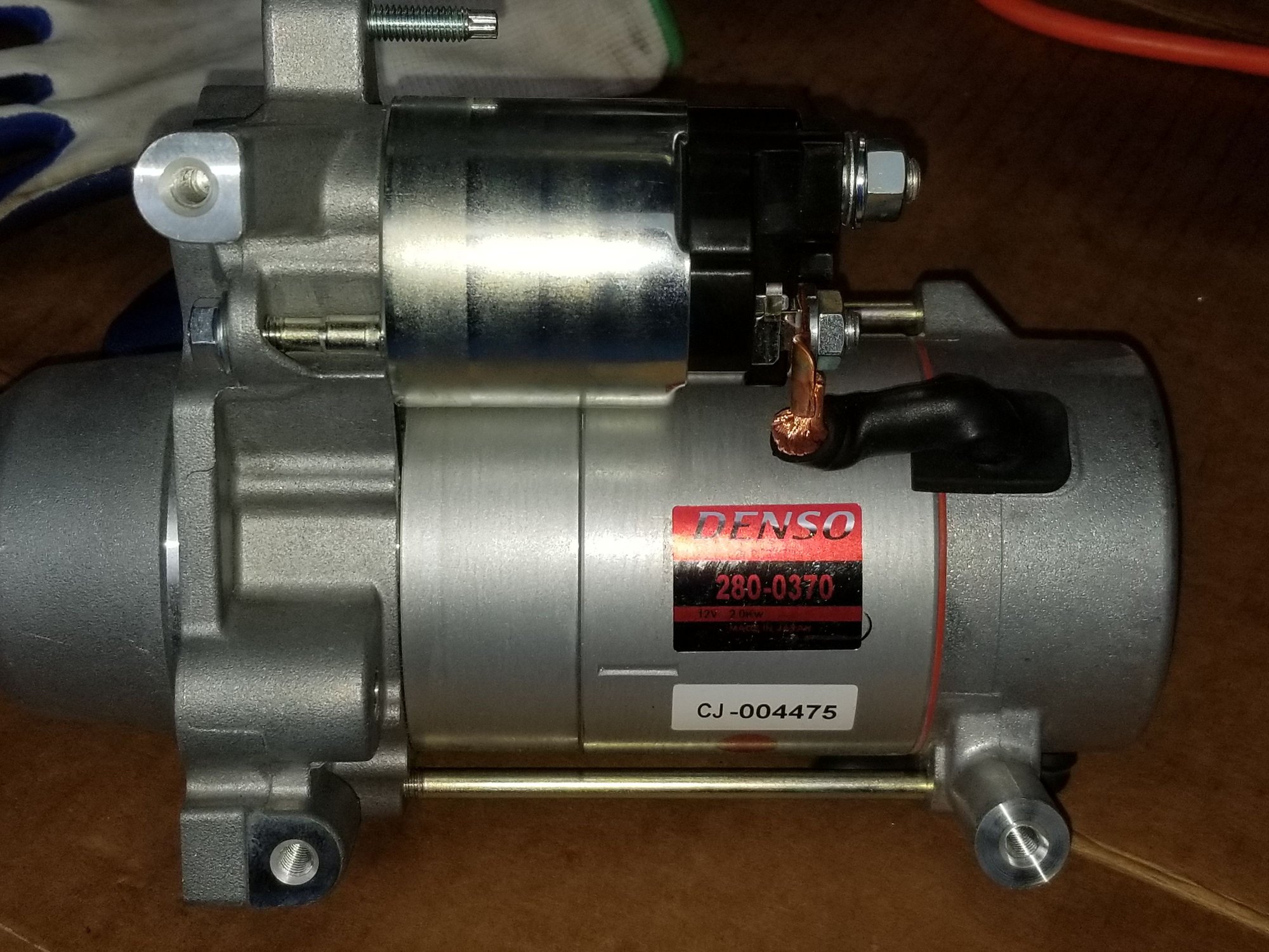

Sometimes starters go out with no warning but mine was showing signs which I promptly ignored. That same day I went online to rockauto and ordered a Denso Reman starter. $207 with a $68 core charge included. Came to about $139 after I returned the old starter.

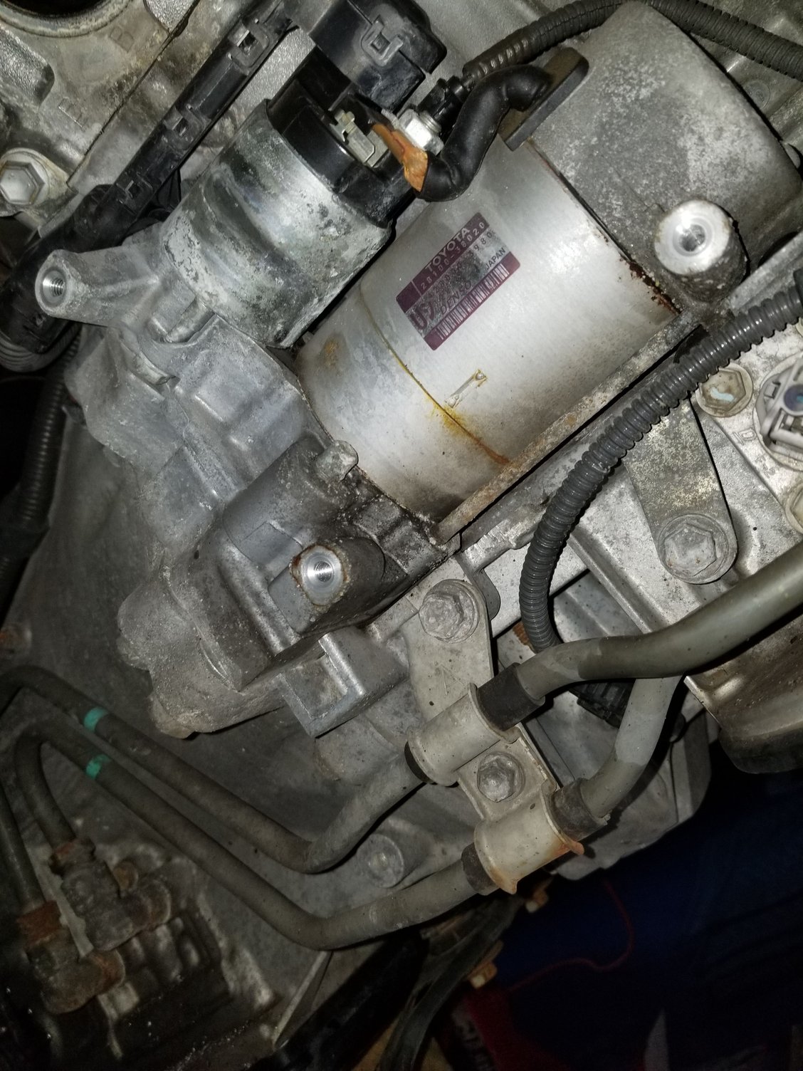

Next I removed the front suspension member and oil dipstick then proceeded to remove the engine mount and bracket. The top mount nut was surprisingly easy to break loose as well as the bottom nut. I then started to get the bracket bolts out when I ran into my first head scratcher. I was using the pdf mainly at this time and removed the first 5 bolts but could not comfortably get to that last bolt that’s right behind the alternator. I tried all kinds of angles and the closest I could get to it was going over the alternator which was starting to feel like too much work for 1 bolt. By this time I was worn out from getting up then down, twisting all over the place and not having much success. I could get the socket on it but for some reason it just would not turn much. Later after I removed the alternator and the bolt still would not come out I realized that I had jacked the transmission and engine up slightly in anticipation of removing the mount. This caused the engine and mount bracket to be off center and producing a lot of resistance. Once I leveled everything up the bolt came out but was slightly bent at the tip. This little mistake caused me to lose the rest of the first day and part of the second morning. So you probably don’t need to remove the alternator but if you do it just creates so much more space and visibility.

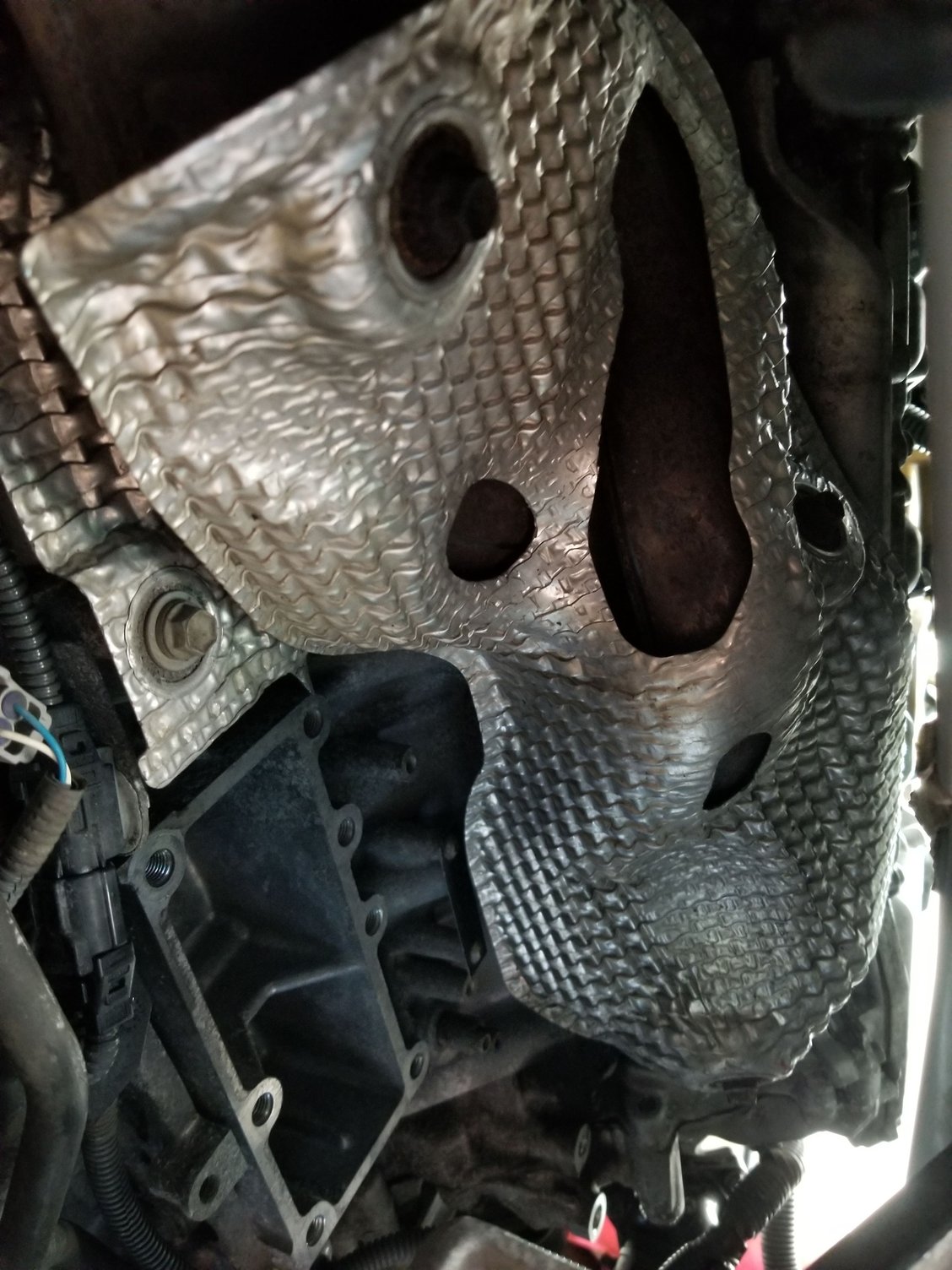

Next I removed the exhaust manifold heat shield. The top 2 bolts were a no problem but the bottom bolt was so rusted that it no longer held it’s 10mm shape. Cutting is a last resort for me since I want everything to go back on the way it came off. I sprayed plenty of PB blaster and tried all sort of socket and wrench combinations but I did not have enough room in there to get a good grip on the bolt. I ended up slicing through the heat shield as close to the bolt as possible and pulling it up over the bolt. I would later cut off the bolt head and unscrew the remainder out from the backside. When reinstalling I just used another bolt with a washer to clamp down on the shield. Now it was time to remove the exhaust manifold and this is where removing the alternator really helps. It gives you access to visually see the bolts at the top of the manifold as well as being able hold it with both hands when reinstalling it. The thing can get heavy when your on your back trying to wiggle it back up in there.

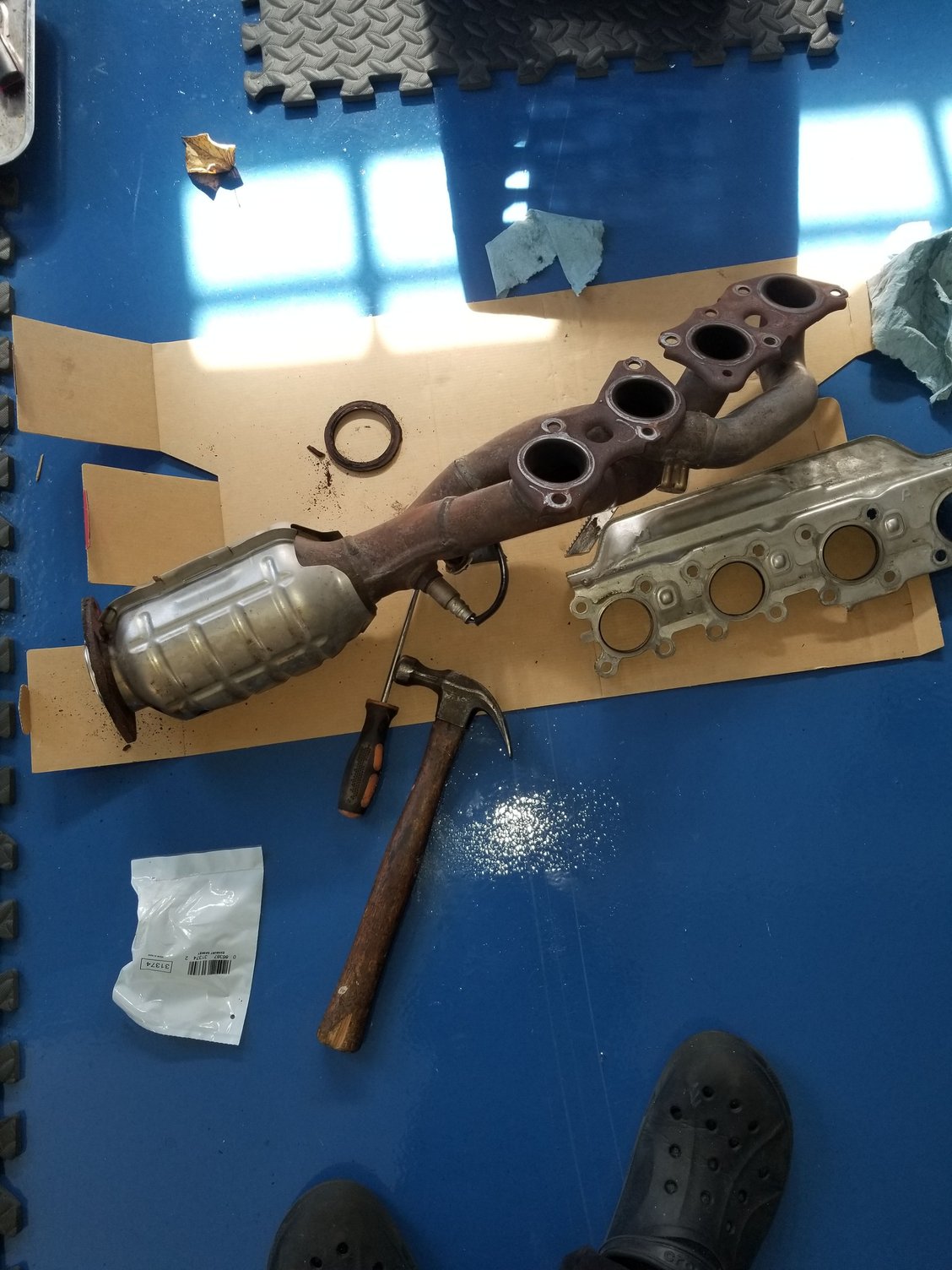

After getting the manifold bolts out the REAL issue roared it’s head. The flange bolts were rusted and the nuts had welded themselves onto the bolt. I lost a 1 ½ days before I finally cut them off. I had been soaking them down for 2 days already plus EVERYTIME I got on my back I sprayed them again throughout the whole process. I was able to break the bolt loose but the nut would not budge. The next day I broke out broke out my MAP gas torch, I just bypassed to propane altogether and played with the ideal that it might work but I knew better. After a couple hours I started to look for affordable Oxygen/Acetylene torch but could not find any that I could get ASAP plus I never used one before and did not know what kind of learning curve I was going to need. This is when I picked up my M12 Sawzall and went to work. Surprisingly it started to cut the bolt head with the crappy blade that comes with it. That’s when I knew I would definitely be able to finish the job. I went to HD and picked up some Diablo blades as well as a bigger Milwaukee reciprocating saw just in case. Needless to say I got those bolts off and learned a lot in the process.

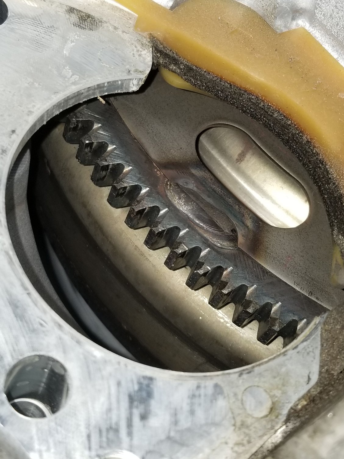

finally........
I'm wondering if these marks on the flywheel present a problem or are just a part of the manufacturing process.

Originally Posted by sha4000
finally........
My 2008 LS460 starter was dead at only 95,126 miles. I replaced it with the same Denso 280-0370 starter from RockAuto. Fortunately, I'm in California and there was no rust underneath the car. In fact, everything on the car still looked new. I was able to remove all the screws and bolts without an issue. It took me about six hours to complete the job on my driveway with jacks and jack stands. Looking back, the only regret I have is that I should have replaced the engine mount. However, at the time, my engine mount looked new and no damage.
