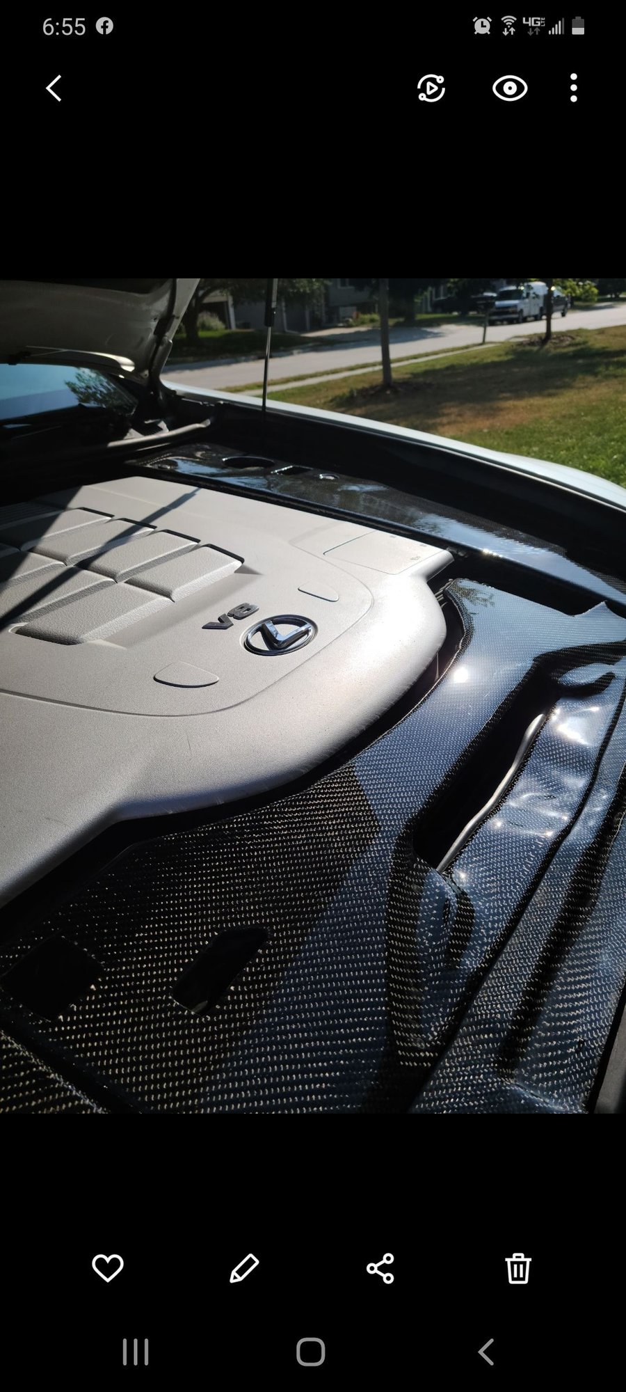

Default I decided to skin mine with carbon. Yours look great, I don't like the plain black.

Originally Posted by Joshua1983
what do you mean by skin ? Like vinyl ? Thanks

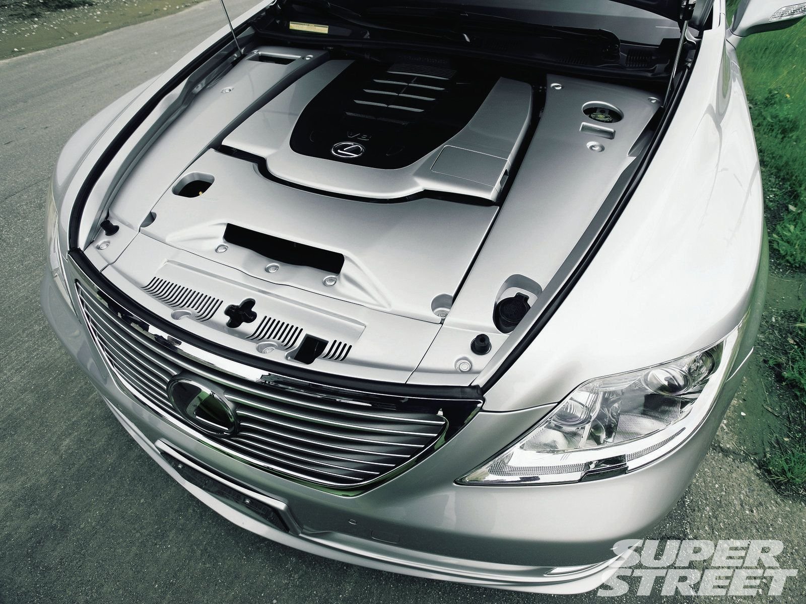

I think that's excellent, great added presentation too.
I so happened to run across this photo looking for wheels for a silver LS

That 2-Tone engine cover looks really good. Not so sure about the rest of the covers looking the same shade as the car exterior though. Looks too bland, I mean even the cover fasteners are the same color as the covers/exterior.
