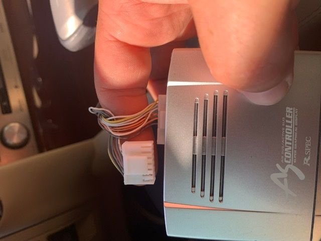

Aug 2, 2020 | 04:46 PM
So it looks to be data controller related. When the wires in picture are disconnected the ‘height high’ dash light turns off and button works again, and confirmed it as car rose about 1” all around when lit up. When I plug harness back in light comes on and button doesn’t work to turn it off and car raises 1”
any help appreciated...

Before this issue occurred and the Data System controller was operating properly, did the Height High light come on automatically at about 37mph? What adjustments did you make to the Data System? On mine, the Speed setting is kept at 0, I don't ever mess with it. The speed sensor wire from the nav system to the air suspension ECU counters/negates the automatic lowering feature, and the Height High light will come on when this is in effect. I'm thinking if this wire became disconnected, it might result in the issue you're having.
