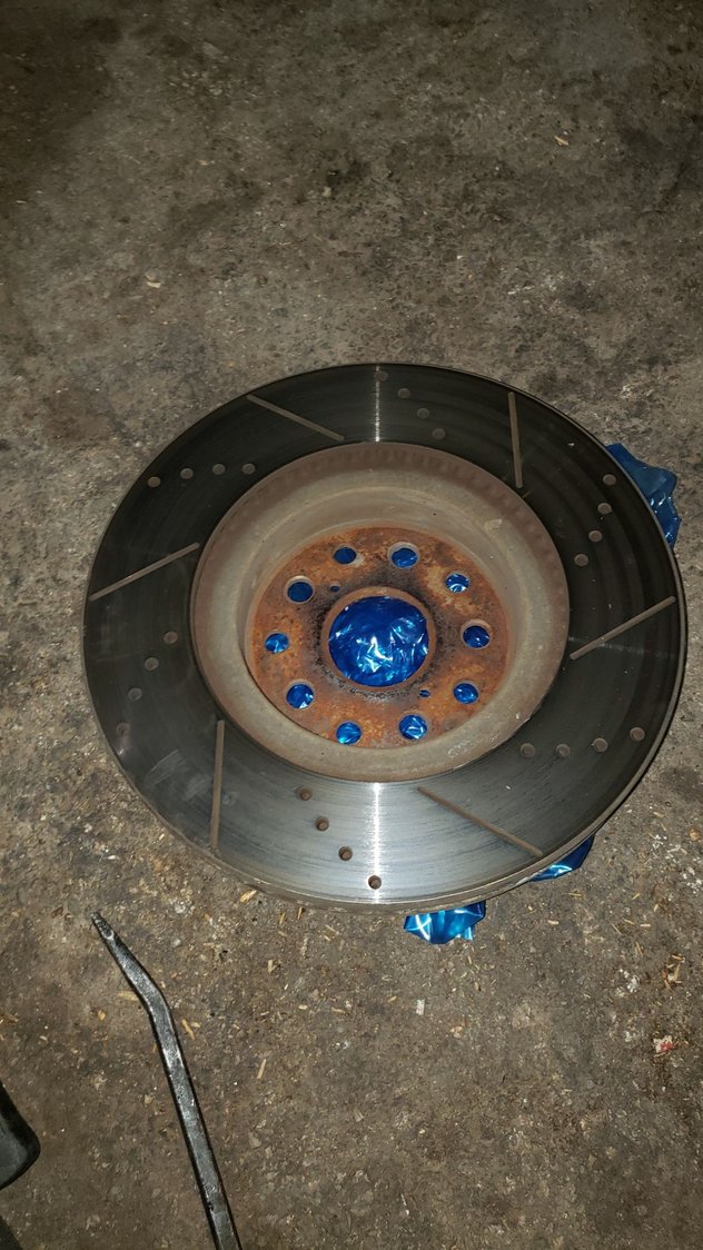

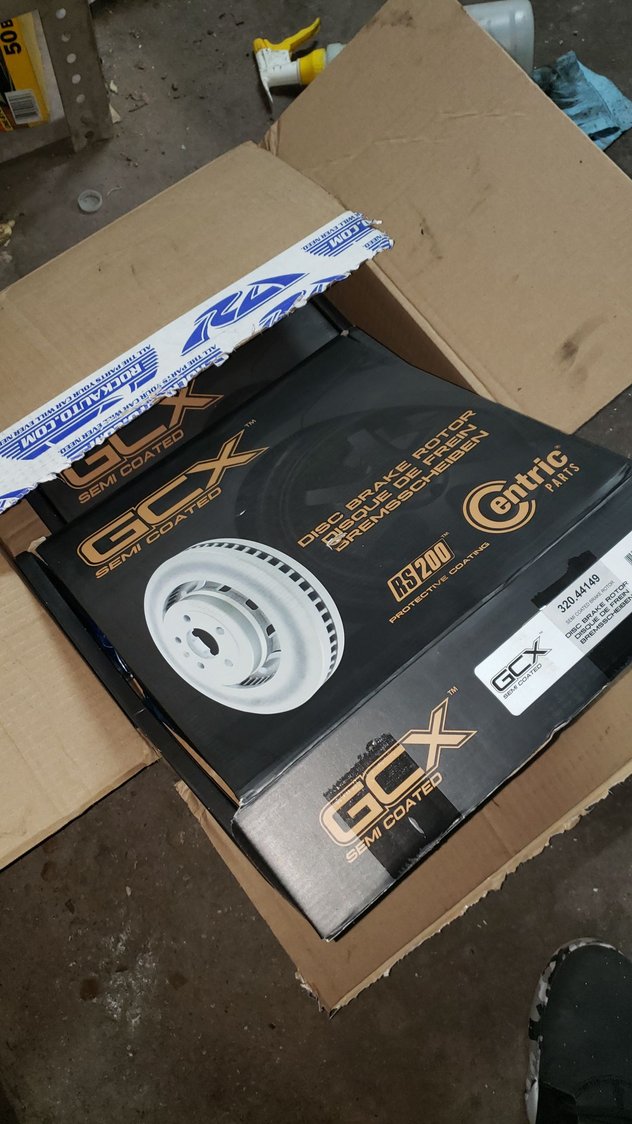

I finally got those garbage drilled slotted rotors off the car. I ordered the semi coated rotors from rockauto and had them put on. The shaking is gone but only time will tell if these are going to wrap.
These aren't even a year old and look really bad
These are the new Centrics
You can't see the coating on the rotors now. It is just a smooth silver color.
