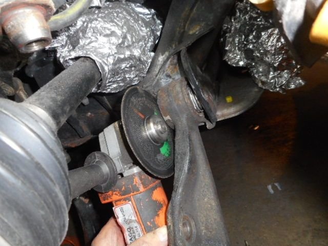

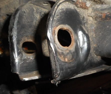

Sorry I'm late to the party...
Nerve racking but fast solution.
I then found this damage and that shiny spot was worn away.
And this was my fix... Arnie
