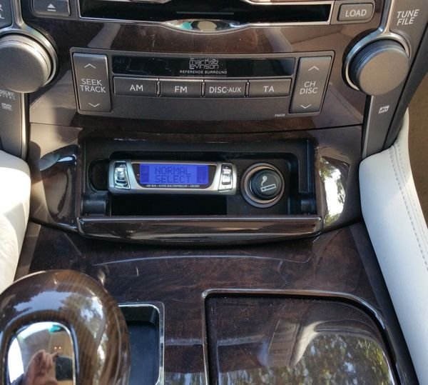

  1. Yes, all corners
  2. Yes, all corners
  3. There is a controller for that, the ASC680 air suspension controller. (search for ASC680 on this forum)
OEM, at high load the car will lift itself to normal height, at high speed the car will lower itself for better fuel consumption and stability. You can manipulate this with the ASC680.
This is mine and works great!
