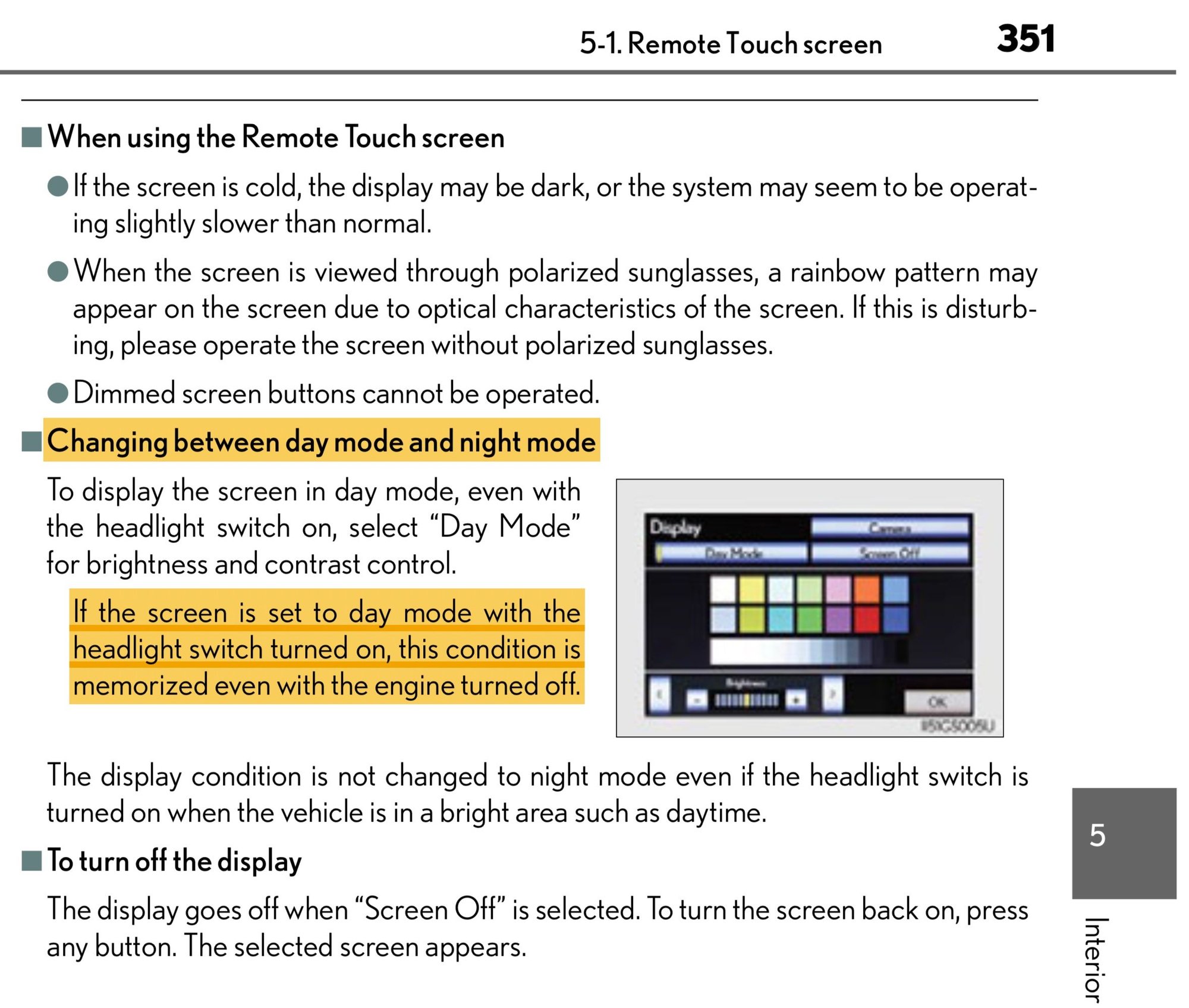

The light sensor is the dome-shaped thing at the front edge of the dashboard where it meets the windshield. It may be centered on the dashboard immediately ahead of the center speaker grille. Maybe it's gone bad.

That's odd. Do you mean the Day Mode option is grayed out? If you select the day mode, the display will not dim even at night and/or the headlights are turned on. Here are two images from the 2014 and 2015 manuals.
2014
2015

I doubt it’s the sensor. It’s probably day mode is turned on in the infotainment system.

Thank you for your replies, I can see the sensor, but it’s really close to the windshield. Not sure how it would be able to be taken out without removing the dash. And the day mode button doesn’t show up at all.
This is interesting. I would have thought the Day mode option would be available even if the car doesn't have Navigation (which is an option that some cars don't have). Does your car have Maps/Navigation? Please check your owner's manual. If it shows the Day Mode option, something is wrong with the software on your car, and Lexus should fix it.
