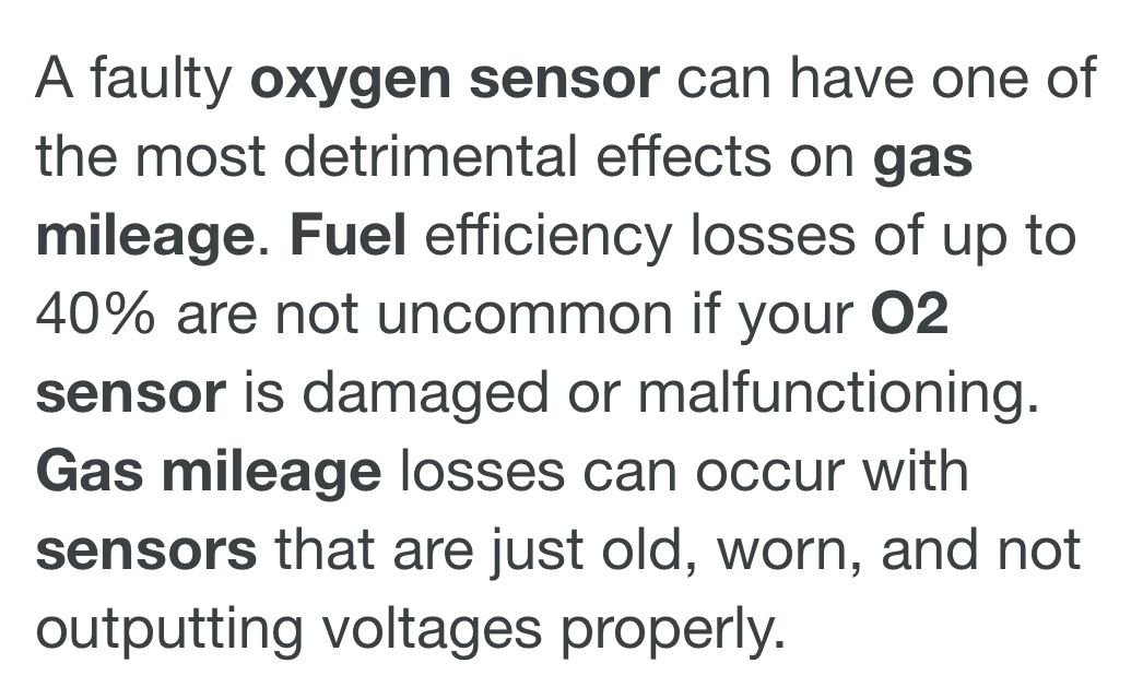

I'd have the O2 sensors checked. You didn't say how many miles are on it, but if they're high, you may have one or more becoming 'lazy', but not yet throwing a code. I've had that happen once, though not on either LS-L I've had (an '08 and '12).
