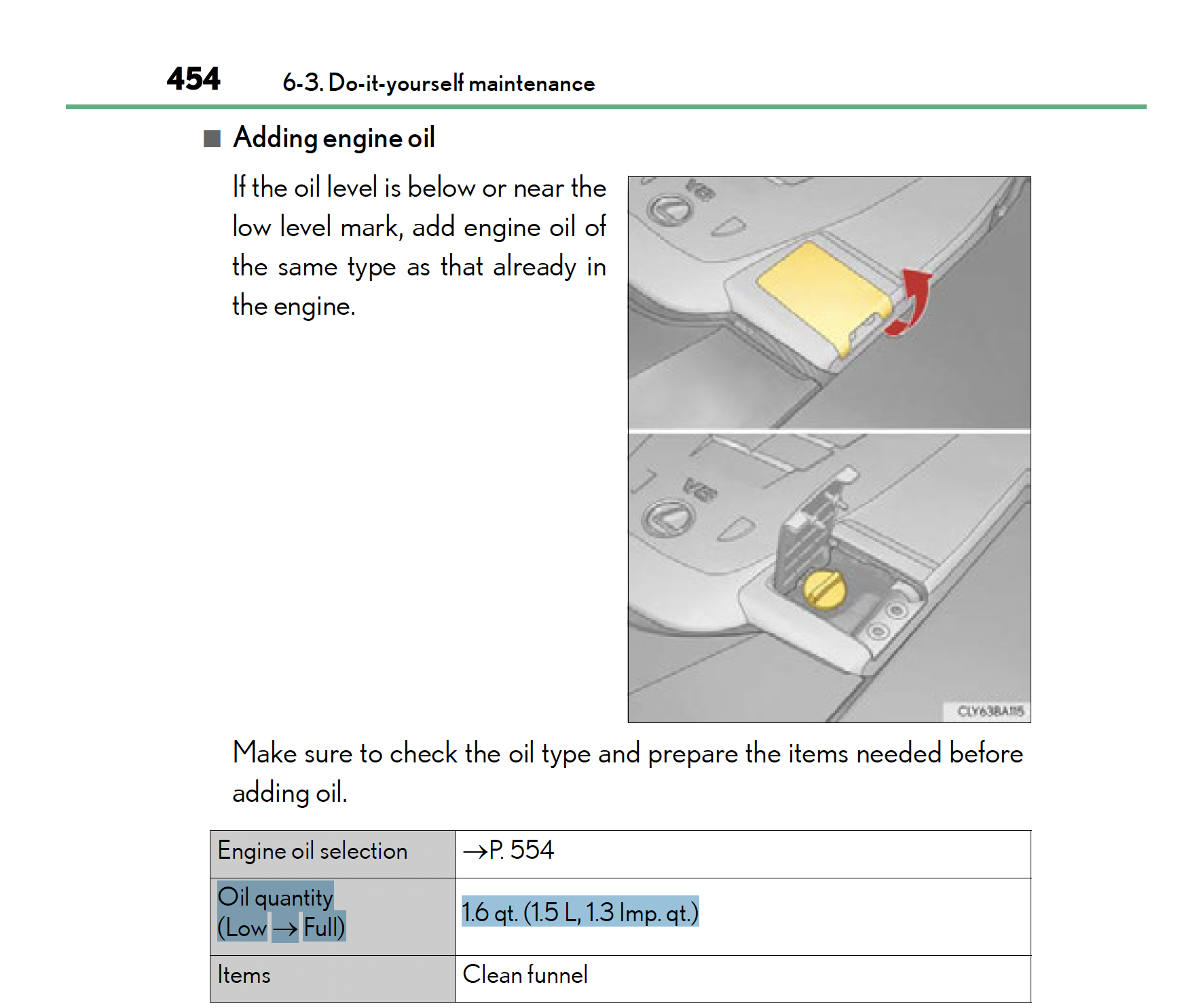

How much is the oil difference between high and low marks on the dipstick?
How do you exactly measure oil consumption in between oil changes?
Edit: Answering my own question. Found answer in the manual. It is 1.6 qt
