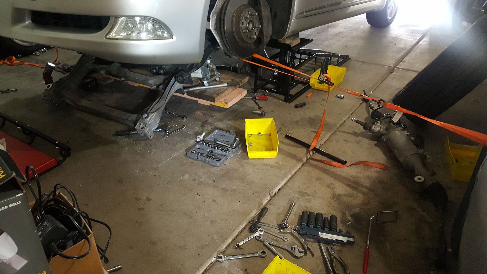

Sub frame is out. I used a transmission jack to move the sub frame back into place for reassembly. I still needed help.

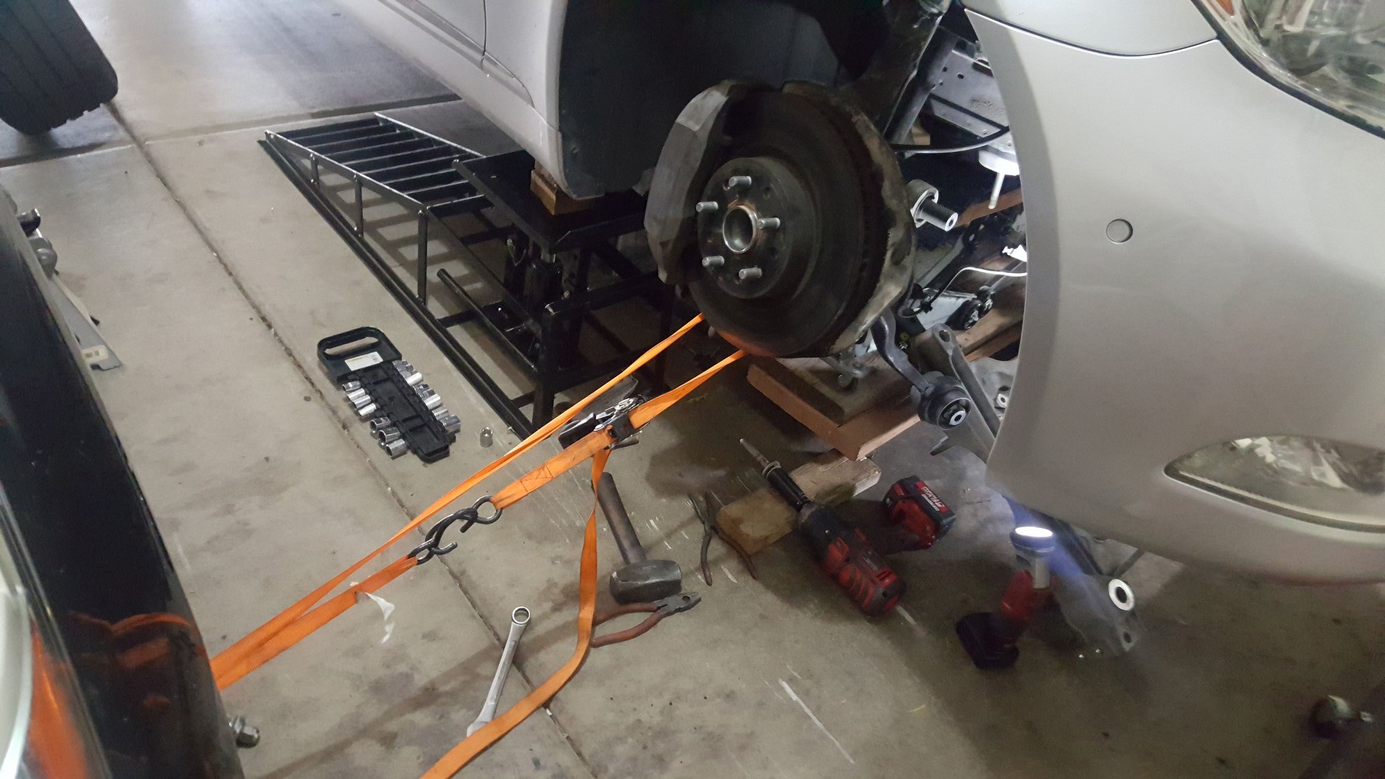

I used ratchet straps to hold the steering knuckle assembly out of the way. right side
I used ratchet straps to hold the steering knuckle assembly out of the way. left side
