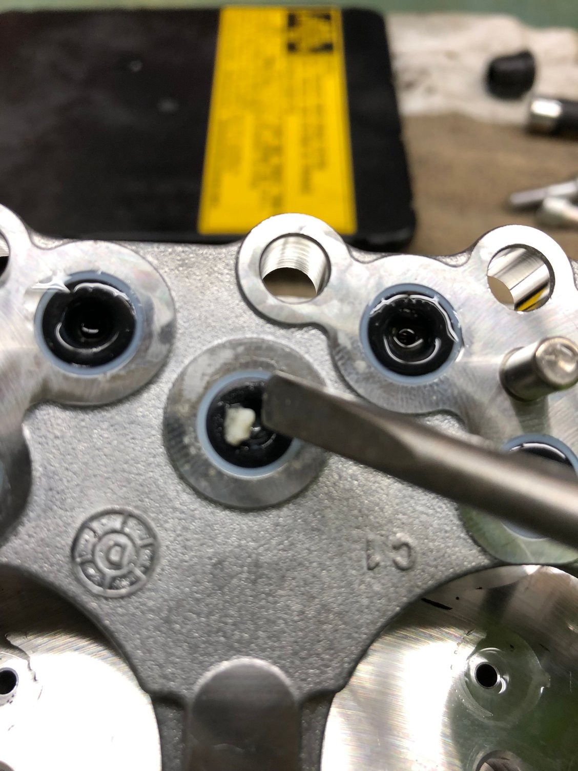

OK, this is what is known at this time concerning my 2007, 460 ABS problem. Took the car into Lexus dealer and had installed a new actuator. cost $2,260. took the old actuator home, took it apart and discovered one of the fluid holes stopped up with some kind of compound like hardened grease.
Pic shows obstruction in one of the 7 holes where fluid is present. Difficult to deny that this should not be there. This pic and more sent to the Lexus dealer. I really dont expect Lexus to acknowledge this finding, but it is what it is. Thanks from Dano3899.

How many miles on your car, and do you know, or think that the brakes have ever been bled prior to this problem? The white substance you found looks to me like it might be water contamination. They say that brake fluid is a desiccant and picks up water over the years; and is the reason they recommend regular fluid flushes. I'm wondering if regular brake flushes are needed to save the system.

Thanks for your reply. This car had 128k when I bought it. Problem came up after 2 days of driving and using the "HOLD" feature at a red light. I can only say the original owner religiously took this vehicle in during the contract maintenance period. One of the reasons I purchased this 1 owner. All I have from the carfax is "brakes checked at 22k mile mark". After that he goes to a different source for service. So what your asking could be a yes, that the brake fluid should be replaced by the manual. These cars are very different than the old master calendar setup. Makes me wonder why I never hear of F's & C's having this problem.
thanks from Dano3899

Hi, Dano3899. I've been busy with holiday travel and other work/family chores and haven't read the forum postings closely for a while. Thank you for sharing your experience in diagnosing code C1391 and solving your brake problem. I consider the brake actuator a non-repairable item mainly because it is a mission-critical brake system component. When I determined a brake actuator was bad, my usual approach was to replace the actuator as a whole. I have not taken apart an actuator and attempted to repair it (although I have taken apart starters and alternators and repaired them by replacing worn parts). So, you are ahead of me in this regard, and I can't offer comment or suggestions if the blocked fluid hole inside the actuator is the cause of the actuator's malfunction. One thing is for sure from my experience: The fluid of the brake system of LS460 (and other Lexus cars) needs to be replaced per the service schedule and per Lexus service procedure, in order to maintain proper braking function. I've seen sticky and noisy brake caliber pistons and other abnormal brake behaviors due to old brake fluid and were easily fixed by properly replacing the brake fluid per Lexus service procedure.
