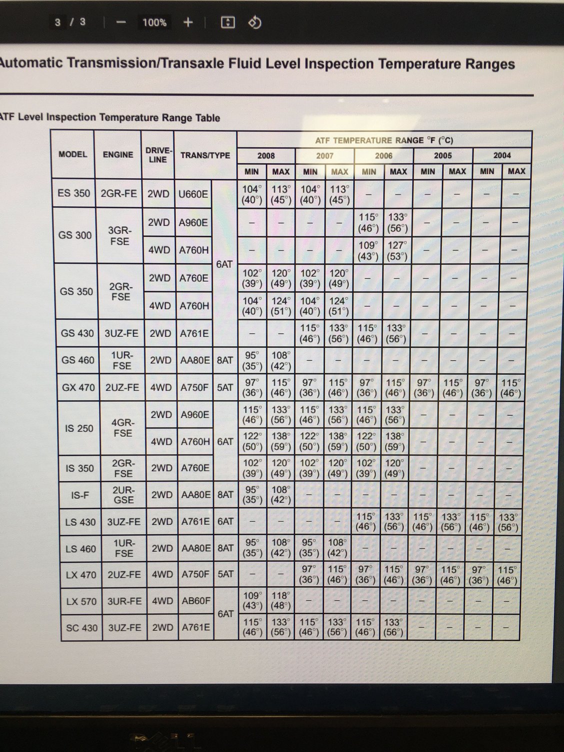

I thought the main difference between the AA80E and the AA80F would be the awd portion, the gearing is almost identical but the ecu is different I suppose.
The ISF is on the left,
Old Jul 17, 2022 | 06:09 PM
Posts: 17,926
Likes: 1,702
Hold on, I think I can find this
I would say unless the trans has altered part numbers or design in 13+ just use the 07 spec since it's the same unit. The F cars have different setups that I am willing to bet are accommodating the coolers that likely have thermostats and track use to ensure the fluid levels do not get too high and start dragging on the drum bodies and frothing the fluids, that or a simple difference in pan setups. If you have even a basic modern scan tool you can do the flashing light test mode and then see what range the tool says it is, this shouldn't be that hard to figure out if someone has hands on a 13+

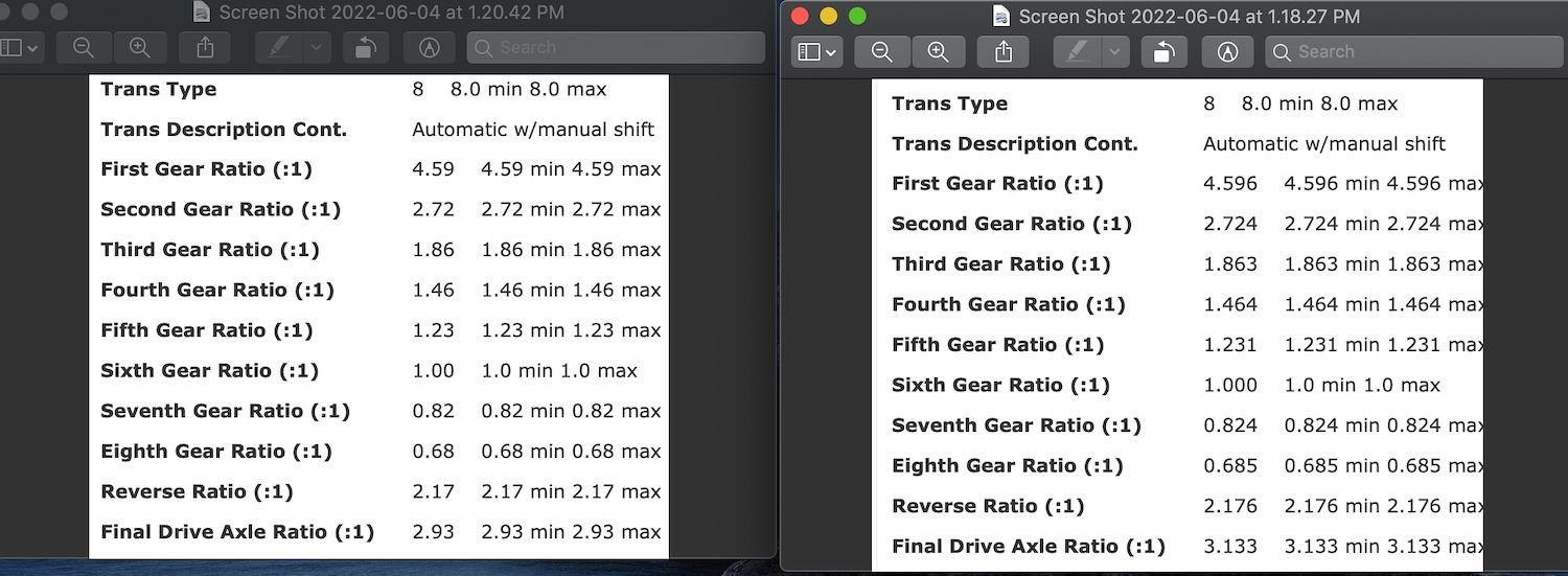

This is what's in the book. There is something different about the 2013 model, because the New Car Features does not repeat from year to year unless there is a change. There is a whole new section on the AA80E and AA80F for 2013.
IS F ratios:
2008 IS F
2007 LS460
2013 LS460 AA80E
LS460 AA80F
Looks to me like the internals are mechanically identical, but there may be many other differences. The IS F has an elaborate breathing system not found on the early model LS460s to prevent ATF from sloshing out under high G loads. Pretty sure RC F and GS F are similar if not identical.
IS F ratios:
2008 IS F
2007 LS460
2013 LS460 AA80E
LS460 AA80F

I did the temperature test with the jumper today, thanks Boykie... didn't use the third pin to disable the suspension because I was on the floor and not raised.
It didn't take longer that 10 minutes idling before the indicator light(D) came on to let you know it was at temp. I connected techstream and the trans oil temp was 97.2 F, it only took a few minutes before it was at 100 F so you'd have to move fast if you had to add more fluid before it got to max temp.
It looks like it's similar to the chart of the 2008 460 AA80E that Striker posted.
