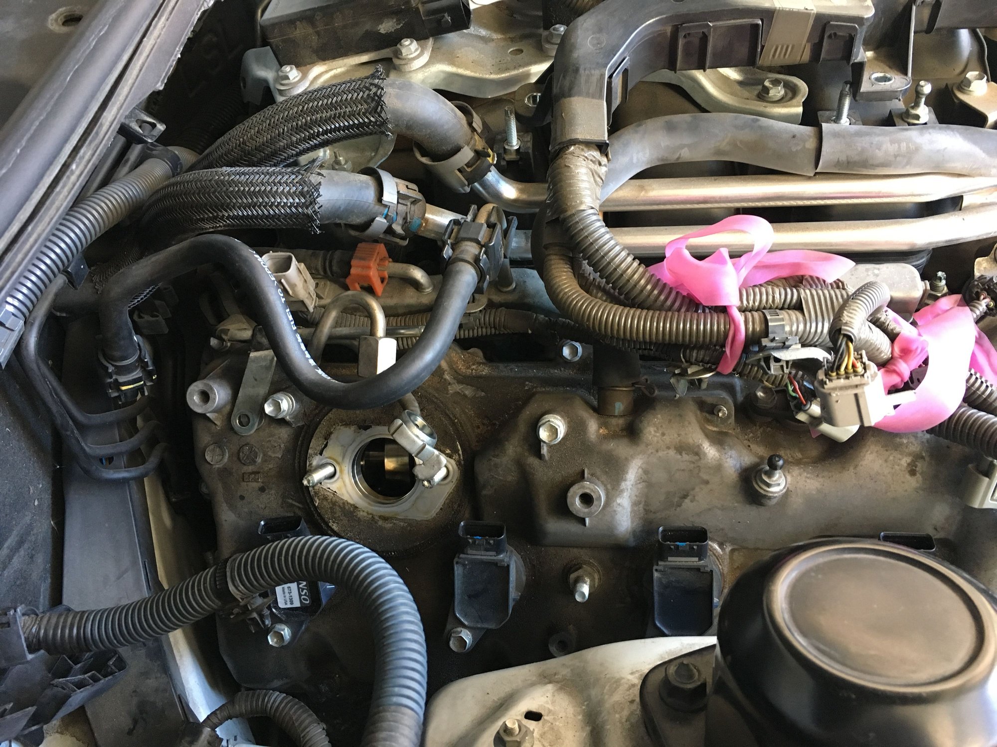

Replacing the valve cover gaskets, spark plug tube seals and fuel pump gaskets. If anyone needs help or has questions, fire away and I’ll do my best to answer!

Nice work though! Looks like you got those high pressure pumps off without any issues.

Currently 125k miles - car started misfiring and went into limp mode because cylinder 3 had oil in the spark plug - spark plug tube seals were leaking so decided to do this all at once since you have to take the fuel pump/valve covers to get to it.
So far so good, no problems. I discharged the fuel pressure and let the car sit for a good 5 days (had to work) before I took out the pumps so no issues as far as fuel pressure in the lines. I'm waiting on some gaskets before taking off the valve covers. I can't find the torque specs for the valve cover bolts but it looks to be between 60 and 70 in lbs.

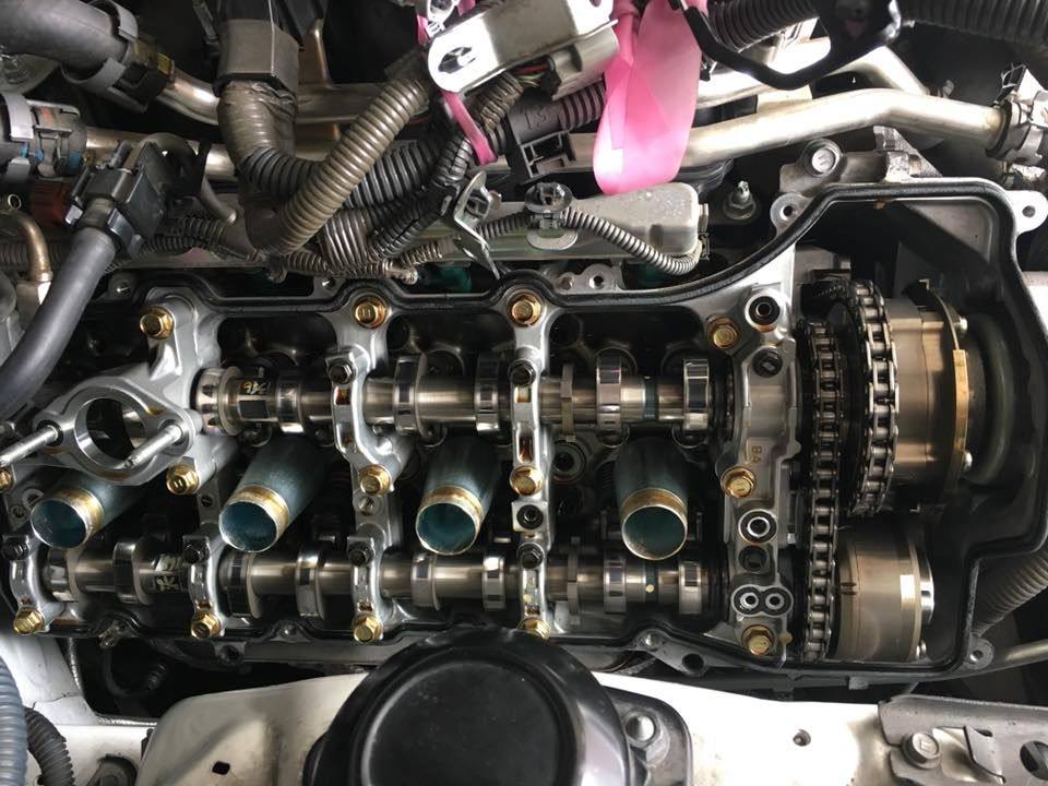

Finally had a day off to finish this up. Passenger side valve cover removed.

Wow look under that valve cover, it looks like it has some sort of oil spray nozzle system for the cams. Interesting.
