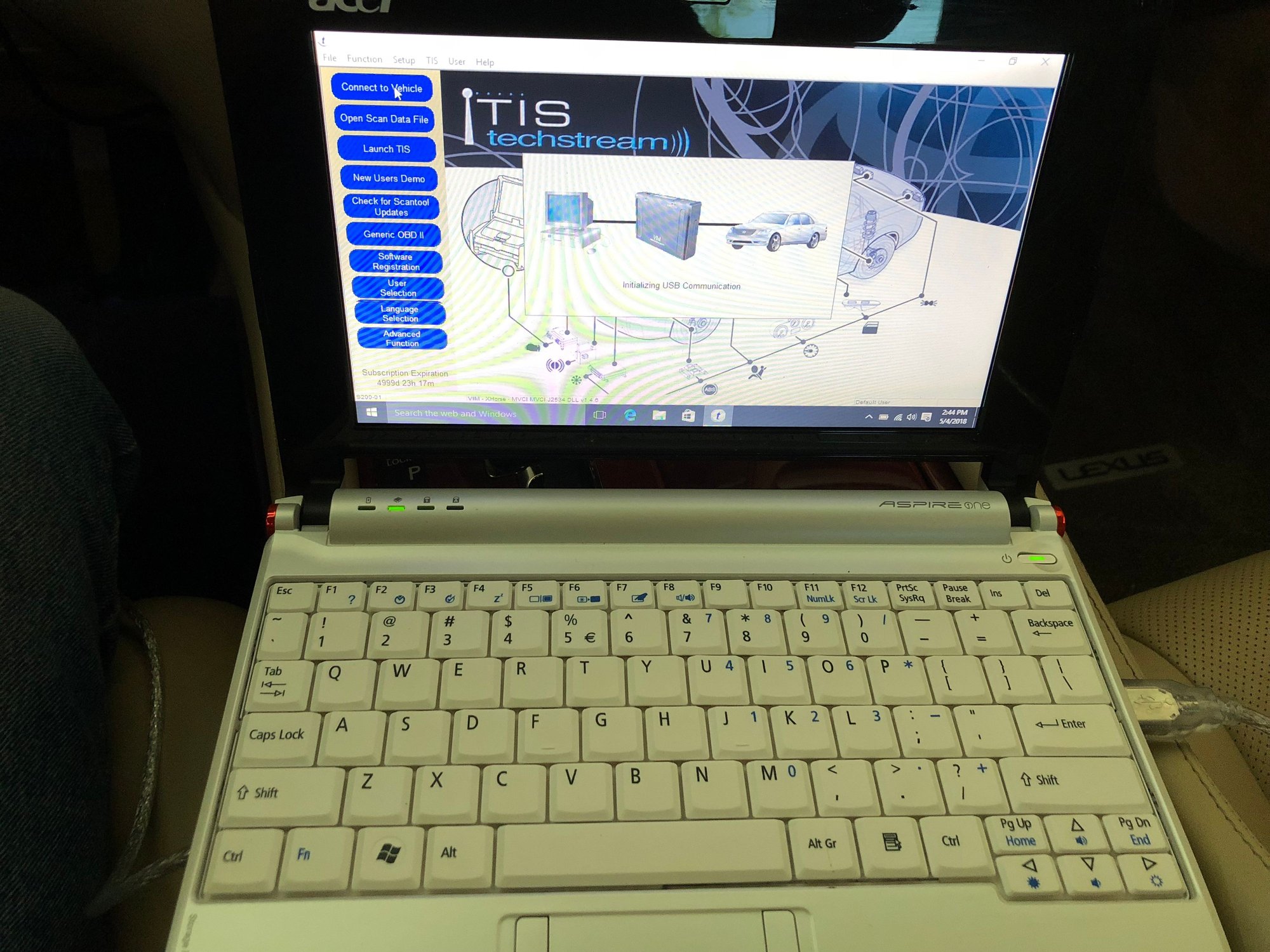

Bought this on Ebay. Got it running on a old Acer Aspire One. You know the mini laptops. I was not using it and put Windows 10 32bit.
I installed TIS followed all the notes. Its Version 13.00.022
I am not sure seems like some options are missing. Anyone else running this version??

I reinstalled it on a regular laptop. Will try it again. What i don’t see after you connect to your vehicle is the options to do a health check or customize settings.

It showed up after i put it on a regular laptop. I am guessing the screen size made the difference.

Big warning here. When I started on my Techstream journey, I started on a HP Netbook with a SSD to get a little performance out of a worthless min-laptop. With Windows 7, it cut off things from the bottom of the screen and could not click on it. It was a tab around then enter thing.
Get a full laptop... I even have one of those Dells that was on the first posts... works perfect, drop a cheap SSD to get performance on it.
