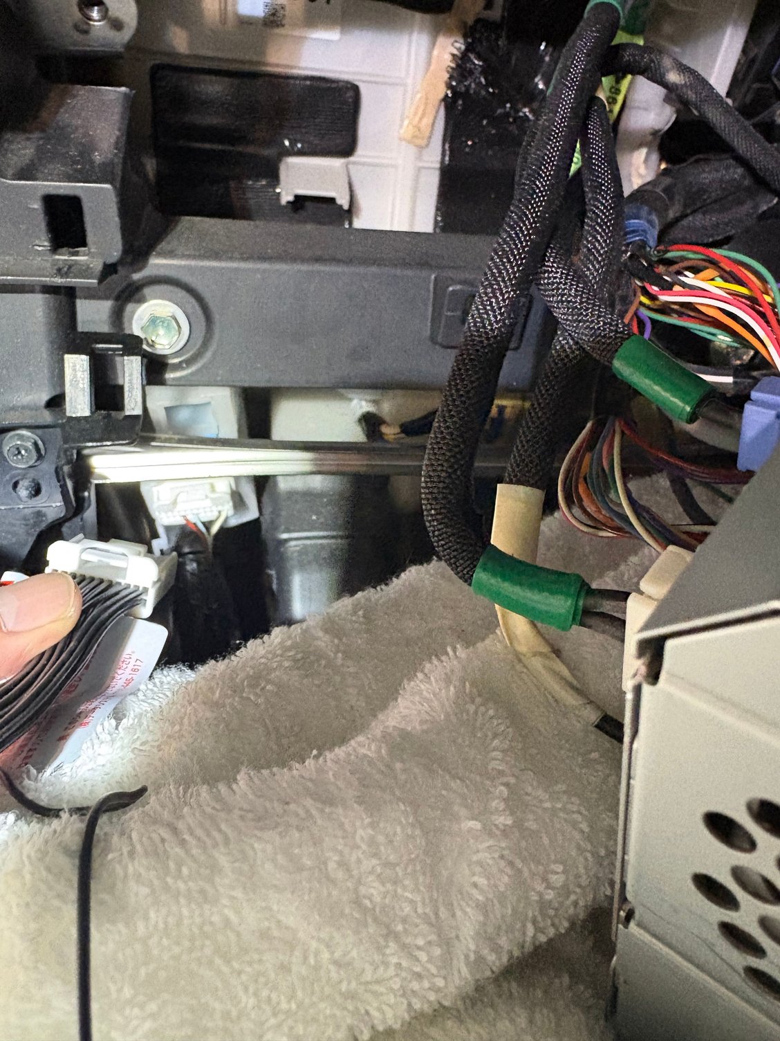

From: HI
Many helpful folks on this topic. Thank you for this thread.
it’s already been mentioned but confirming that h-087i and asc680 worked perfect for my 2013 fsport.
I will say though the speed wire harness IS NOT behind the radio in this case. It’s right near the shifter on the bottom left in the pic.
