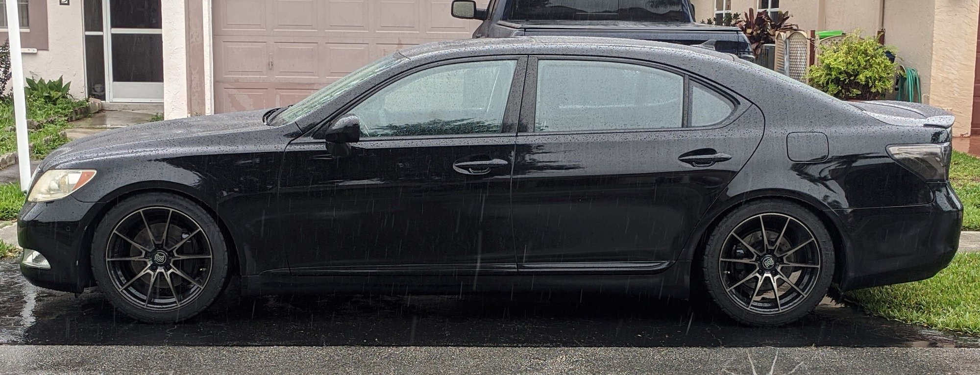

Default Safe ride hight for a AWD ls600hl
Is it safe to drive around with the data system on 5 all round. the car is AWD
as I like the look of it just on the tyres
just don’t want to damage axles
This one’s a bit lower
That's a Beautiful LS! That's what a black car should look like! Nice job!
Old Jan 15, 2022 | 11:15 AM
  #278
Way's Avatar
Way
Joined: Jan 2022
Posts: 2
From: Manawatu
cheers thank you

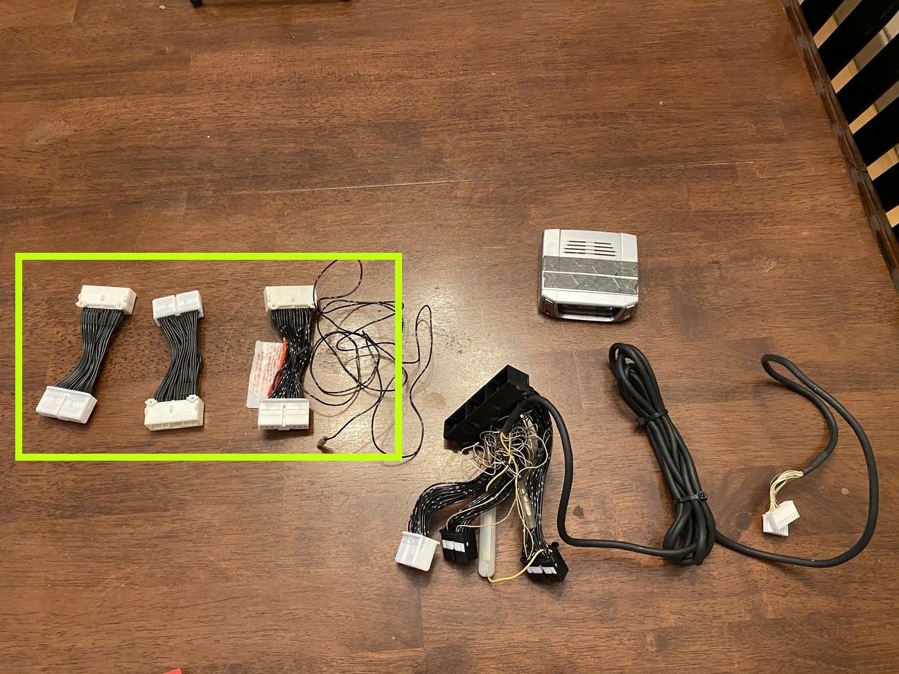

Originally Posted by qcvc
Hey I am in the exact same situation you were in and had a question. So the harness I ordered came exactly as pictured on your eBay link. With a single harness, 2 white ports into the controller, then 3 male connectors 2 black 1 white, connected to a 3 female connector bar. Im looking to get a better understanding of it before installation, but does this mean that it has the speed cable with it? Or do I need to order that and if so, how do I get it to connect to my asc controller? Sorry long question but thanks in advance and clean car! I have the same in silver.
From what you described, you have the controller and the main harness for it that connects to the suspension ECU withn the side panel, below the glovebox. That connection is the easy part, however, connecting the inline speed harness is more involved and tedious, as it requires removal of the nav unit. Did you buy the controller and main cable new or used?
The H-087G should have included the main cable and the speed harness as shown here and the pics below. https://www.croooober.com/en/item/cp...ion-Controller

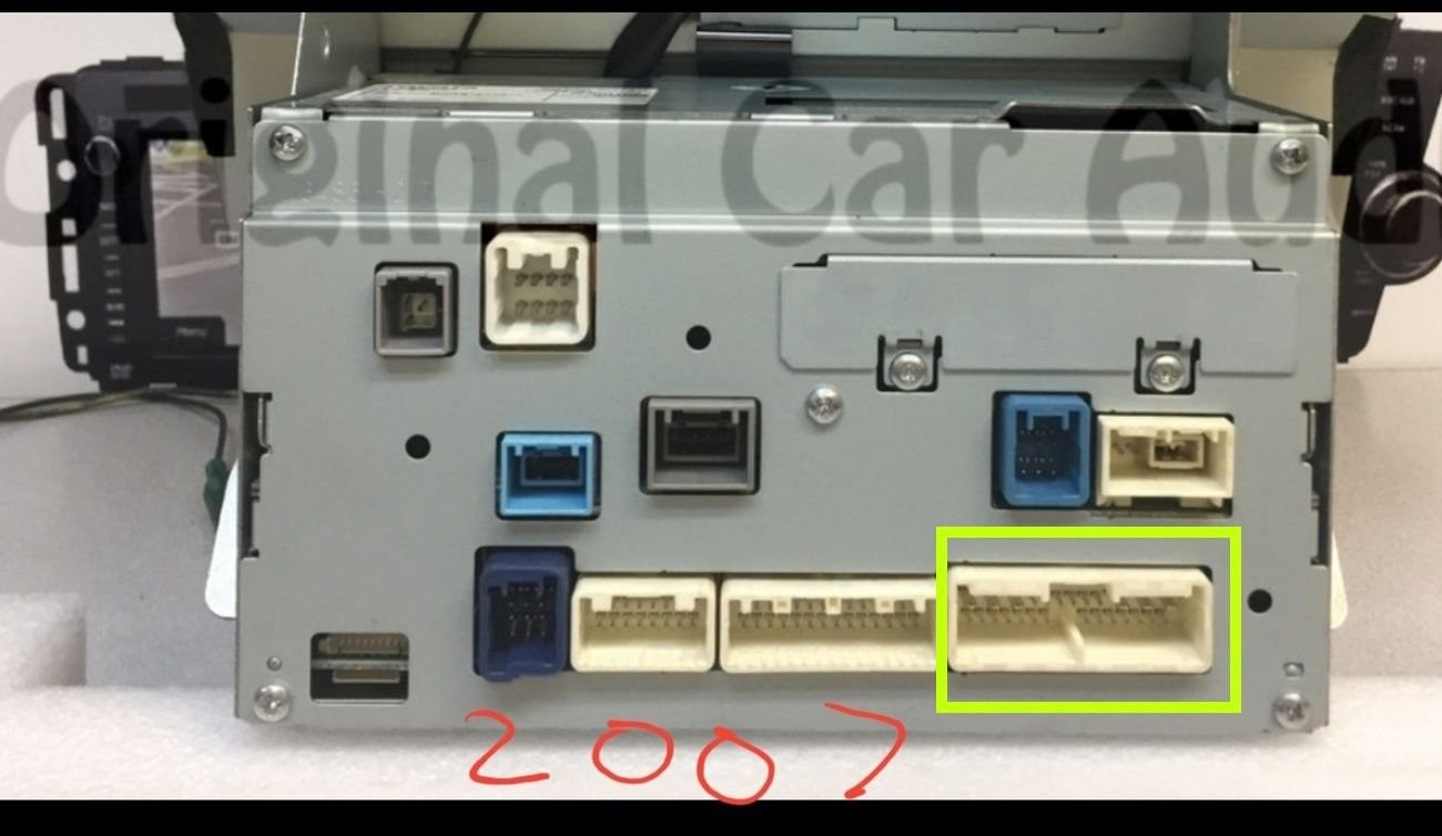

Thanks for the pictures, it makes sense now. I bought mine used and so that explains why I am missing the separate speed cable. I'll see if I can look for just the speed cable by itself instead. But to attach it to the harness, would I just plug in both ends then connect the single wire to the other solo wire on the main harness with the small clear connector?
Yeah, a lot of the harness stock photos don't show the speed harness, but it's supposed to be included when bought new. Yes exactly as you said, speed harness will go in between nav unit and OEM plug and run single wire to main harness plug lead. Recommend these threads too: Step-by-Step: Data System, Air Suspension Lowering System Install LS460 DIY How-To - ClubLexus - Lexus Forum Discussion
DataSystems Air Suspension Controller info thread - Page 14 - ClubLexus - Lexus Forum Discussion
If I remember correctly, this is where the speed harness goes:
