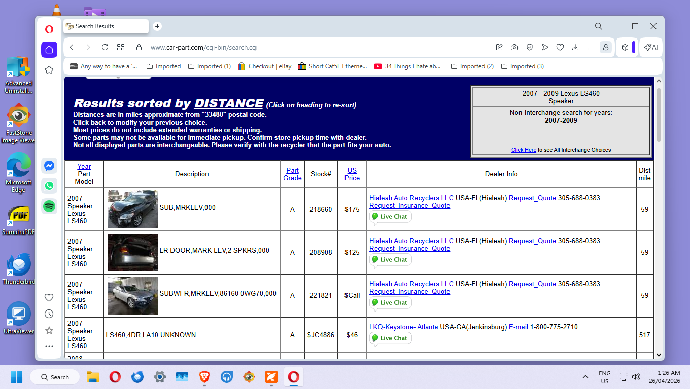

Have you considered purchasing some used speakers, and then having your local audio shop install them?
Here is a link to a list of what I found potentially available through "Car-Part.com"
It is not possible to narrow it down to just "Mark Levinson" spec., but I entered a wider ranging criteria.
https://www.car-part.com
The original extensive search list that I posted does not last long on this forum for some exasperating reason.
If you need help doing a fresh search I am happy to help out.
Not being overly familiar with Florida geography I used Mar-a-Lago 33480 for the ZIP code.
I don't know if you live near there, or who else might live there LOL, but it was good enough to generate a comprehensive list.
IMO, it is advantageous for members to insert a general location in their User CP/Signature, as you have, to help searches done by other members.
Without it, I would have had to guess and placed you in South Dakota for example, making the search less meaningful.
Ha ha! Thanks for thinking I was near Mari-Lago!
My shop recommended against getting any used speakers, as that solution is only temporary and the same issues may return shortly (and I sort of agree.) If I am going to spend the money, I want something that will last my ownership of the car, and never have to worry about again.
Thank you for the above research - it's been tough trying to look up what will fit my car (turns out - NOTHING except for the Mark Levinson's) except for new speakers with modifications for fit.
I guess in the long run, I will enjoy the car more with the money I have to outlay to get new speakers (with the backing of my local shop.)
