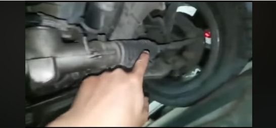

The first thing I checked, just to rule out the rack itself, was the rack boots on both sides. These rubber boots protect the internal parts of the rack from water, dirt, and contamination. If the boots are completely intact, with no cracks, leaks, or tears, that is a strong sign that water probably did not enter the rack from the ends. This is important because it makes you suspect the electrical side more than the mechanical side.
Rack Boots
Rack Boots

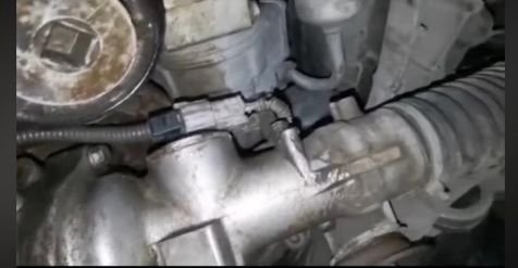

After that, I cleaned the three connectors on the steering rack itself.
These connectors carry electrical signals and power between the EPS computer, the steering motor, and the sensors inside the system. If moisture gets into them, the EPS system may detect a fault and store a code such as C1555.
first rack connecter
Second rack Connector
Third Rack Connector
Based on experience, it seems that one specific connector tends to get dirtier than the others, possibly because of its location, which makes it more exposed to moisture and dirt. That particular connector deserves extra attention during cleaning and inspection.
specific connector
specific connector
Based on other people’s experiences, some of them, after cleaning and drying the connectors, add extra protection to reduce the chance of water getting in again, such as electrical tape or spraying a suitable protective coating around the area. But the most important thing first is proper cleaning and complete drying.
