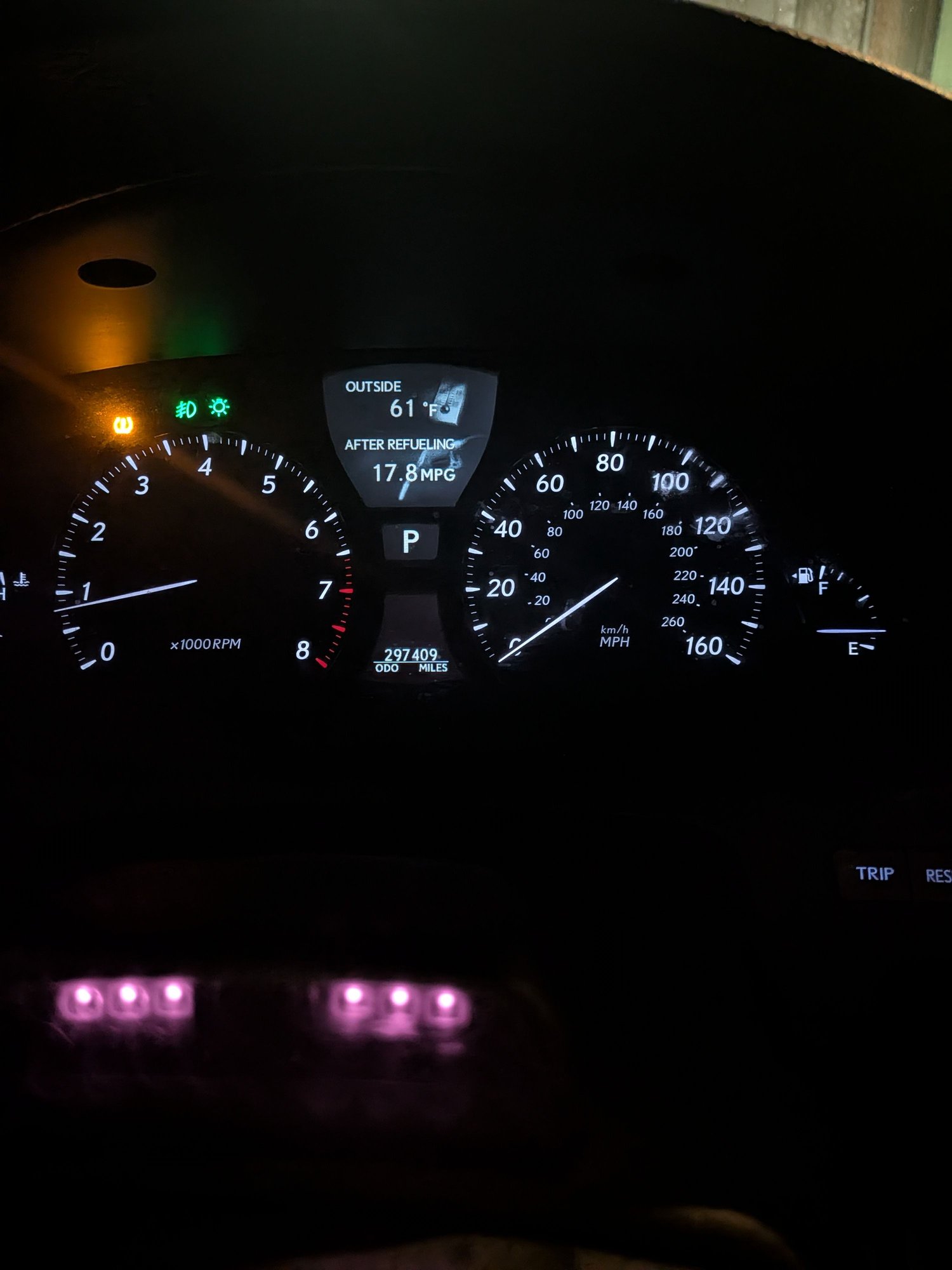

I have a 12 AWD L with all options except executive seating including air shocks and ACC with self parking, about 100k new.
297k miles, bought at 230k miles. Still have original rear shocks with fronts having more than 200k miles
Have only done basic maintenance, treating like a Corolla.
The suspension bushings are shot and dampers gone on rear shocks is still holding air and tracking well with even tire wear.
So basically I'm driving a 100k car for the price of Corolla that still drives better than a Corolla even with above deffered maintenance. No complaints!
