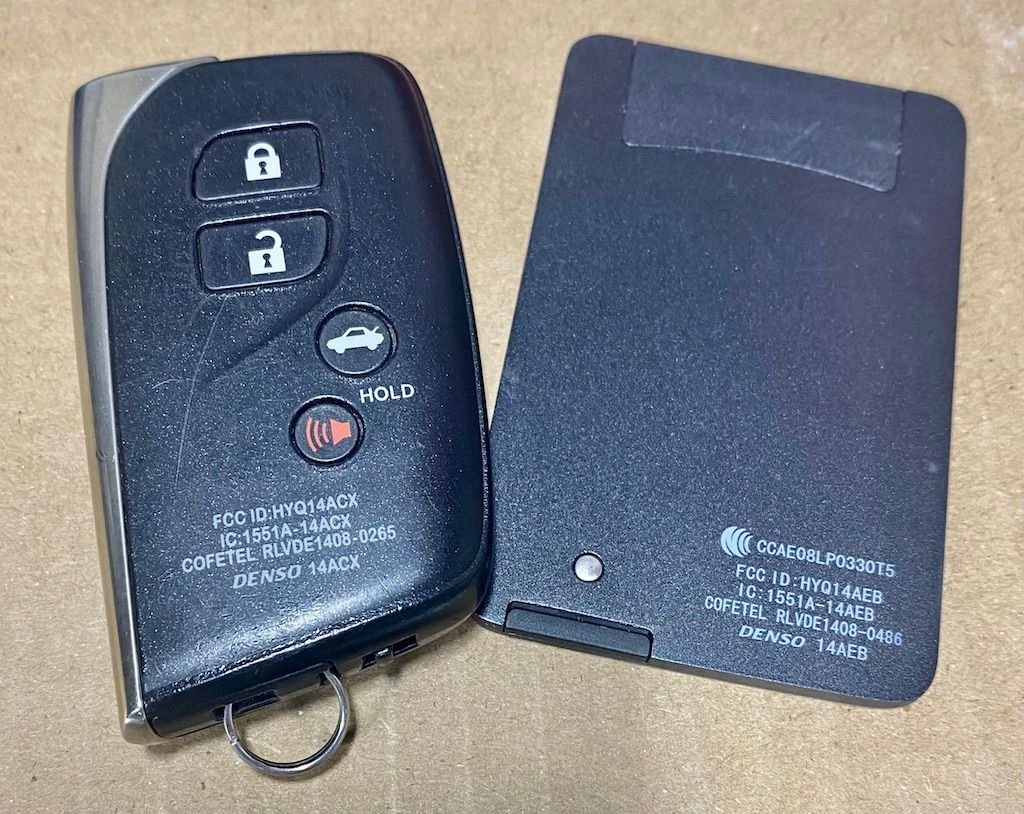

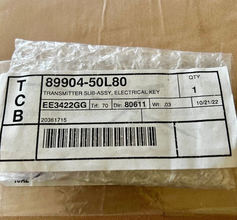

Ebay would be a gamble imo, this is the part# for the card key I bought for my Canadian 2013. The numbers on my fob do not match the numbers on the card key.

that's right, i bought the card key about 3 yrs ago from an online dealer and programmed it myself. People seem to be pretty concerned about having at least the fcc number being the same but I don't think that's necessary, the new or virginized key to be programmed probably gets the seed/info from the immobilizer and pairs with the master key fob....I have no proof or this it just makes more sense to me than having buckets of different card keys to work on every model that has the option available.

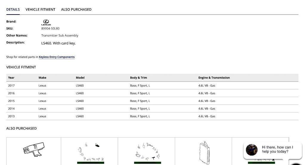

This is from mlparts, I'm not saying this is the only one for your car but you could ask any dealer and see.
